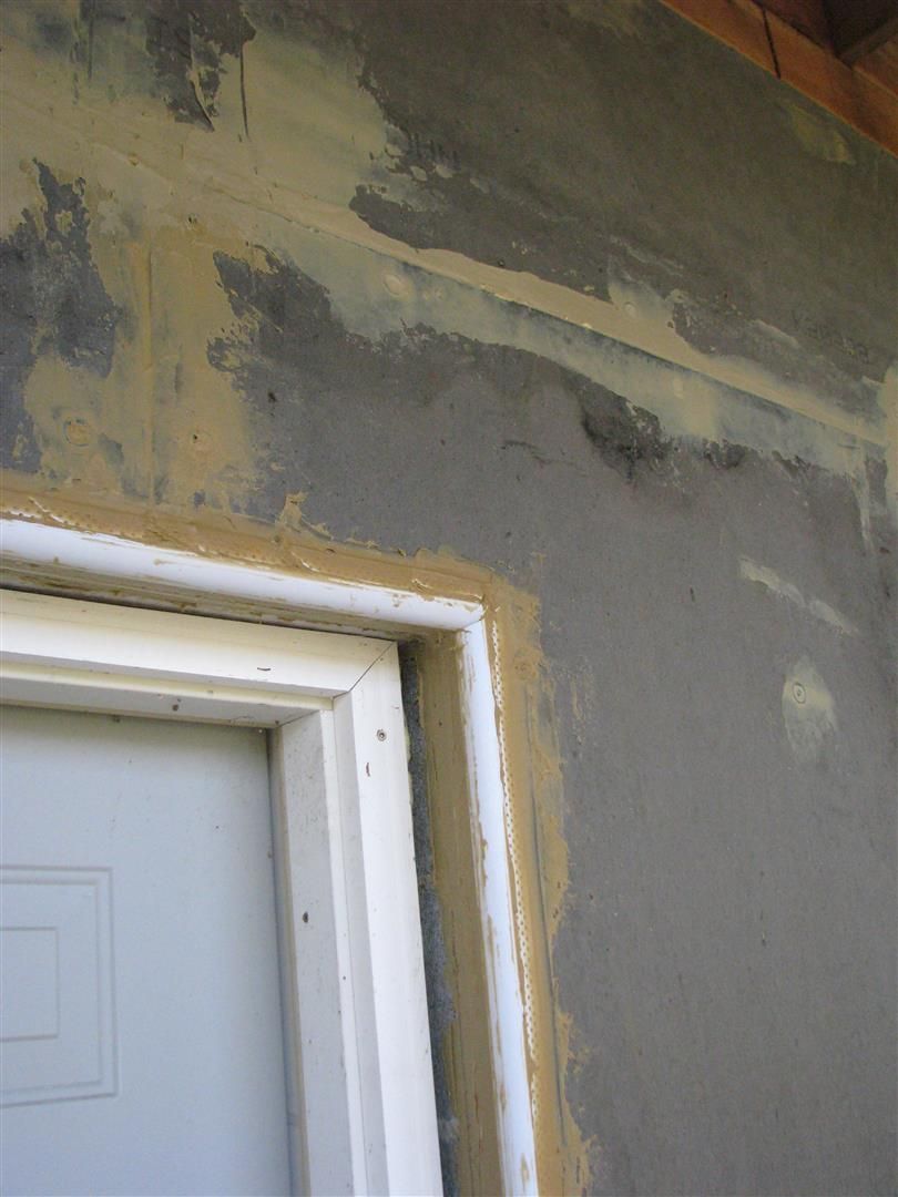

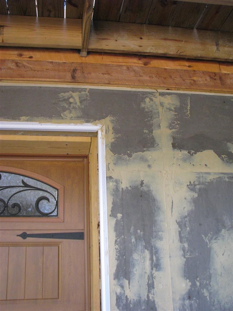

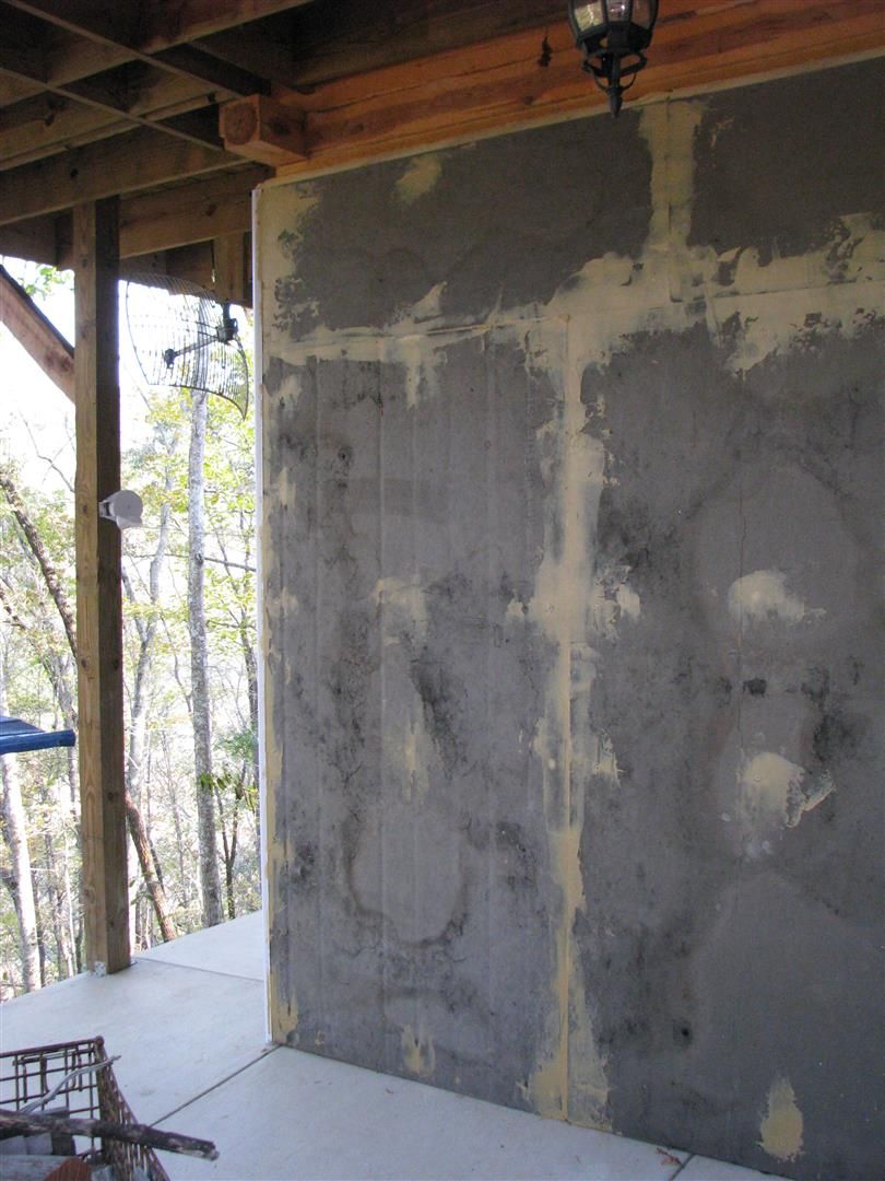

Ok, progress on the basement insulation. It's all up and "mudded" with Liquid Nails....I did all the seams just like drywall mud. I put the plastic rounded corners on everything, then feathered them in with the liquid nails. I then borrowed a drywall sprayer/hopper and put Drylock basement paint in it, set it on the largest setting and sprayed a heavy texture on the walls.
All mudded:
I cut the top at a 45 degree bevel so once sealed off, water can't run down behind it from big wind/rain storms:
