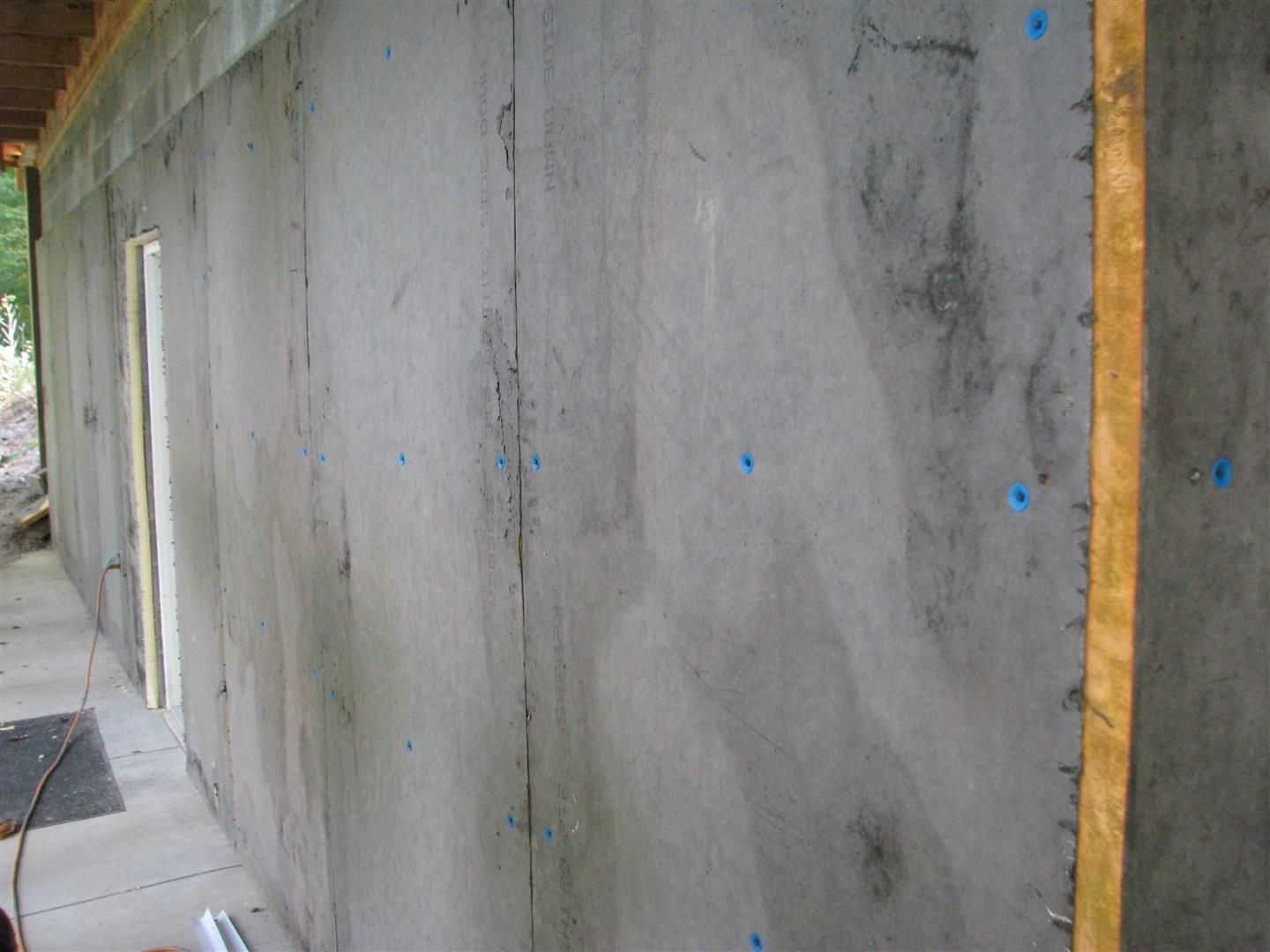

This one had me by the tail. Now I am working on insulating the exterior of the two exposed basement walls...photo's enroute.

This is the 2' High density foam I used on the porch roofs:
Using Tapcon's & plastic washers to attach it to the basement block walls:
Initially I was going with stucco, but I think I will fill all the seams with Liquid nails, then use waterproof basement paint in a texture finish directly to the foam boards. After that I will paint it with a colored elastomeric paint....a clay pot color I think.

It's all up. I will be filling in the seams with liquid nails, then the first coat of basement paint will go on.
