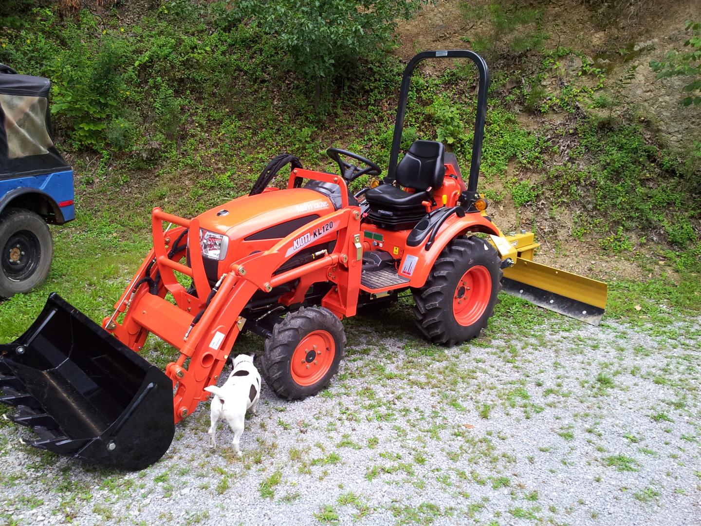

Your right...if I can get some more stickered and stacked. I have to rat you out Mike.....HE HAS A BRAND NEW KIOTI but no posts or pictures yet:anyone:

AHHH, I can throw Mike further under the bus...loook at what I found in a email:
Stubby little beast isin't it? And I see Bullet is "breaking in the tires" properly:laughing:

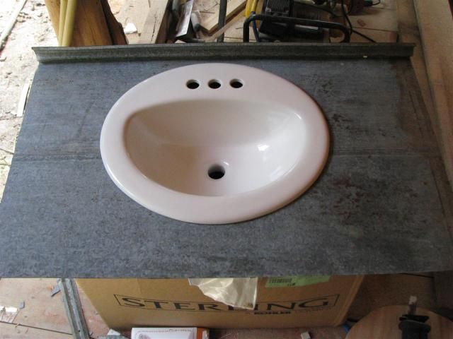

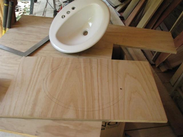

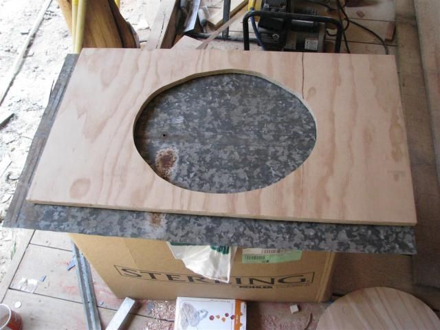

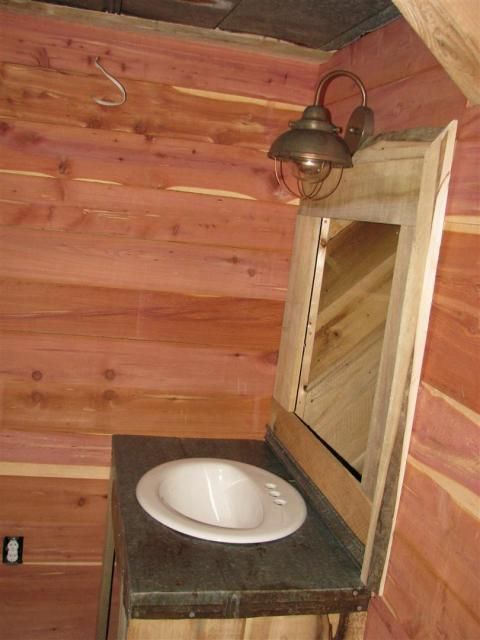

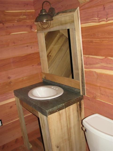

Ok, I worked on the Loft Bath. I set the head, and built a Vanity. I bought a chepo porcelain sink for under $30 and kinda stood around thinking about what to make the top out of....then it hit me....BARN TIN. So I marked and cut a piece of 3/4 ply:
Then a section of "Z" tin:
Ready for fitment in the bathroom:
   / The Log house Project begins........
#1,437
I made it over-sized so I have a couple of inches to bend down and nail with galvanized roofing nails:

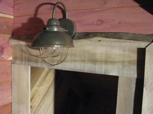

Then I added the last Cabela's ships lamps(this one is copper):
The only thing left is a framed mirror on a hinge to access the storage area behind the vanity:

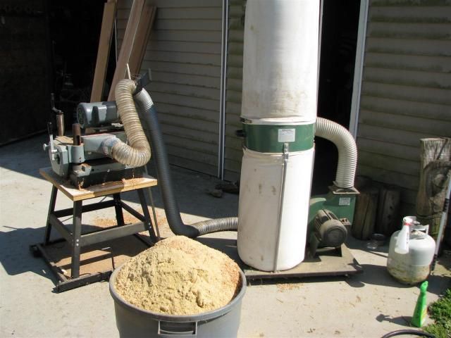

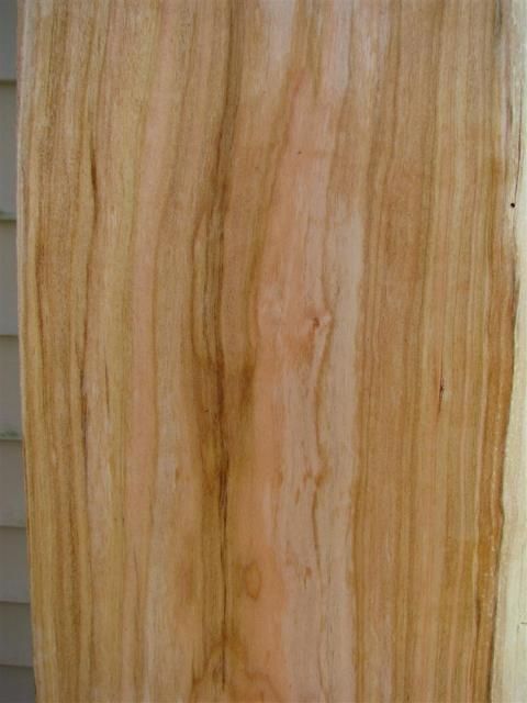

I took the Cherry out of the Kiln and started planing it down. 6 years ago I bought an old Delta 13" planer just for this project:
And a HF dust collector:
I made 150 gallons of sawdust in just a couple of hours and the wood looks great:
I also picked up another 1,000 bf of Polpar and I am re-loading the kiln today with it. Kitchen cabinet bases get built today.
