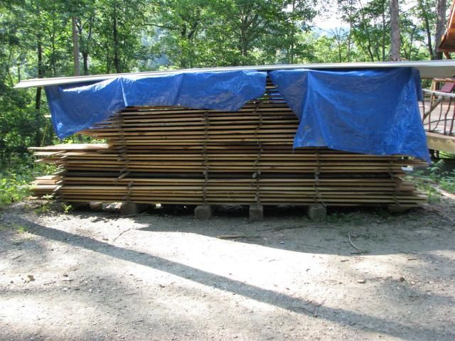

Here is a pic of the 1,000bf or 4/4 Poplar "Culls" I picked up from the sawmill for $135:
It took some time to sticker and stack, but it's the best bundle I have bought so far...all really nice boards.

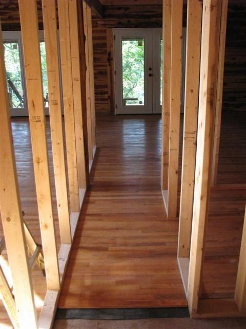

Framed out hallway from Master bath to Bedroom:

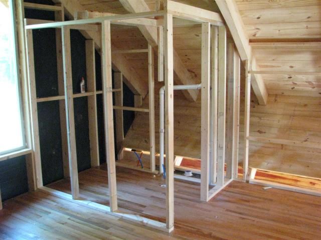

Loft bathroom frame out:

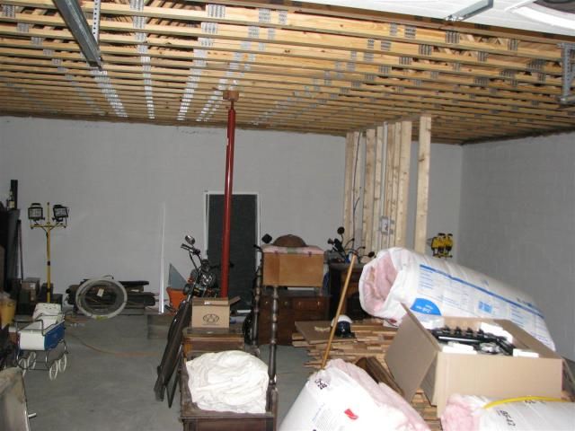

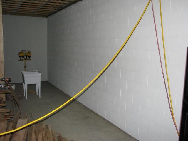

Loft knee wall framed out(there will be storage in that "V" area along the entire length):
Basement walls(my basement should be empty right???):
But noooo, it looks like this:
   / The Log house Project begins........
#1,276
And this:
And the new fridge(yes it's plugged in and yes it has a case of Miller in it:thumbsup:)
