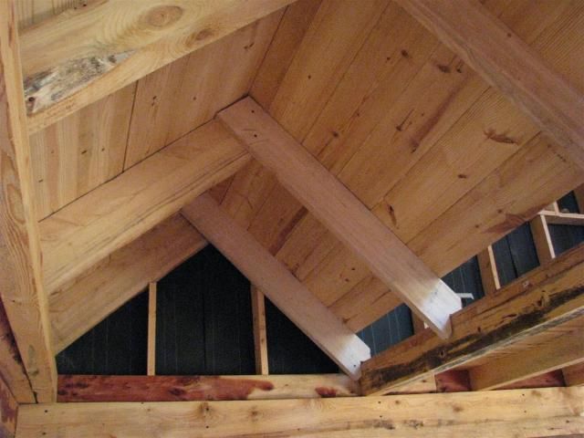

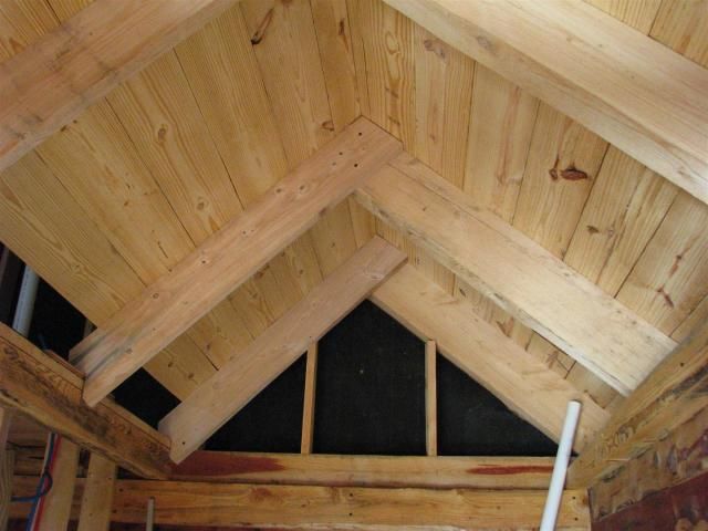

Then I decked the ceiling with 2x10's:
Now I can build stud walls up in the loft tomorrow.

What kind of wood did you use for the ceiling rafters and ceiling decking? Did you mill it yourself?
Obed
   / The Log house Project begins........
#1,253
The rafters are Hemlock milled by me, the decking is SYP and store bought(same decking I put on the rest of the house).

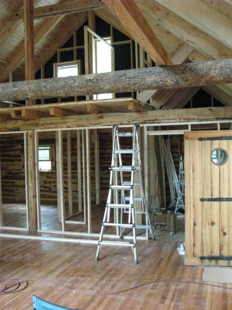

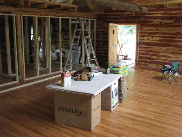

Some shots of interior walls:
The stuff in the middle of the great room is the two toilets( I got the ones that will flush a bucket of golf balls...(Arrrruuuuruuuu....ruuuuhhhh...rooooahhhaa), concrete board, natural slate tiles, grout and thinset for the master bath.

Is that one of those do-it-all ladders they advertise on TV?
What brand is it and do you really find it as great and stable as advertised?

Pacer, yes that's a 22' Gorilla ladder made by Werner which is a little Giant copy:
22 ft. Aluminum Telescoping Multi-position Ladder 300 Lbs. Load Capacity ( Type IA Duty Rating )-MT-22 at The Home Depot
I also have the 13' one and I love them. They are a wee bit heavier than a regular telescoping ladder, but way more versatile and yes very stable. I have never split them apart and used them for scaffolding yet but it would only take about 3 min to do so. These are over 5 years old and I will never buy any other type of ladder. Initially I wanted a Little Giant, but the price is so dang high and the Werners are half their price...so Werner it is.
