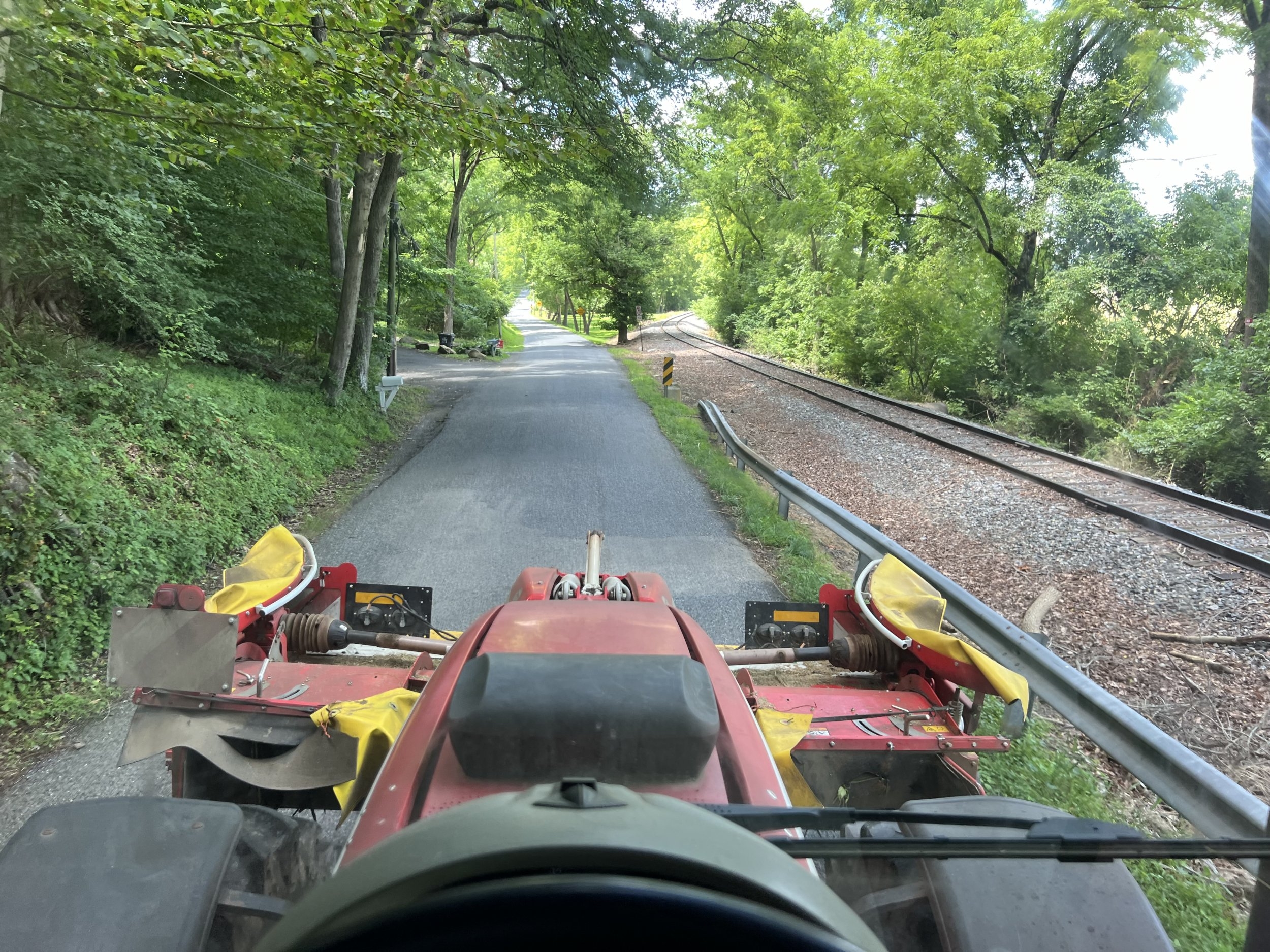

Here’s some scenes from today.
It’s been so dry, the radiators are clogging up with hay chaff. Spent a few hours flooding the radiators until they were flowing clean.

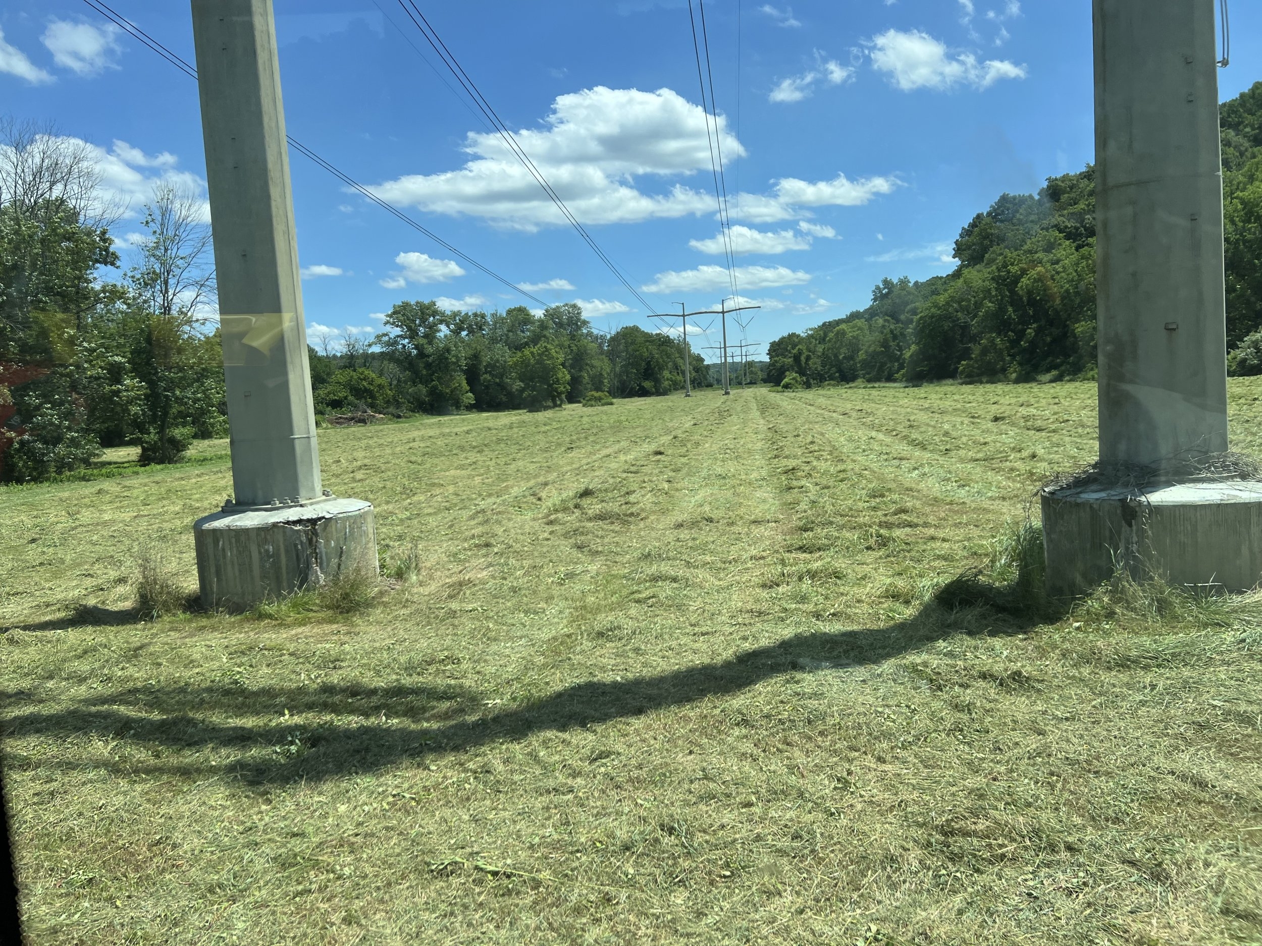

Headed over to cut some pretty rough flood plain that actually makes some nice hay. This is Reeds Canary grass.
Here we are after a few swipes

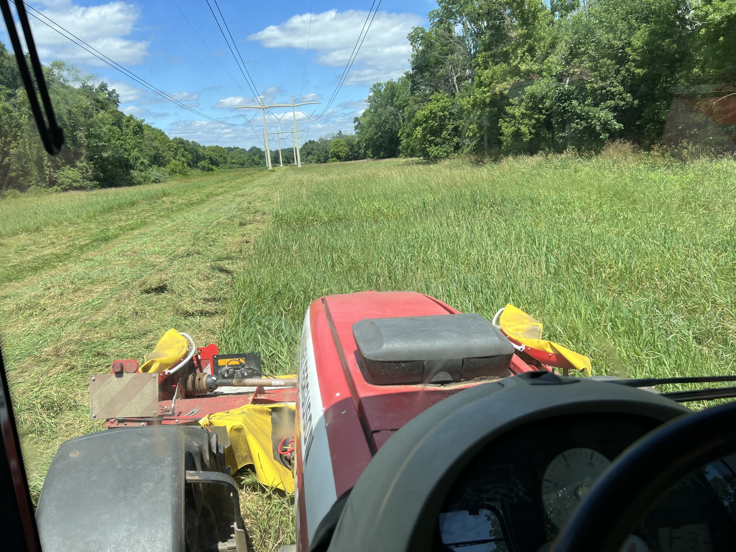

Heres a look at the 302 on the side
Even with lots of poles, I was able to get this little 15 acre field cut in a little over an hour.
When we exit the field, we have to cross over East Penn’s RR tracks
Down the road and back to the shop
Back at the farm & parked for the day

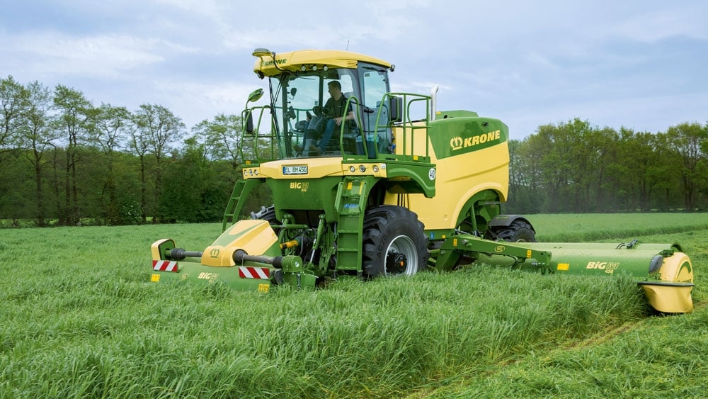

The Discbine style of mowers can handle quite high speeds they are often advertised as being capable of mowing and conditioning hay at 10 mph. The larger frame 4wd tractors with good sized tires can handle 6 to 8 mph in most hay fields and in a real smooth one 10 mph is doable but the same hp tractor in a 2wd model with the much smaller front tires is often too rough. Between the tall tires and the air suspension seats the ride can be quite comfortable , the head lands are often rougher and merit slowing down for.
Fields that I have mowed at 6-8 mph in an IH Magnum, I can only do 4-6 mph with a tedder or rake in a smaller tractor such as my Branson 8050.
Then a couple of places around here have the Krone Big M mowers with 30+ ft of swath width and 400-500+ hp, these things are flying down fields at 10+ mph. And a price tag of half a million dollars.
