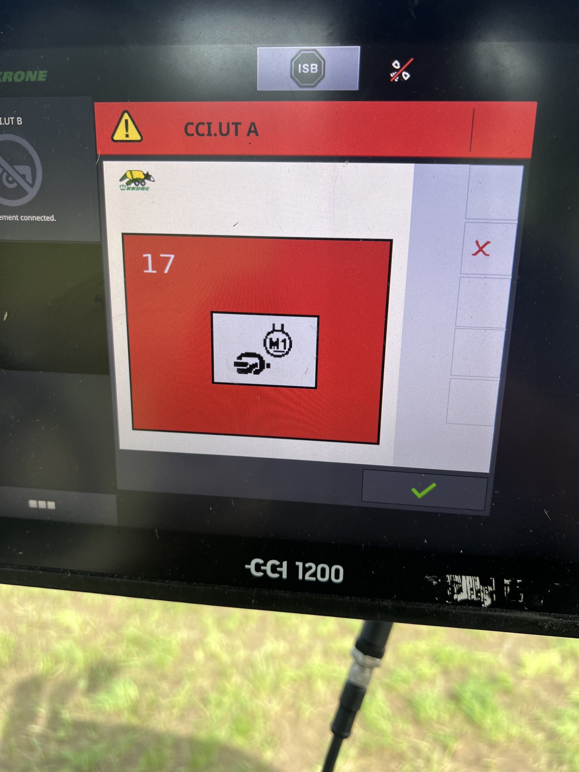

Here‘s a baler code you’d rather not see on your monitor. Knotter motor fault. Luckily I was able to get it working.
Once I got going again, mostly a smooth afternoon. Although knotter #6 broke its’ twine and I had to re-thread the twine back to the knotter.

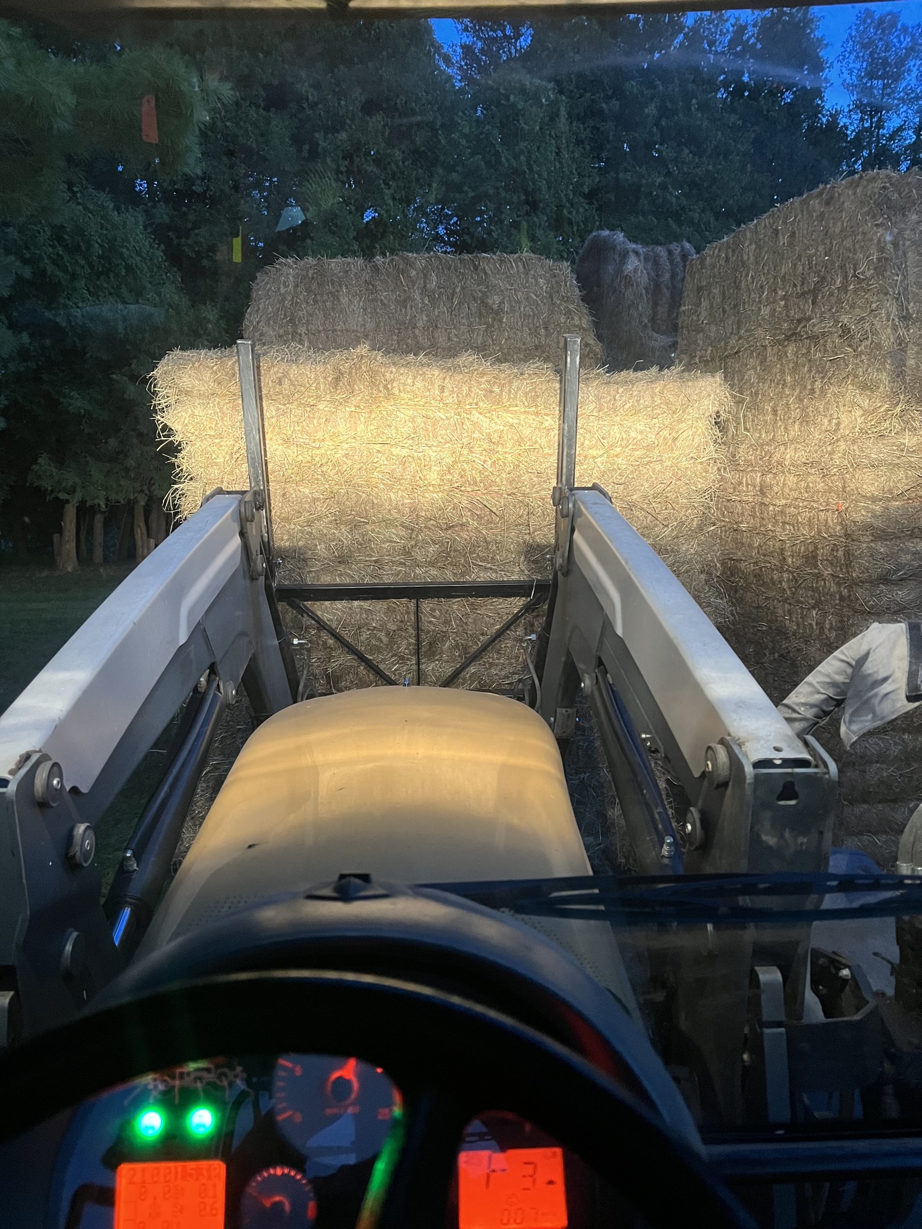

Here I am stacking bales at dusk.

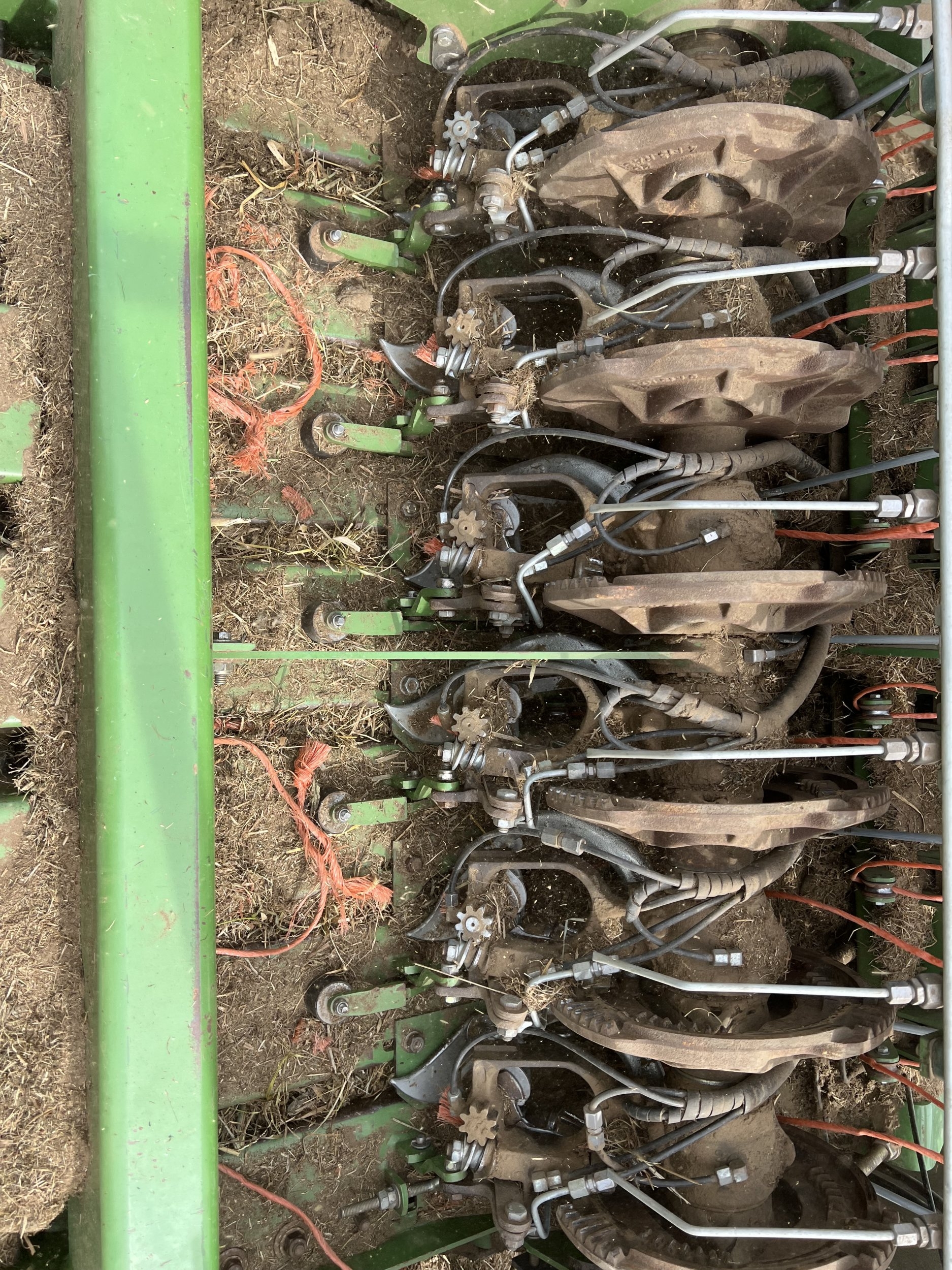

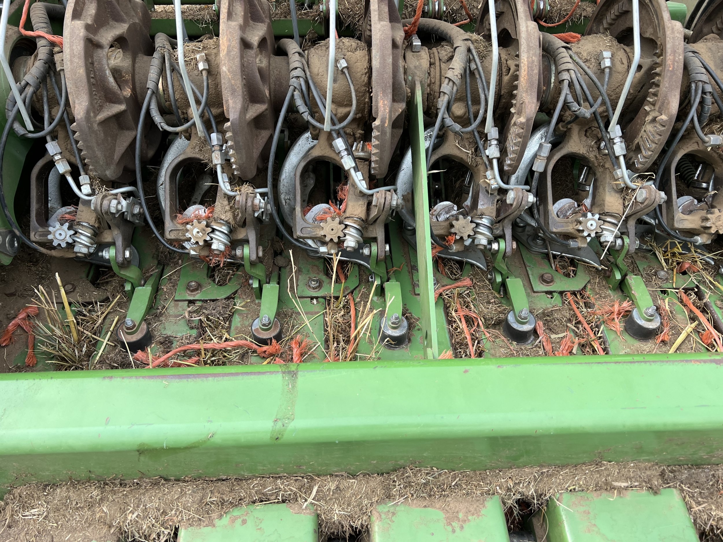

About 12 I headed up to our current customers site and began raking for about 2 hours. By 2 I was ready to bale. Made a few bales, then got an error code. All 6 bale strings broke on the tie cycle. This has NEVER happened to me with this baler. Usually this means the bar that controls all the twine fingers has broken or twisted.
Here you can see the twine fingers are not all aligned the same direction Under the knotters. They all need to be in alignment.
I tried to do a couple manual tie cycles and see if it would clear and watch the twine fingers at the same time. They were jammed. I spent the next 2 hours of precious afternoon sun messing with it. Each time it mis-tied, I had to manually thread the top 6 knotters and bottom 6 needles. I took out a pry bar and tried to manually roll the bar that controls the twine fingers back.
I was on my last few tries, said a little prayer and asked my maker for some help. Low & behold, the twine fingers reset themselves.
Below you can see the twine fingers are all in the “home” position and all swung to the right.
I still don’t know what broke, or what I fixed. LOL. Sometimes you get the bear. Sometimes the bear gets you, right?
