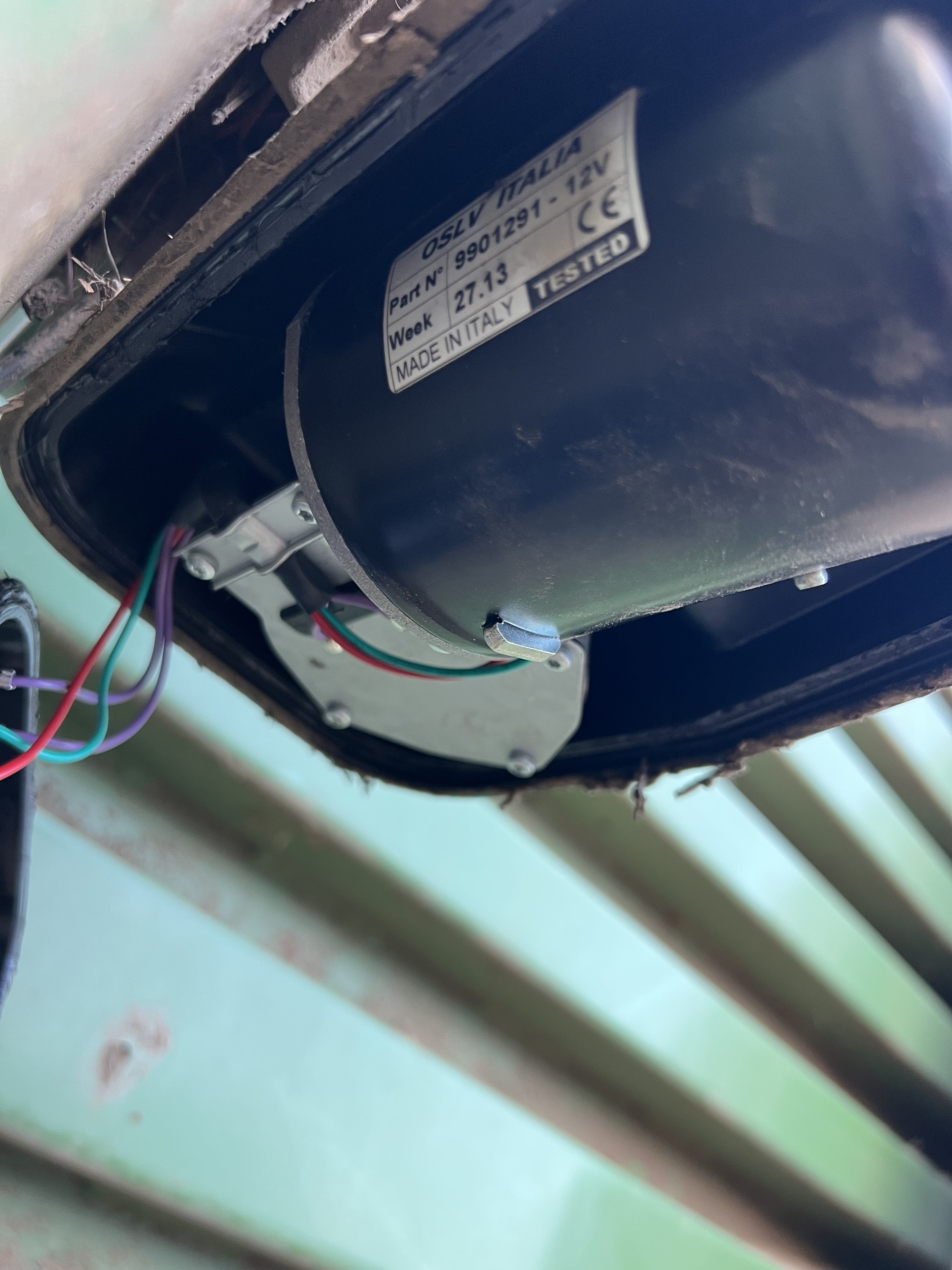

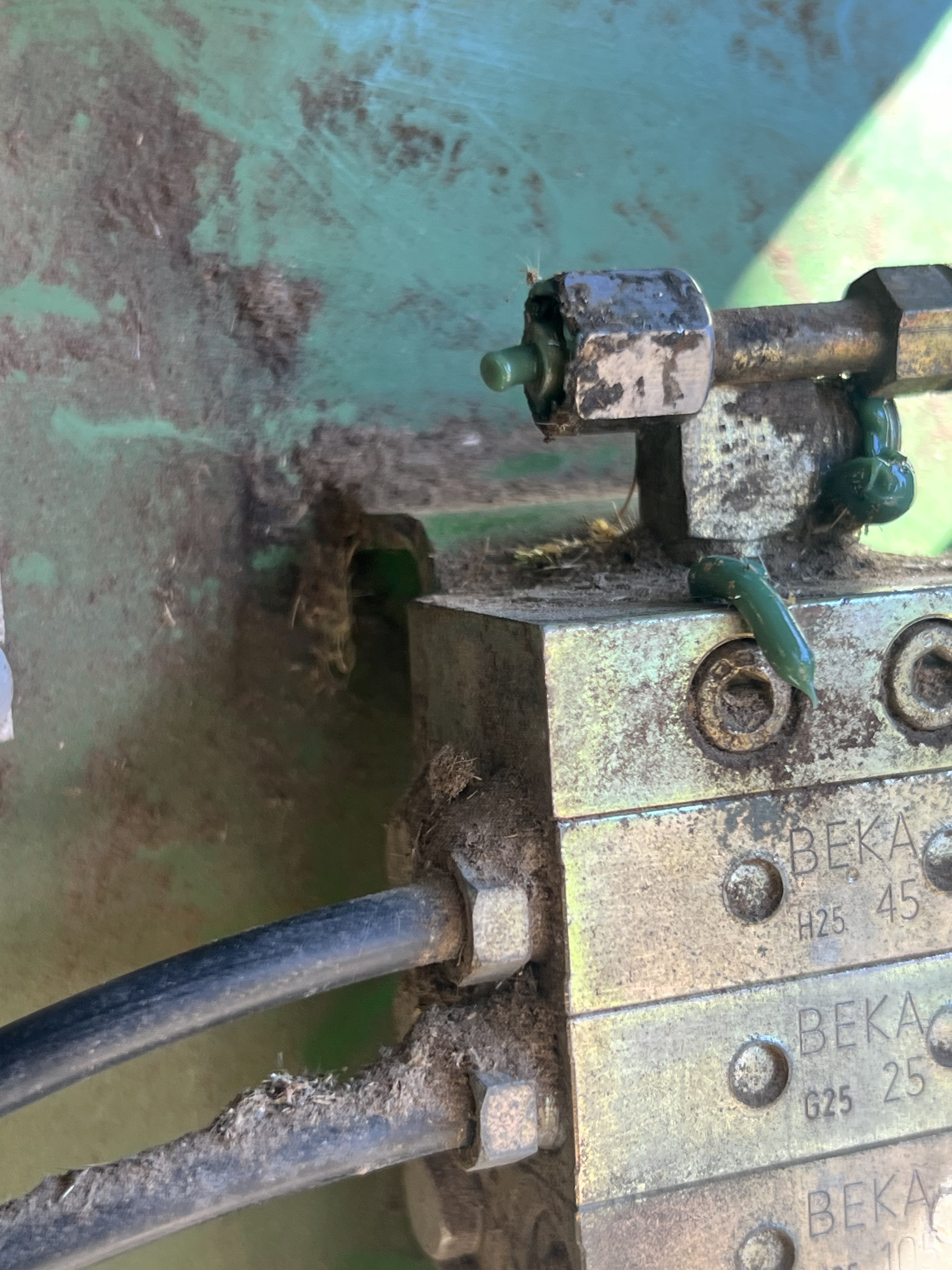

I may have to climb up to the top of the baler and manually grease the main manifold with my DeWalt power grease gun every 20-30 bales until we get this resolved.
Luckily, the main manifold has a manual grease zerk on it for just such an emergency.
Here’s a line I pulled off one of the smaller manifold blocks still pushing a little grease.
Here’s the motor under the greaser. It was plenty warm, but not moving. Is it jammed???
Is it unrealistic to think the greaser would last 12 years? (My baler is a 2014 MY)

I wonder if it has replaceable brushes.

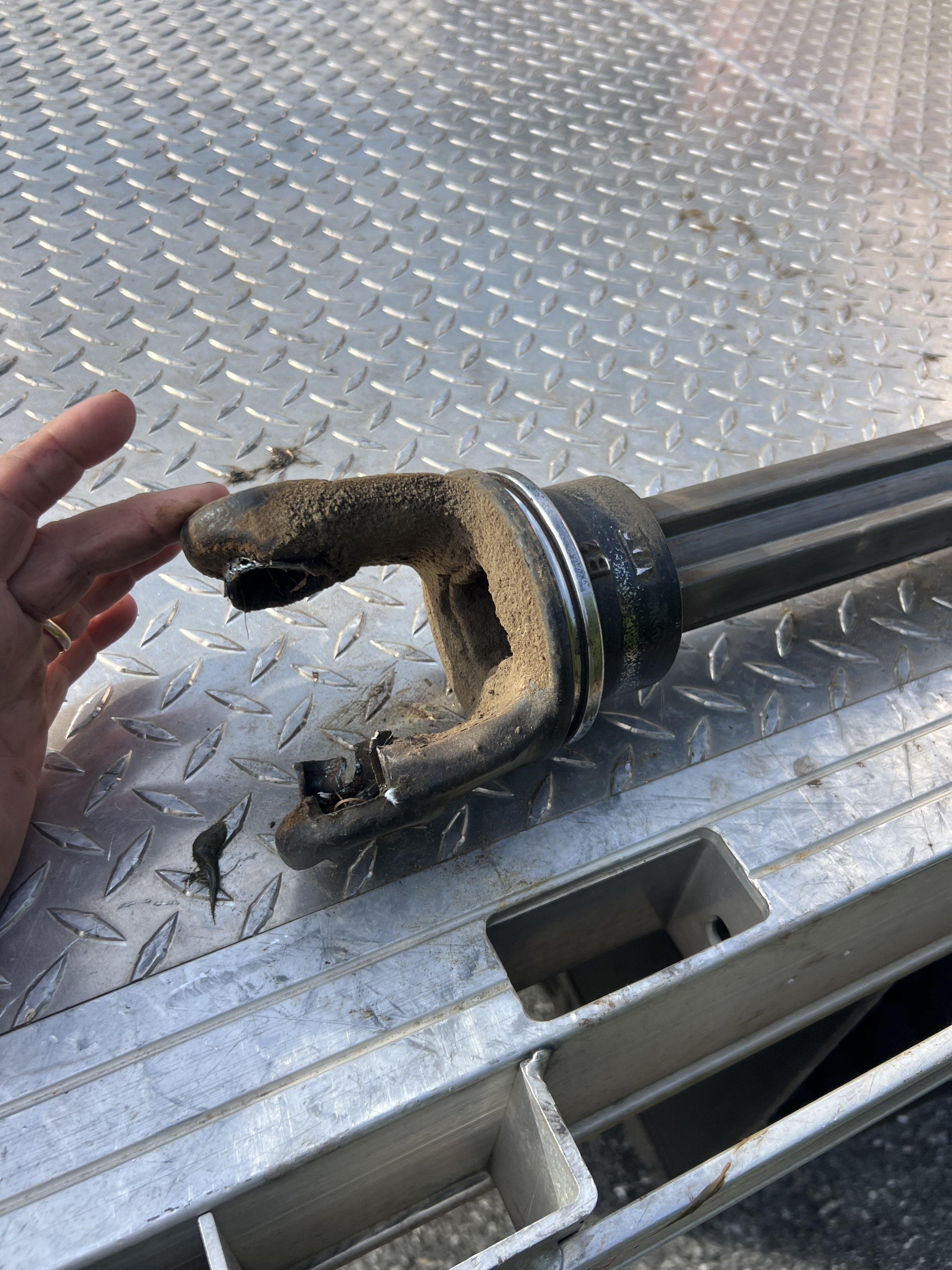

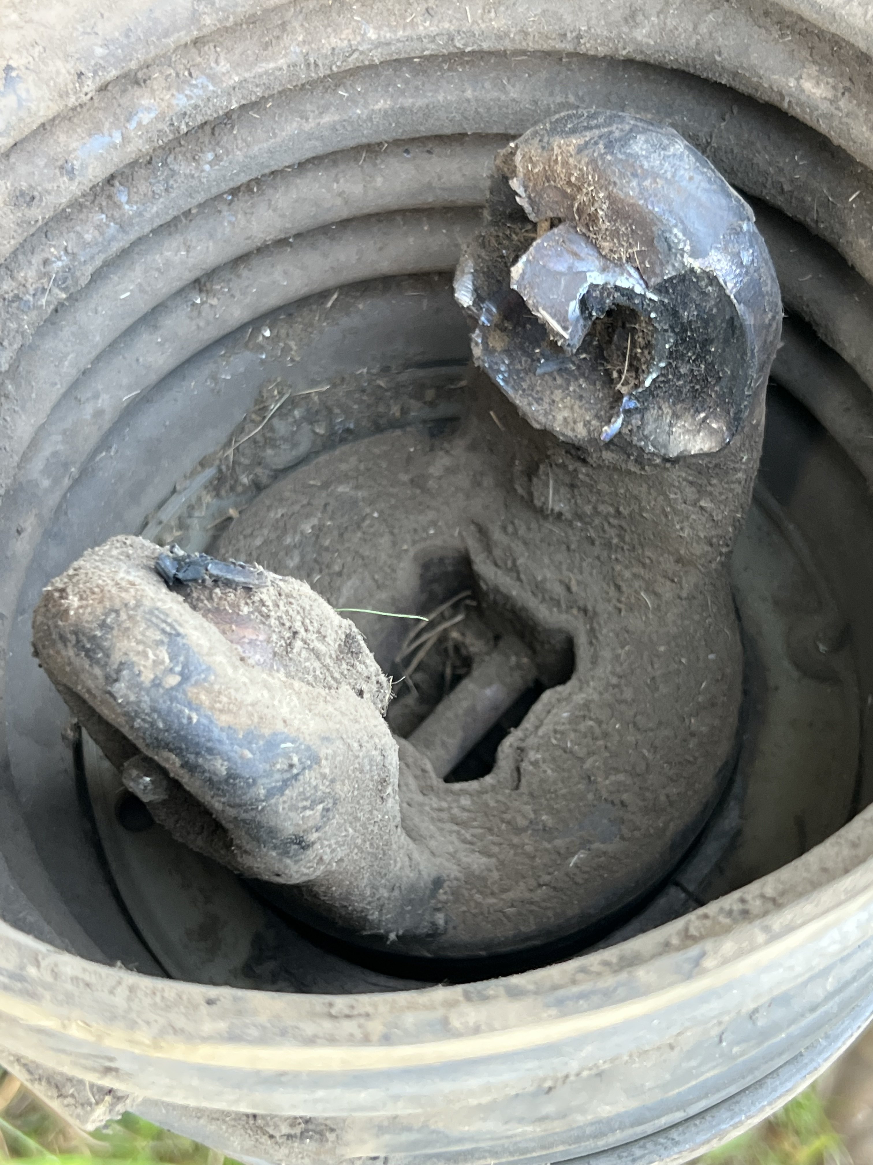

Turns out the pump is jammed. We think it broke a cog off the spinning collar inside. New greaser unit on the way $950. Was expecting much more expensive. Not bad, but while using the baler today, I nuked a u-joint and a yoke.

Mangled yoke
$368 with new cross and comer shaft pinned back on.
Had to drive 300 miles to get it fixed on the spot.
Took it off at 7AM and was back about 2PM.
I need something good to happen soon with this baler. It makes a heck of a bale, and it was cheap. If I wanted a baler with more common & easy parts, I’d get a Massey-Hesston, but $120,000 for a used one is ridiculous.
All that money buys a heck of a lot of parts & service.
