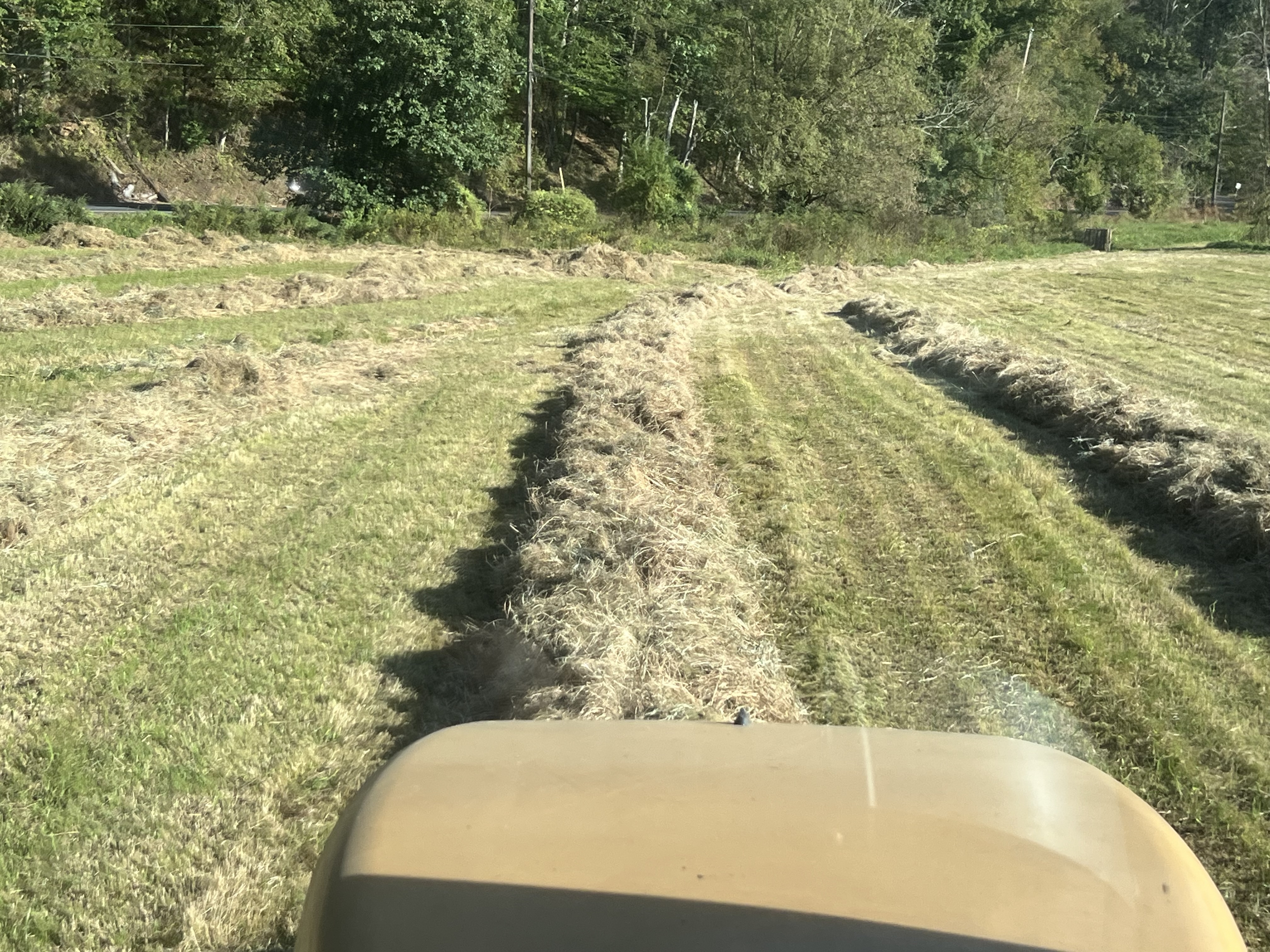

Here’s me raking earlier-

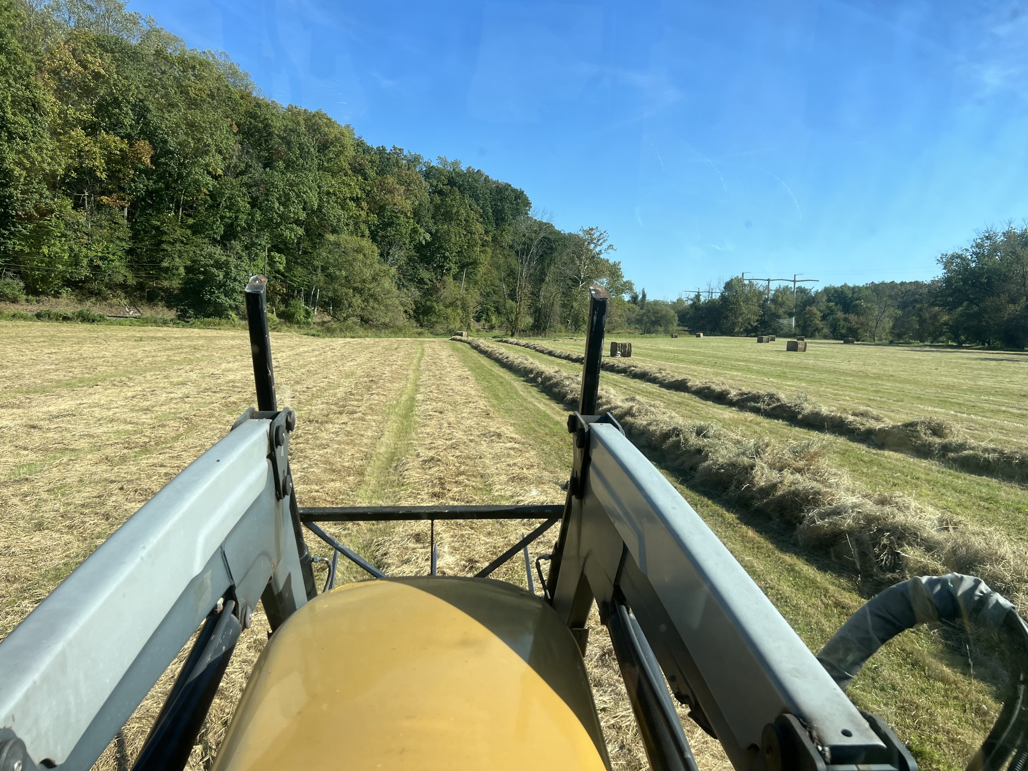

And some baling later. You can see a bale up and to the right that fell into the weeds.

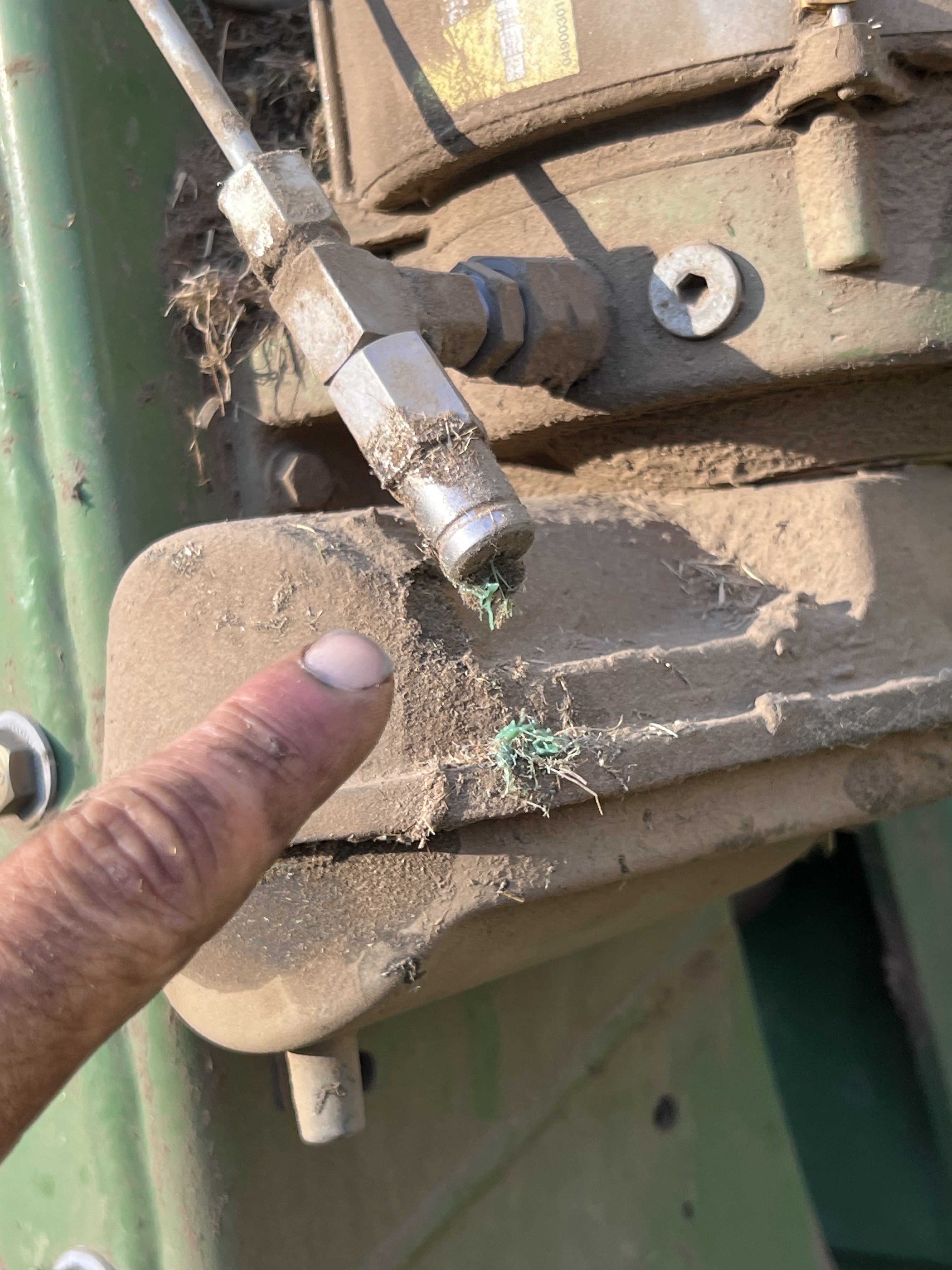

Well it got worse today. While performing some tests, the greaser up & quit on me. I don’t see any kind of reset button, either. Greaser motor is very warm, but not driving the greaser.
Earlier, while it was running, I had isolated the problem to the primary manifold block. I removed the primary incoming line, and it pumped grease and the check valve stopped spitting.
I reconnected it and then removed the 5 lines exiting that manifold to the 5 smaller manifolds. No grease was coming out, so it must be a plugged primary manifold.
Then the greaser stopped spinning inside…..
