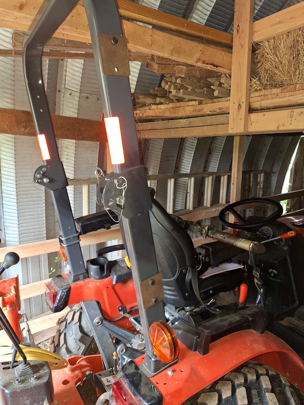

This is my skid pan and front bumper.
This is the 4 post canopy.

The early Kubota B20 in the 80’s didn’t come with a four post ROPS until later. Loader not designed to be quick disconnected from tractor. It had steel bar that that bolted across the tops of the loader towers, above the hood, that provided “box” strength. About 0.5x2” flat bar. This what I bolted 2” square tubing uprights to make a four poster. So did Kubota on later models. Tubing and angle welded frame bolted to the rear ROPS. Sheet metal top, bent lip up front to divert water to sides. Also a brace to the vertical exhaust muffler. 2x4’ x2” piece of coated acoustical foam from McMaster’s glued underneath. Enclosing does increase noise.

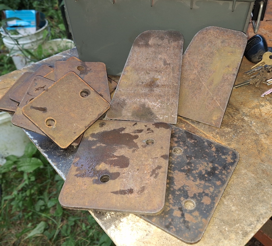

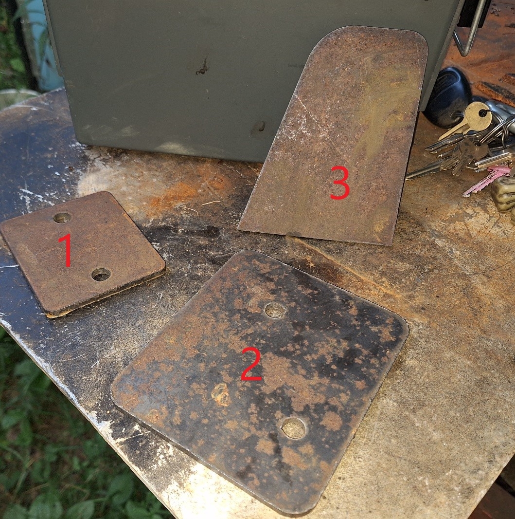

Made a few more brackets last night.
No.1 are the plates for the factory ROP's
No.2 are the lower FEL mounts
No.3 is the base for the tubing that will be attached to No.2 plus gussets

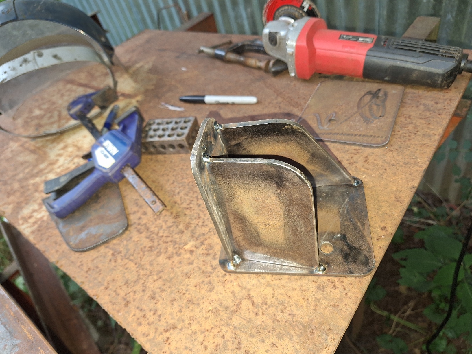

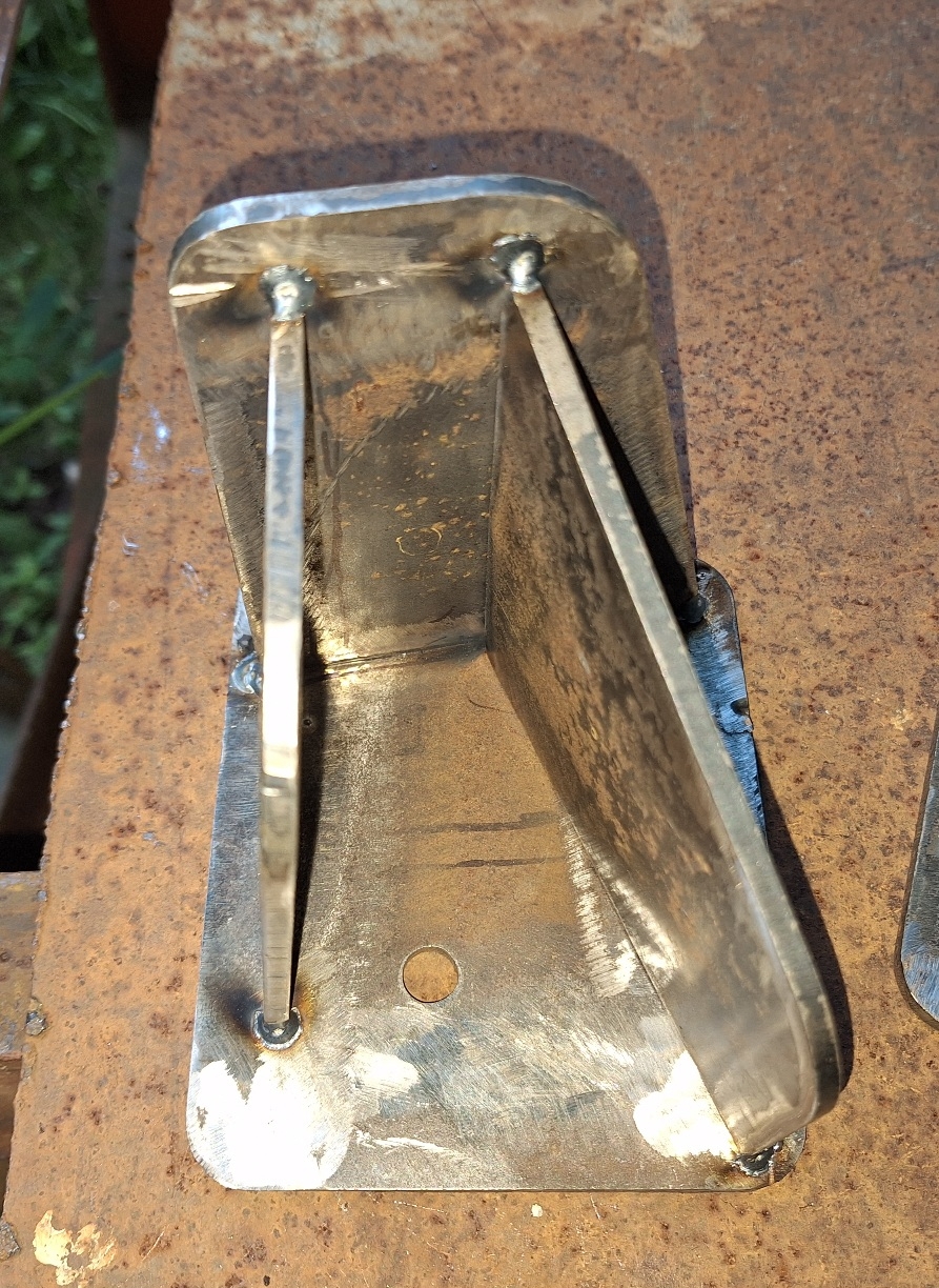

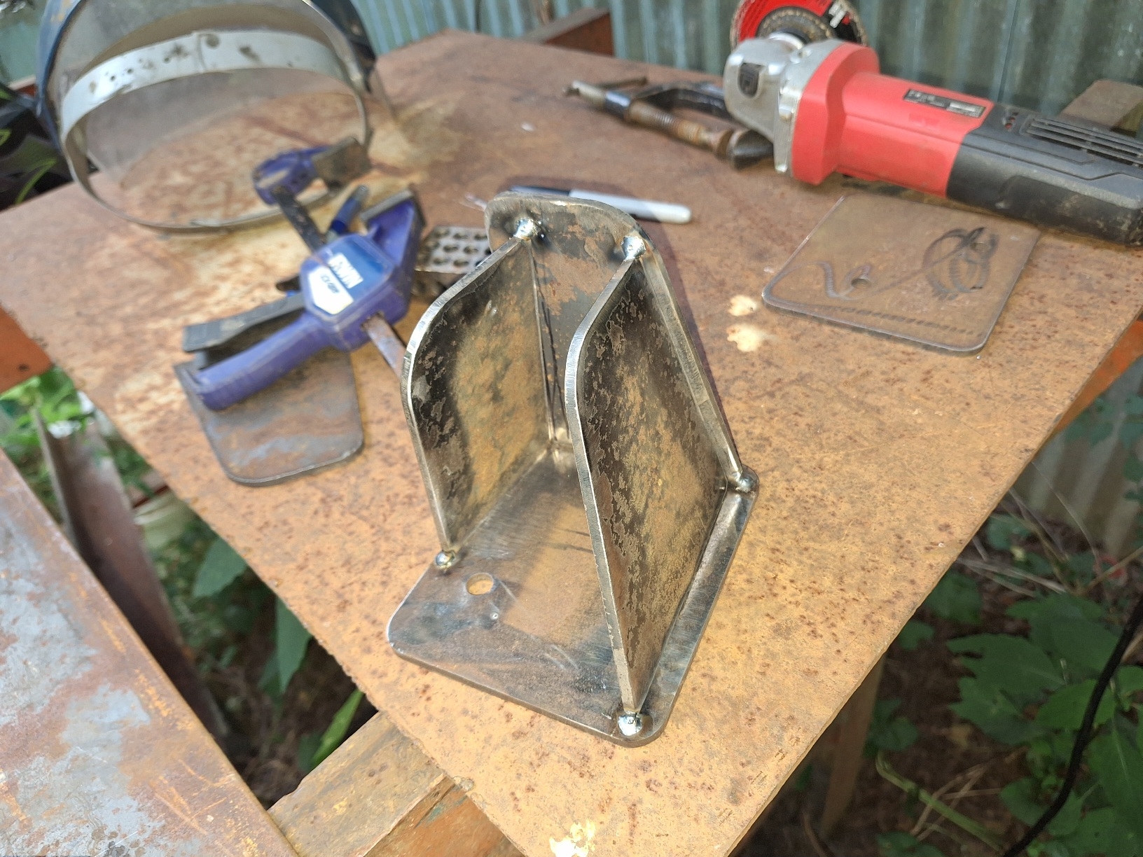

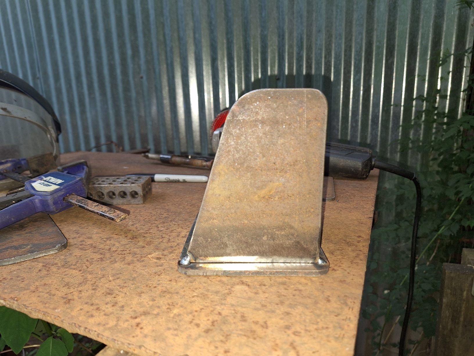

#25
designed and cut more bracket parts, FEL bracket is tacked together now
It is angled back to help deflect trees and branches etc.

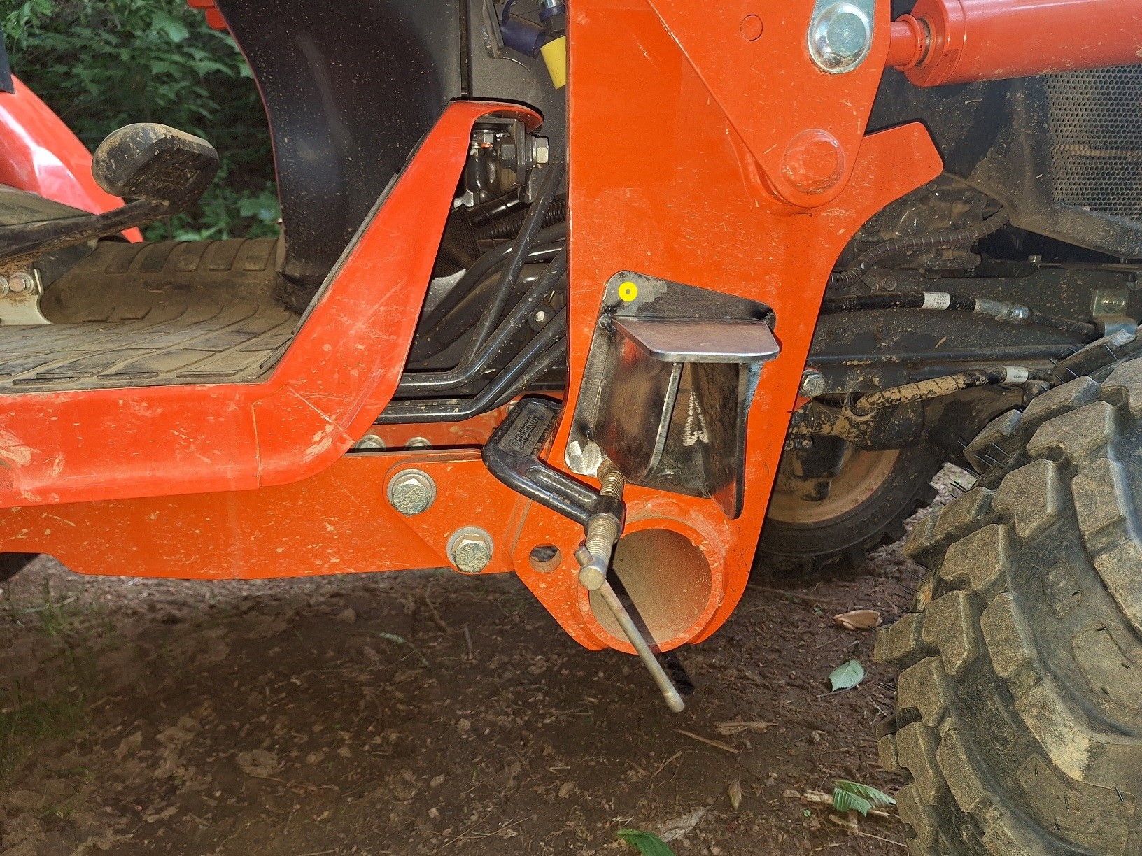

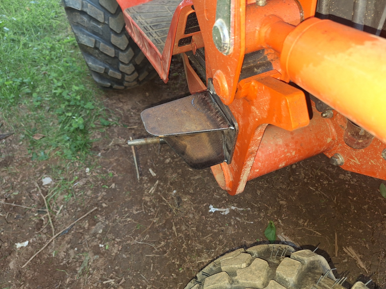

So I noticed that I had made the bracket "square" when I looked at the mounting plate on the tractor was at an angle.
So I redid it last night...
Here is the new mount, I will drill a hole where the yellow circle is so 3 bolts will hold it on
