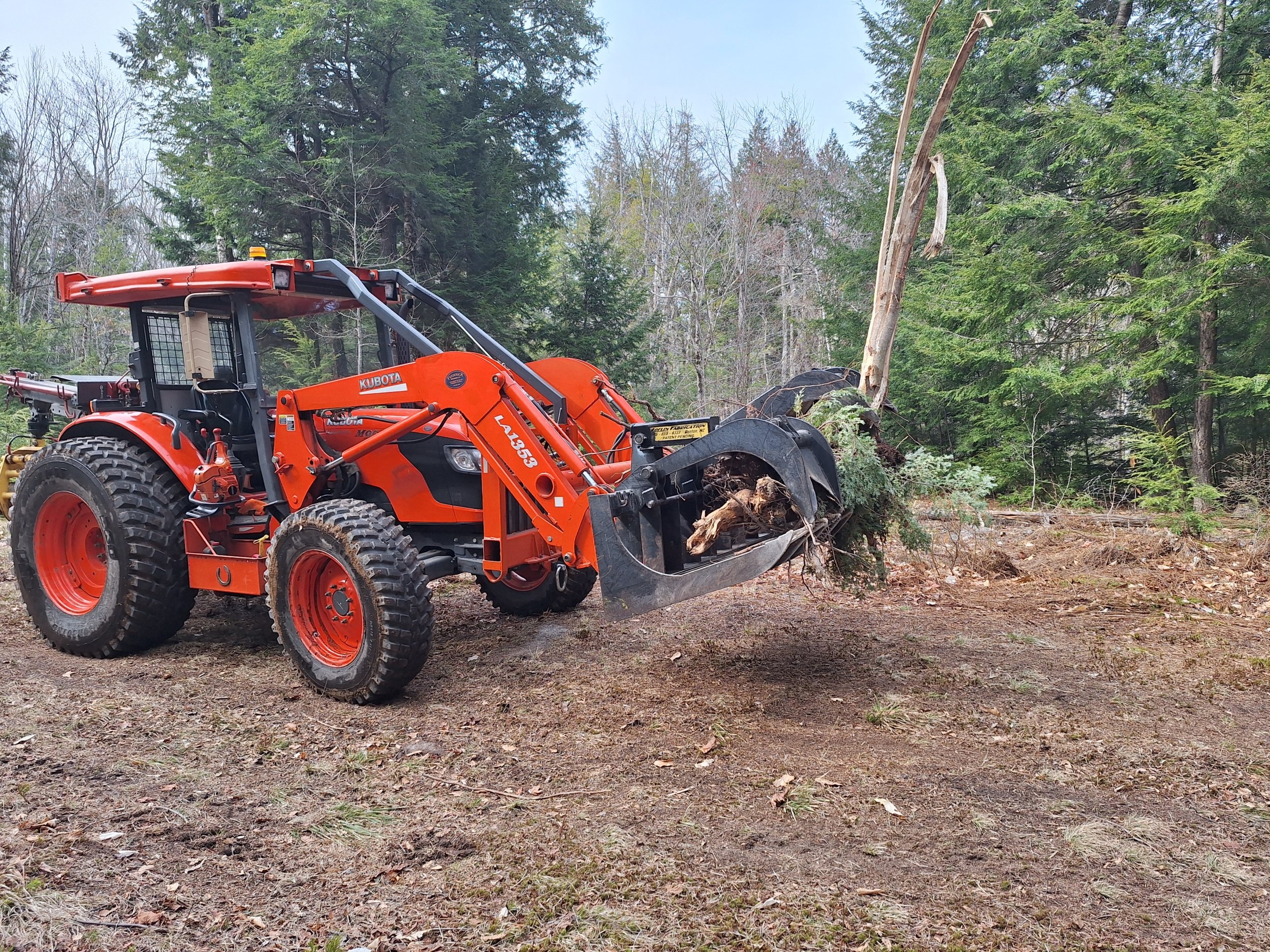

Maybe incorporate a grab handle on the front upright for safer egress in and out of the tractor?
   / The lets build a cage for our kubota B2601... #12
Adding chainsaw, fire extinguisher, chain, long tools mounts makes the tractor safer and a pleasure to use. Four post allows many options for improving lighting and mirrors.
All the Kubota TLBs use what looks to be the same design for the 4 post ROPS - just the size is different.
When we got the M59, it was our first tractor ever with a 4 post canopy, and I like it.
Making a 4 post ROPS into a cab could be done, too.

Definitely going to make it comfy, have built enough cages to know that at 25 years old is different than 55years old bodies don't move the same 😛 I got to go to the dump 1st today, then find the old fab shop....old wood building 😉
Plan several hand holds, I have some 1/2 tubing to bend for them.

I have been really wanting to do this on my m7060 as well! The way the canopy mounts leaves a lot to be desired. I keep raising the canopy so that I can stand on the tractor and it keeps falling back down. I have been thinking of mounting in the same location, I will be watching your progress.

I did the same but with a full skid pan. I'll try to get a link to my post here, it was about 8 years ago.
   / The lets build a cage for our kubota B2601... #17
Here's a Pic in the meantime.

I'm pretty sure I'll eventually end up with a cage around my Landini trekker crawler. The ROPS just isn't enough.
Are you bolting to your front end loader? It should be a sturdy place to connect to, but if you ever have to remove the loader, the cage will also come off.

Hope to work on it today after a few honey do things. I do not plan on taking the FEL off ever unless it gets damaged some how, but worst case would be take a bunch of bolts loose.
