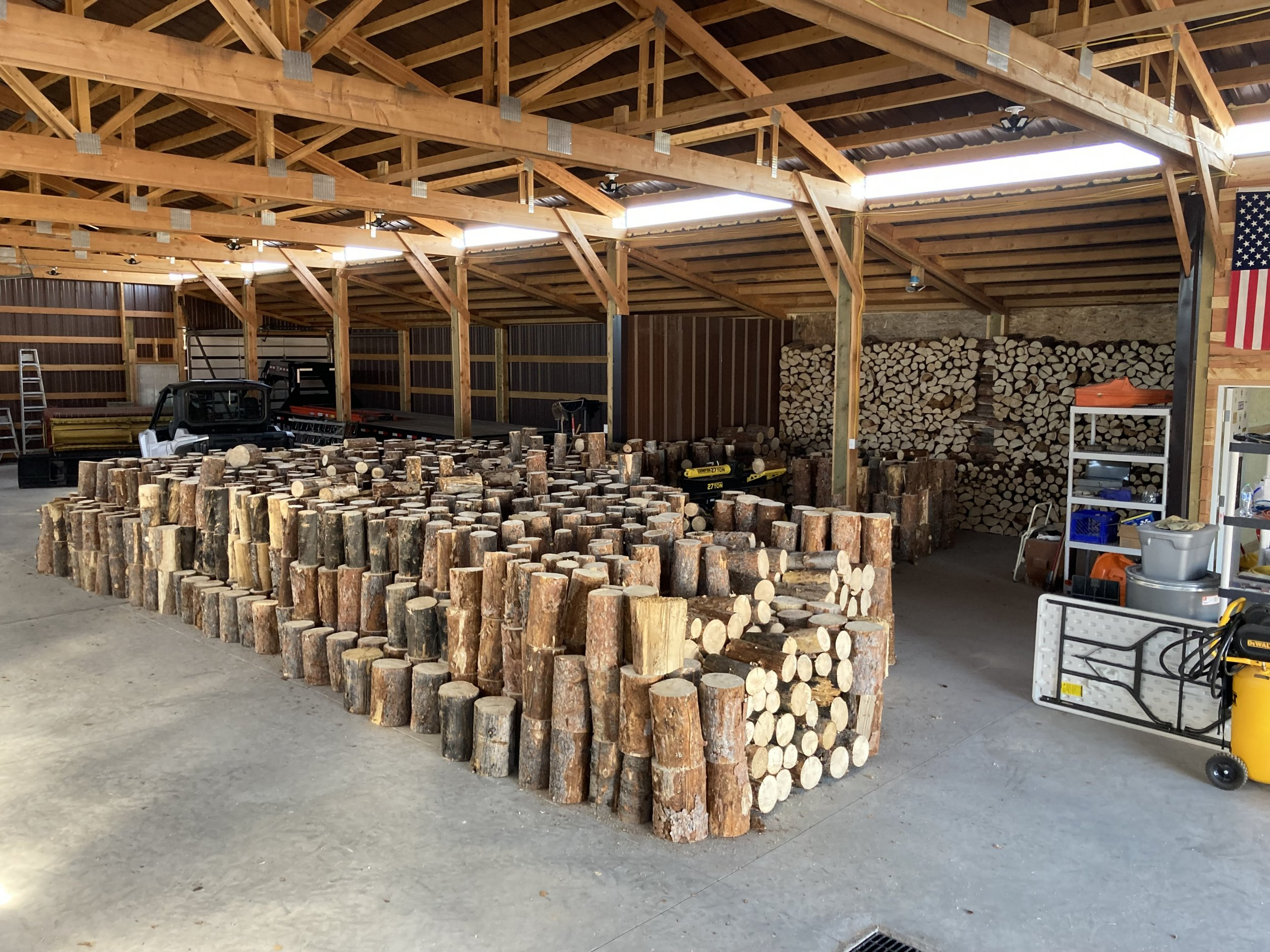

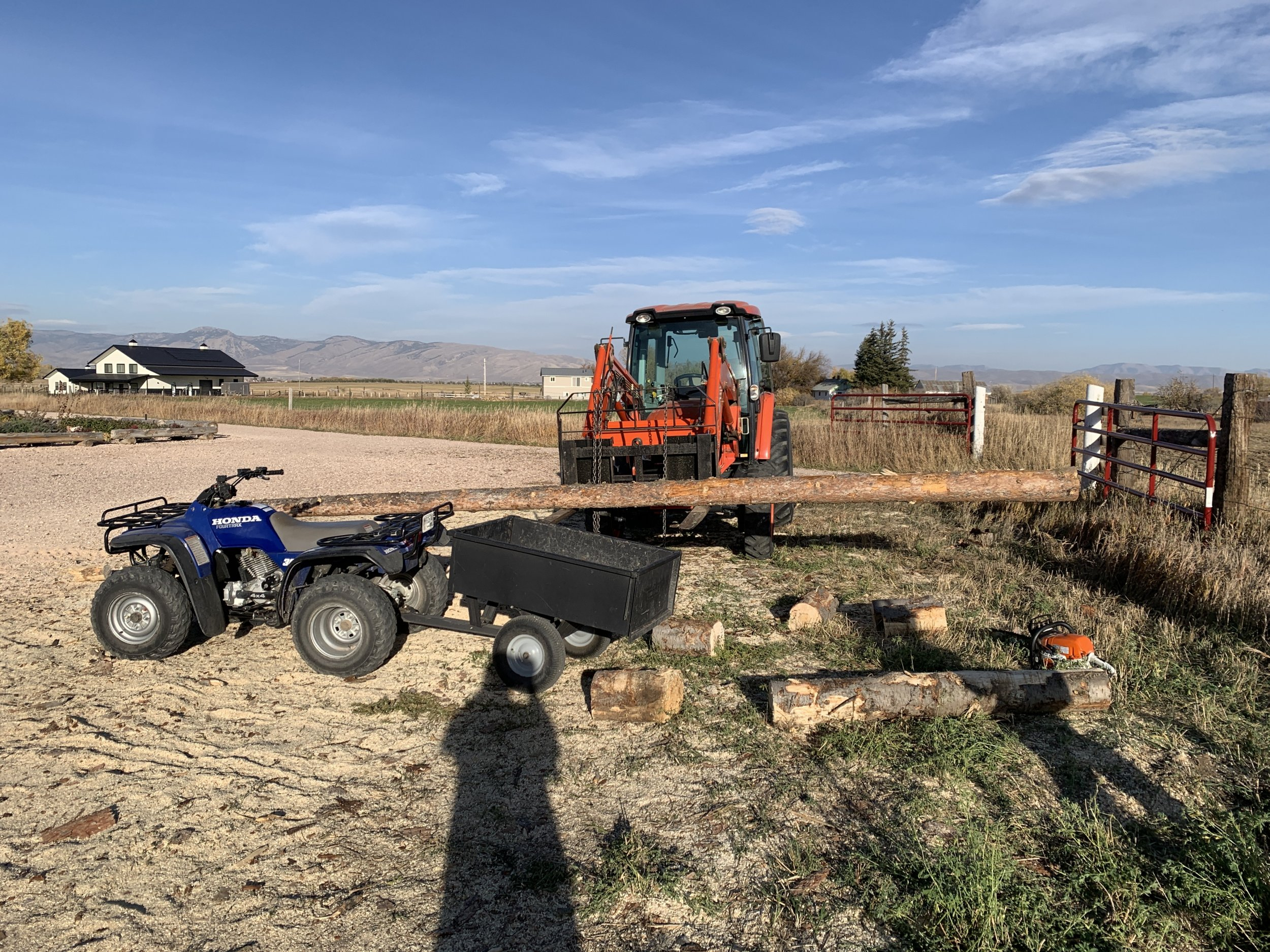

It's been a week since the wood was delivered, it's all blocked up and in the barn. We are tired!
We can now split at our leisure.
This was the last log.
