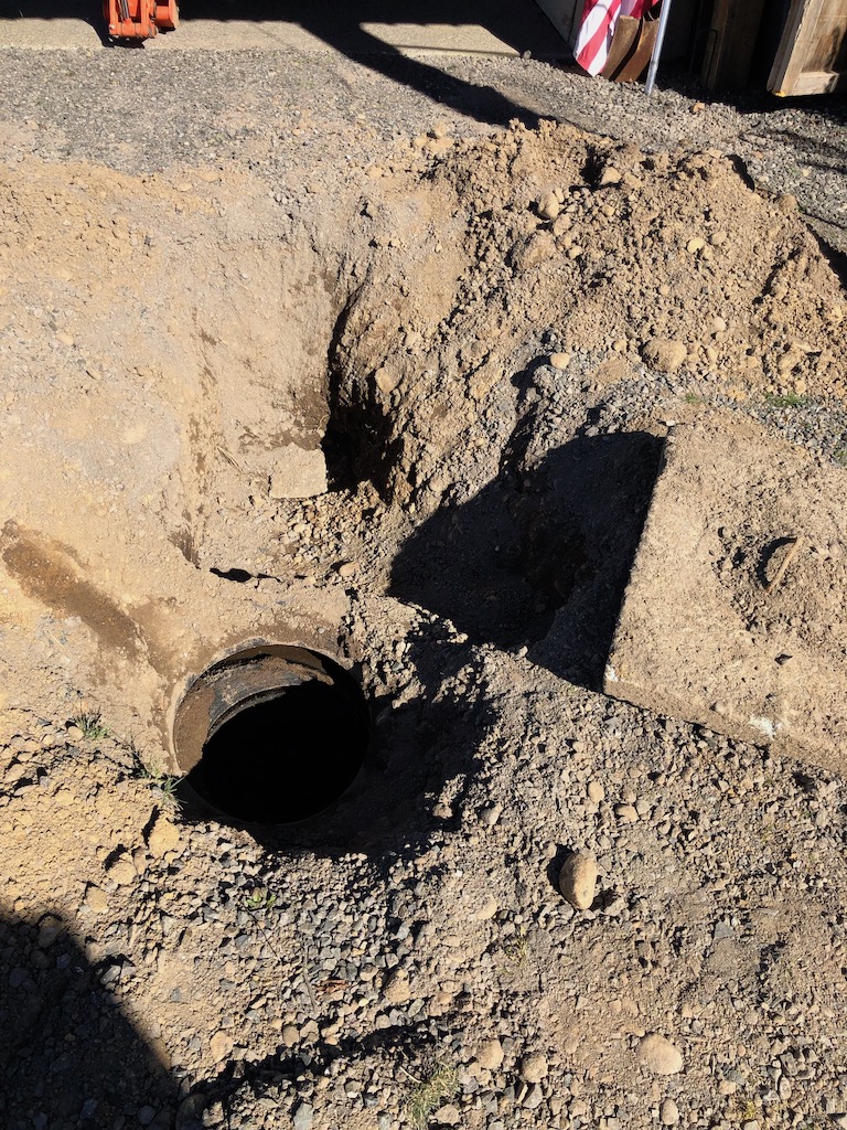

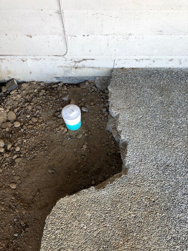

Amazingly the root was pretty small but hairy. I didn't get to see the inside of the old pipe section. I had to run to an appt. New straight vertical clean out and cap installed.
The risers for the septic tank will need to be tackled on another day but I am going to do it... either myself or the same guy. I asked him to quote it. Looks like it will take one 12in riser and one about 30in riser as the cement rectangular cover is 28in long side length. Depth of the tank top to grade (level with patio) is also 28in. Note the two tires that are sitting on top of the clean out and the cement cover sat on those.
Need to do some research on riser options. I want to be able to drive over it with my tractor if possible.

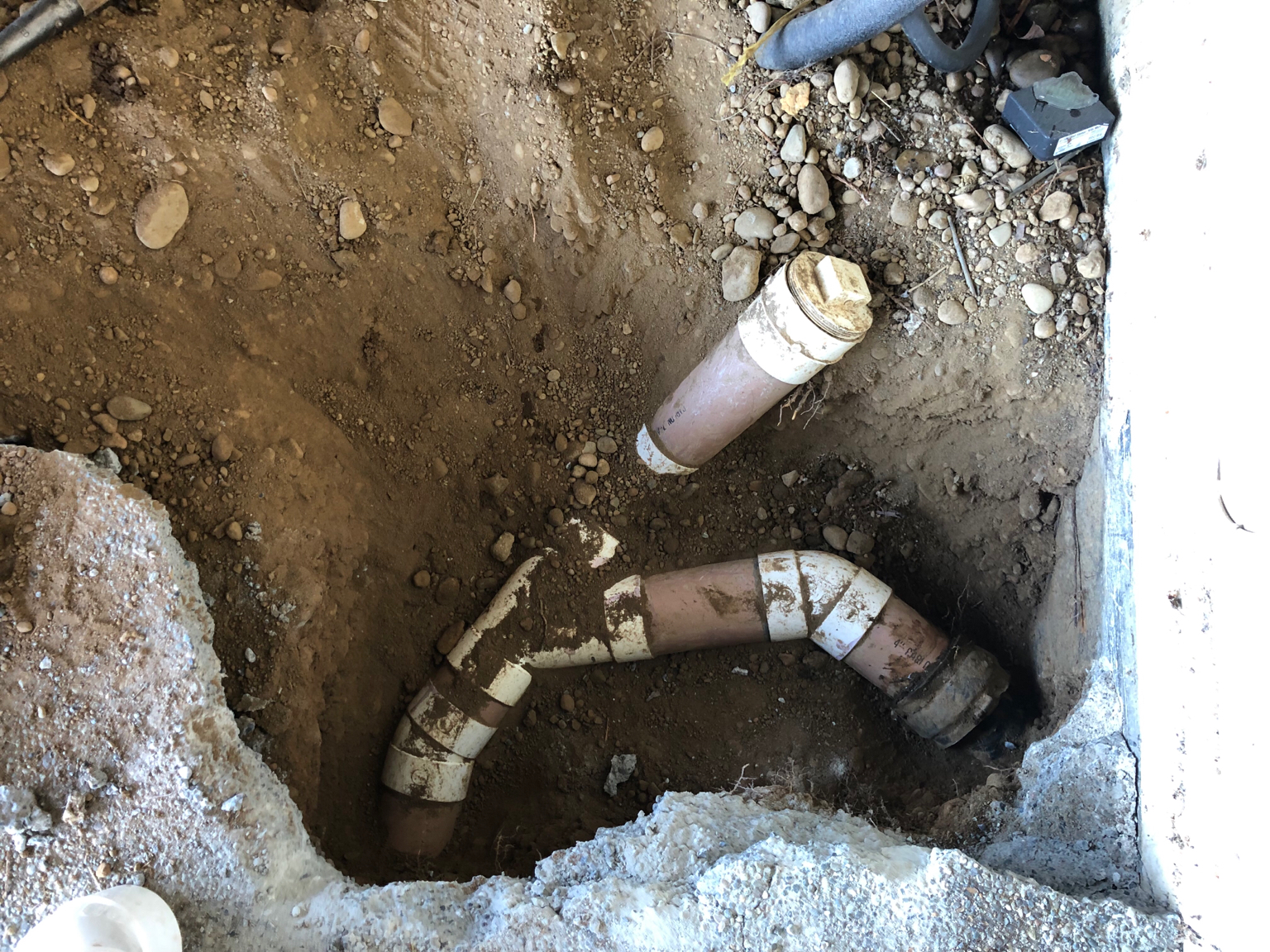

Okay. Another discovery. Found the root. Ran along the foundation wall. Penetrated the connection from black ABS to the PVC pipe connected with a rubber sleeve.
House built in 1986. I知 not the original owner so I seem to learn something about it痴 construction whenever I get into a project. Note the sharp turn the drain takes after exiting the house and turns to the septic tank.
When you replace pour concrete around the coupling after you cinch it up. I always use long radius ells, Ys and combo Ys and 22.5 degree ells where ever I can. Our house is the same vintage and having the same kind of problems.
