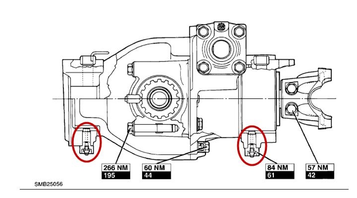

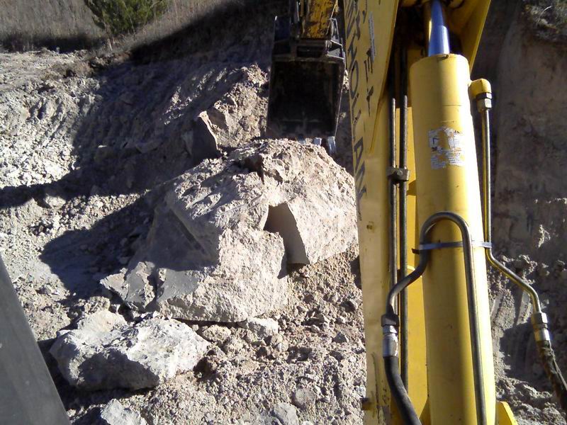

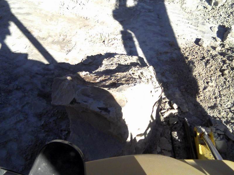

My front axle at the pivot takes grease real easy. Both the front and back fittings. The place that I struggle with grease is where the wheels turn on the axle. There are two fittings, one is easy, the other is always a battle. Of course, I'm 2wd, so it's probably totally different then what you have.
Eddie
Eddie, I'm sure there are differences because my rear axle pivot has a carrier bearing for the driveshaft and a differential in there of course. I've posted an illustration from my maintenance manual and it shows the zerk fittings. I circled them in red. They are screwed into a drilled bolt about 1-1/2" long. The head of the bolt is recessed to protect the zerk. After taking out the zerks and seeing they were okay, I removed the bolts. Their grease passage is about 1/8" in diameter and was completely gummed up with rock-hard grease. I cleared the holes, reinstalled, and grease now goes in effortlessly.:thumbsup:
Like you, I had a heck of a time on my wheel pivots (ball joints?) both top and bottom. My problem was that my Lincoln electric grease gun nozzle fit loose on the fittings because they are smaller. All the grease would just come out of the nozzle in a glob. I went to Autozone and they had a cheap grease nozzle for $2.59. The jaws in this nozzle are plastic, but there are 4 of them instead of the standard 3. Since it was new, it fit snugly around the zerk tips and greasing both top and bottom worked well. The tips were also smaller on the driveline u-joints and expansion joints, but the new nozzle made greasing easy. It's definitely worth the money even if it doesn't last long. I put it on a manual grease gun and left the 3-jaw nozzle on my Lincoln.
So now I can lube every zerk on my tractor and keep it working smoothly. In the process, I learned a lot about the tractor from looking up from the bottom.:D
