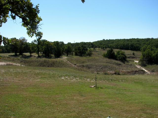

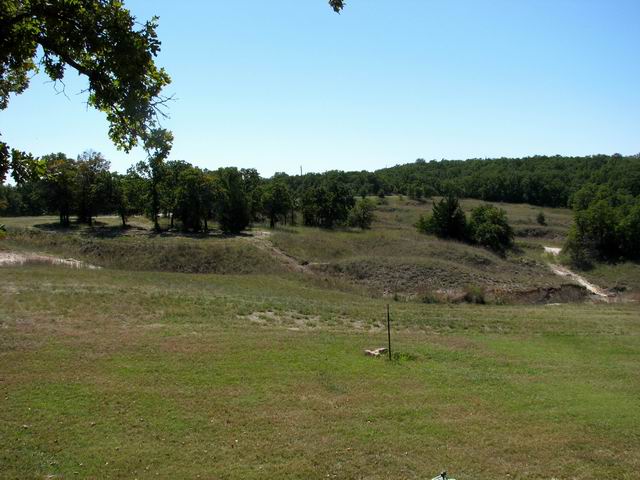

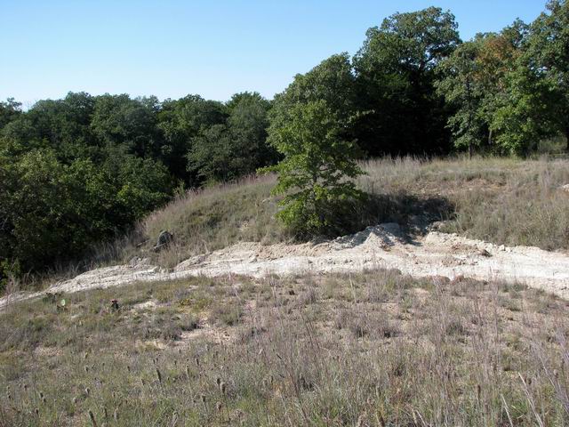

I talk a lot about my land and gullies because at least half of my property has deep gullies from eons (aeons) of erosion. I have slowed much of this erosion by terracing and controlling where water flows, but there is probably no telling how long ago some of this terrain formed. Now that I've purchased a fairly new loader-backhoe, I plane to reshape some of the gullies and dam up narrow passages to see if I can convert the unusable land to ponds.
The attached picture shows the view from the deck on the south side of my house. The near gully is the first I want to convert to a pond with the far gullies at a later date. The mounds of dirt in the middle will be moved to fill in other washes and pits as well. Oh yes, in the photo you can see a single t-post in the foreground. This is my marker for my aerobic septic system sprinkler to keep me from running over it.

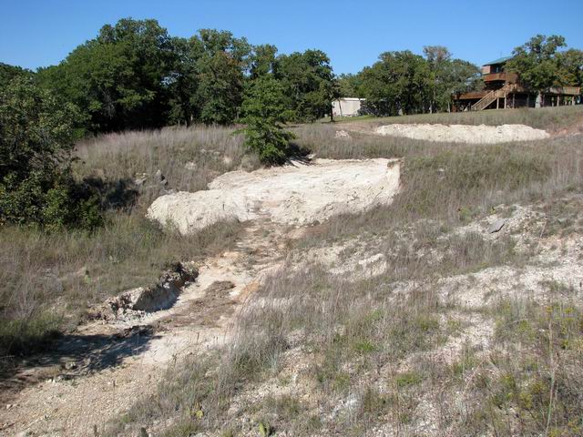

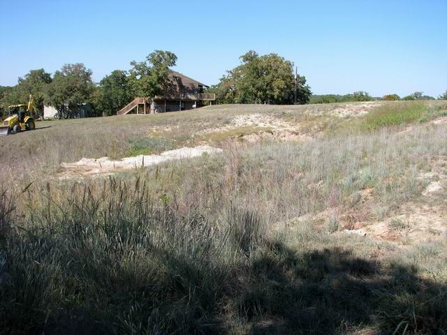

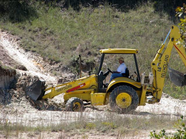

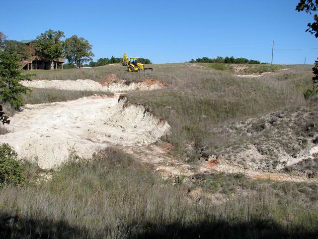

My wife snapped a couple of pictures of me on the tractor as I started the excavation.

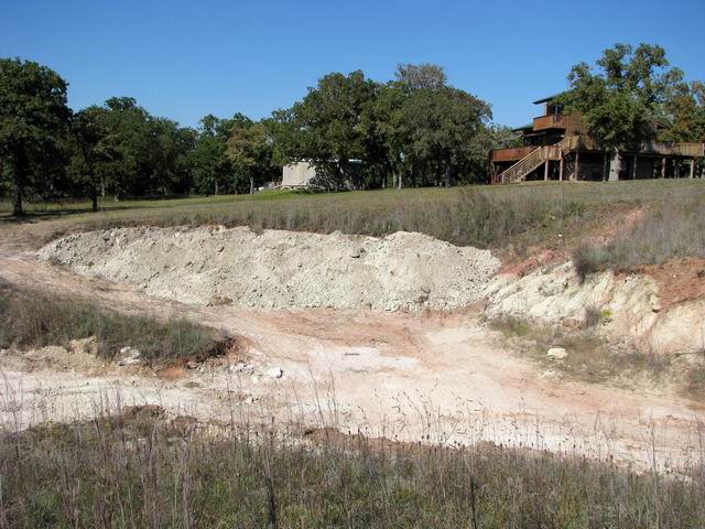

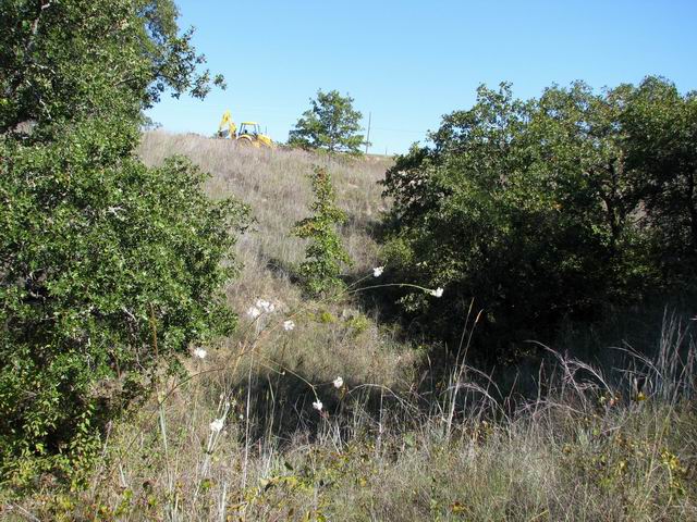

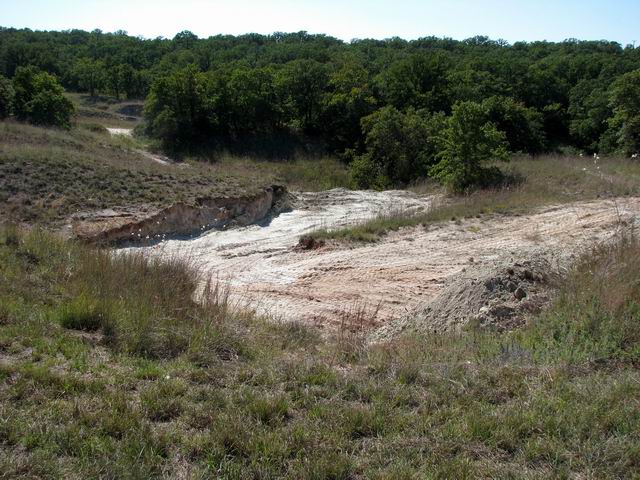

Here are a couple of photos from opposite sides after I began moving dirt. You can see how the hillside drops. I have several terrace plans to direct water from surrounding areas into this central pool. In the second picture, you can see a depression in front of the tractor at the top of the rise. This is going to be filled in completely and planted with grass to hold down erosion.

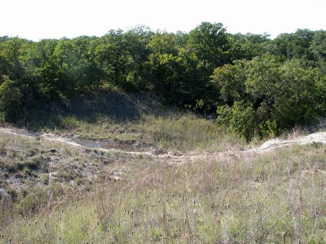

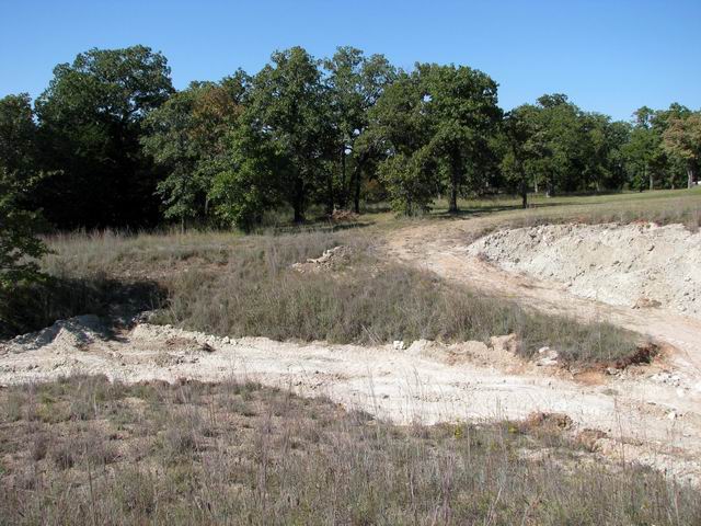

In these two photos, you can see the bottom of the gully and where there is a ditch between two hillsides. After I get all the dirt removed, I'll dam across the ditch up to a level of about 25' or more for the dam and 40' wide at the base using red clay.

Here is a better photo of the area I will completely fill. I've used this area as a sand pit and now I need to fill it in so I can make it smooth for mowing and a nicer looking yard.

It's hard to tell from the pictures but the soil looks very sandy, will it hold water or will you have to line the pond with clay?

Where will the red clay come from?
Eddie, that's a very valid concern from you and others who have asked about the sand. It turns out that I have a foot to 18" of red clay in a layer above the white sugar sand and caliche. I'll be keeping the red clay in a separate pile so I can use it to build the core of my dam. I also have a mountain of material that was dug out of my pond. I called it pond silt at the time, but it is quite water tight and I will cover the top layer of the dam with this. Where I have that pile now has sodded in solid with bermuda grass. I don't have a clue where the bermuda came from. It just appeared and covered the silt. If I can get it to cover the dam in the same way and timeframe, I'll be one very happy guy.
