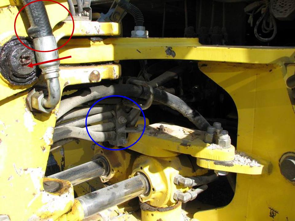

The photo below shows the two hoses that blew out. The first one circled in red shows an over-bend bubble at the fitting. This fitting should have been rotated forward. That's the way the other side is, and it has no bubble at all. I installed the new one correctly. The 2nd hose is the bottom one in the stress relief clamp. It just gave up from old age and fatigue since I regularly swing the backhoe boom to full left and right. It's going to be a challenge because I have to get big wrenches into tight spots.

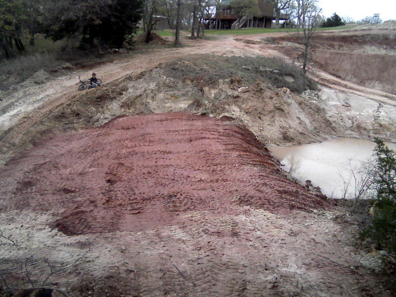

Here are some shots of this weekend's progress on my dam. I cannot believe all the clay this dam has "inhaled." When I look at the area I'm mining for clay, it must be twice as big as the dam. I think compacting the clay in the dam causes it to compress by 50% over what it is naturally. My clay mine is about 60' long x 40' wide and 6' deep. That's about 535 yards so far and I'm sure I have another 250 yards to go. Whew! That's a lotta trips down the clay highway.:rolleyes:
I tried to arrange the photos to show the progress over two days. The first photo of a series is Saturday and the other is Sunday. I put in a photo of my road across the bottom of the pond. If we get rain as predicted the next two days, this will be the last time this road is visible. It will be under water soon.:thumbsup:
The 2nd pair of photos is taken from the top of my nearly completed dam and looking over the dam in progress. You can see how far I have to raise the dam so that I can drive across. It won't be complete until it is up to the level of the hillsides on each side. Oh yes, there's a tree laying on the bank inside the dam. I bumped it with my tractor and it broke off and fell. I just may leave it there for fish structure. What do you think? Since it doesn't have the root ball, I'll probably need to find some way to weight it down.
Jim,
Were the hoses actually leaking or is it just the outside rubber coating getting ready to crack off? You did a great cleanup job if the hoses were squirting fluid at 2k+ pressure.
No, I would not replace hoses for cosmetic reasons. This is a photo from when the tractor was delivered to me after being pressure washed by the dealership. The swing cylinders are an oily mess right now from the hose dripping on them. The hose on the side of the boom was clearly visible and I stopped using the hoe instantly when it started to squirt. BTW: The backhoe's relief pressure is set to 2850-2950 psi and pump flow is 40 gpm. This ain't no weenie backhoe.;)

:The 2nd pair of photos is taken from the top of my nearly completed dam and looking over the dam in progress. You can see how far I have to raise the dam so that I can drive across. .
How are you getting good compaction on the water side?
/ The gully to pond project
#271
Put a yard+ of dirt in the loader and drive back and forth over the lip. You can see my front wheel tracks if you look closely. Anymore compaction than that ain't happening. It's plenty as far as I'm concerned.
