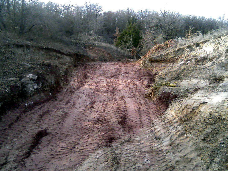

This next series of photos shows how I am preparing my core trench of clay across the gully. The first photo shows the area across the gully where the dam will go (the clear area with the tree down). I backed my tractor into the trench as close to the bank as possible and started digging to see how deep it would be before I found clay. The topsoil is just loose sand that almost came off in sheets. Sometimes the clay was only 2' down from the surface and other times it was 3' down. Of course, the thicker topsoil seemed to be up the hillside. I just really dragged the soil into the trench rather than digging and then hauled it out and piled it up with the loader bucket. That process went really quickly. I also spent a big part of the day yesterday getting rid of soil with lots of tree and brush roots where I'd removed it from the trench and had it sitting in huge piles. I hauled it and dumped it into another gully (no photos).
So today, I plan to starte building my dam. As the dam comes up in height, I'll remove more topsoil as necessary until I get the core trench all clay and higher than the normal waterline of the pond. I don't have to build an overflow in the dam since the overflow will be in another area of the pond. All I have to do is haul in clay, place it, and compact it before the forecasted rain gets here next Wed. night. I guess you could say I'm gonna be in a dam hurry.:laughing:

/ The gully to pond project #188
It appears that in last pic, you really should be laying it down in 2 inch increments and flattening it with bucket to prevent mudslides. Right now it looks like IMHO a disaster waiting to happen.
/ The gully to pond project #189
