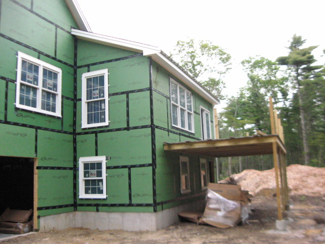

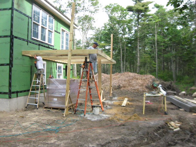

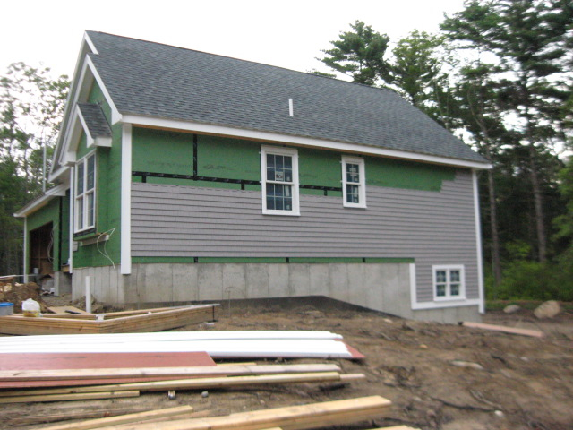

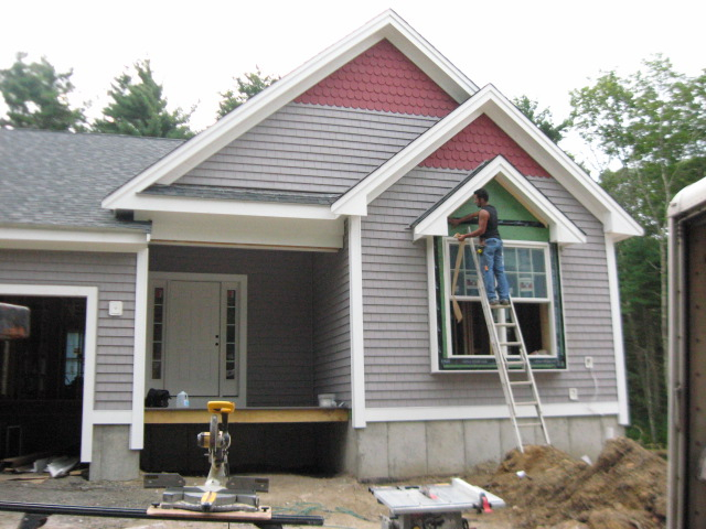

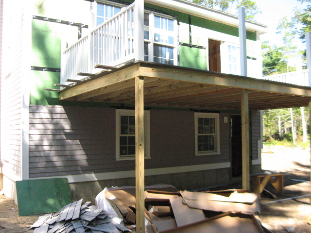

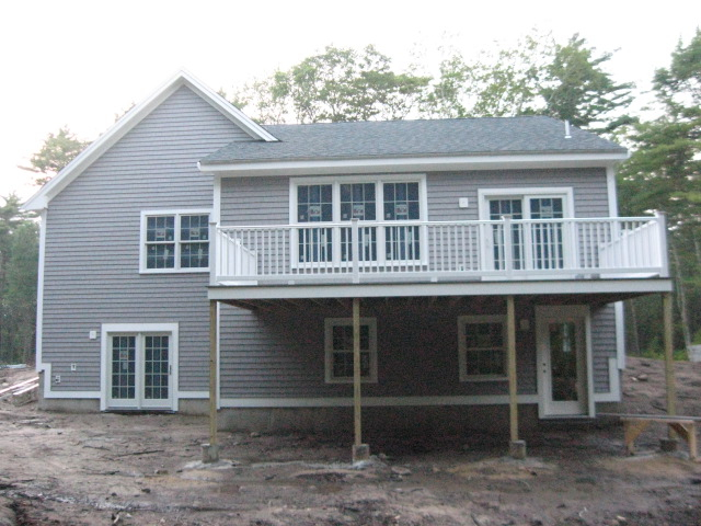

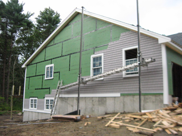

It's is now the first week of Sept. and we have a crew doing the siding, putting up the deck, the plumber and the heating contractors have now started also.

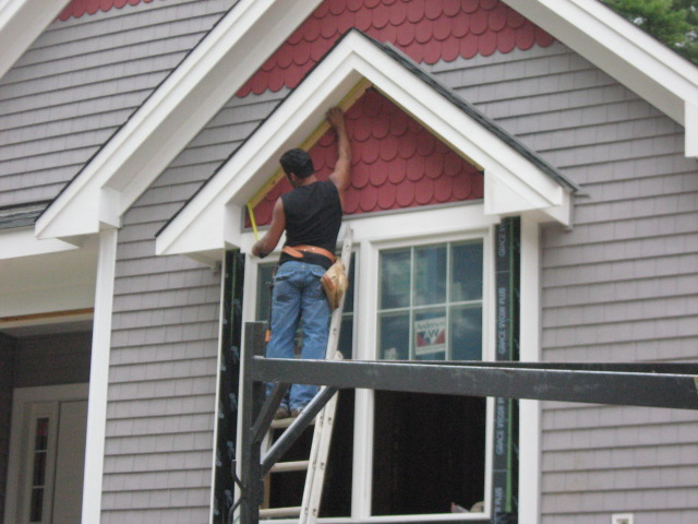

Lots of siding pictures

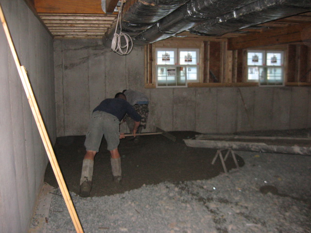

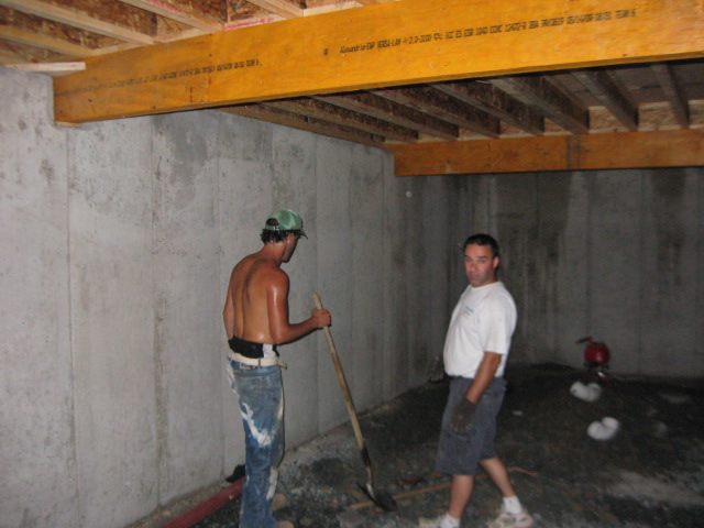

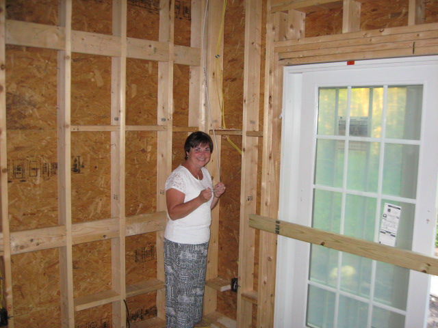

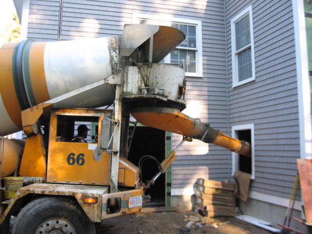

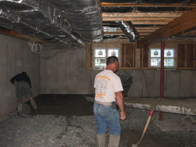

And still more siding. The concrete floor gets pored, Jane checks out my wiring job. And the neighbors goat stops by to check us out.

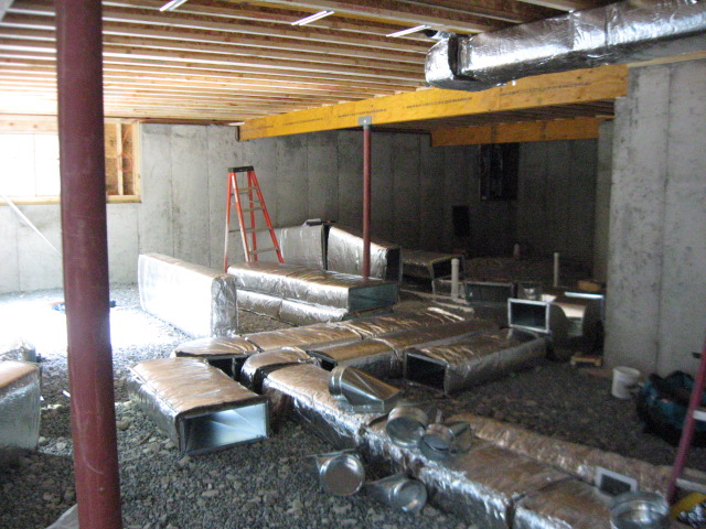

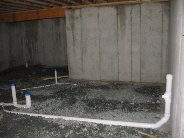

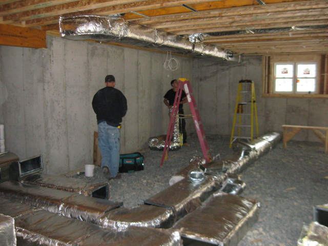

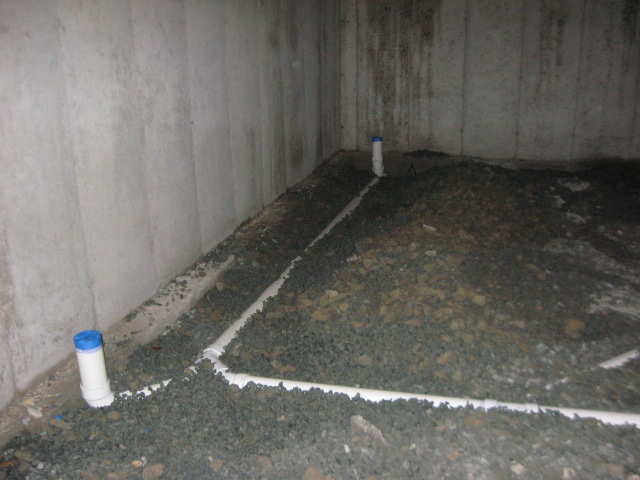

It's now the last week of Sept. the rough plumbing is done and inspected as is the electric. I did the electric work my self with the help of one of my customers that is a master electrician. He put all the boxes and outlets in and I pulled the main runs and jumpers. He put the panel in and together we did all the underground from the street to the trans. then to the house 700'+. Also the heat and air are all roughed and inspected.

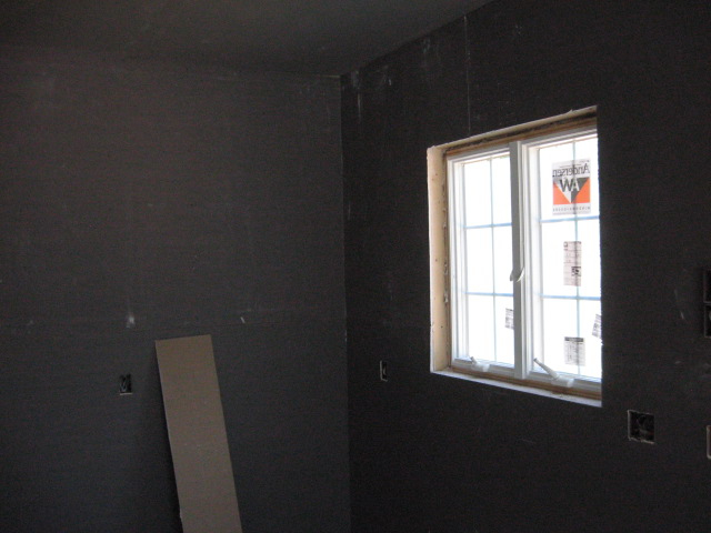

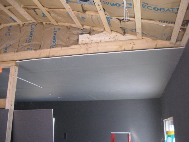

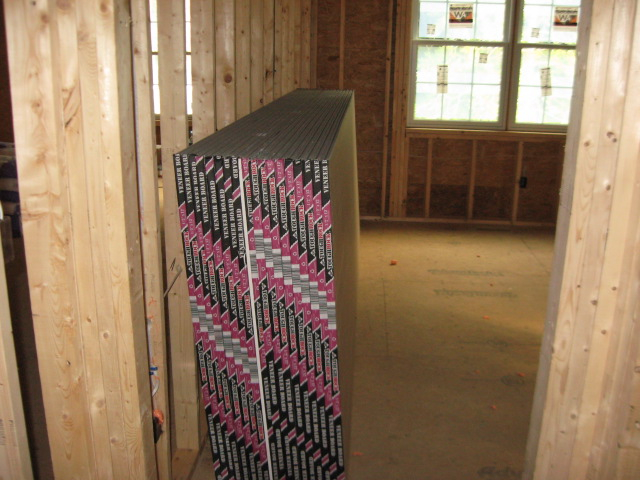

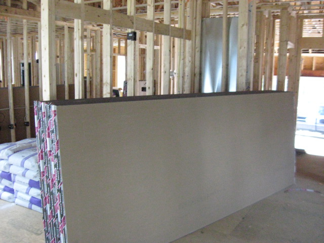

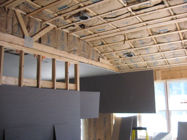

Now for the insulation and blue board. Sorry could not find any photos of the insulation install. I had them leave out the insulation in the cellar ceiling as we wanted to try and heat with a wood stove in the walk out cellar. The building inspector did not want to past the insl. Inpection do to this point . But with a few well chosen words h was ok with it.:)

Now it's Oct. first the insulation took one day from 7:00am to about 4:00pm. These guys worked hard and left the place cleaner then it was when they started. The crew has started to hang the board and said the plasterers will start the next day as he would have at least two if not three rooms ready for them

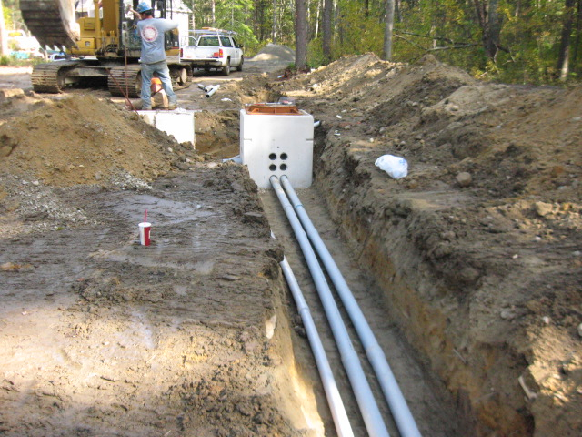

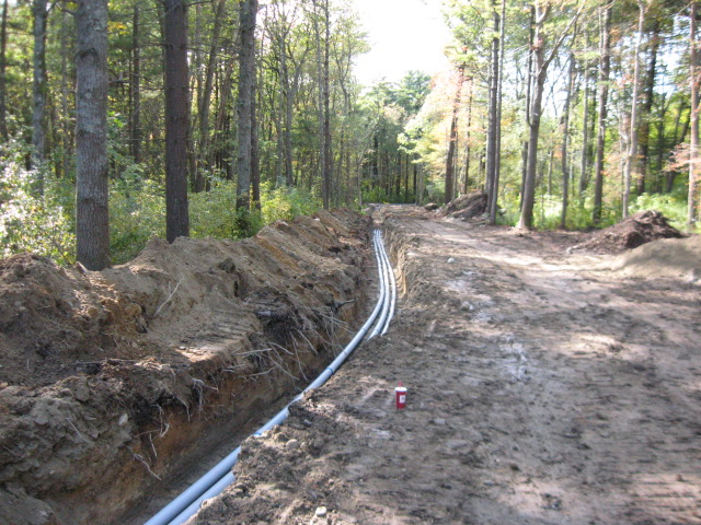

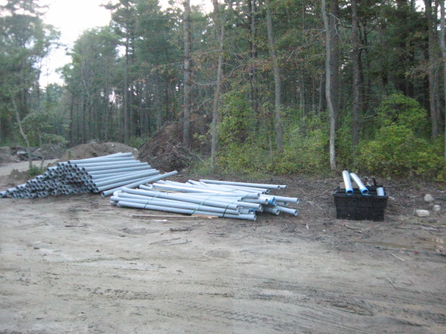

What's with the two concrete boxes? I think I understand the reason for the one with the manhole ( you've got a 700' foot run - you'd never pull wire that distance - got to have something part way thru the run) - but what's the second one next to it - that has two conduits going over to it?
Why 3 conduits? I can see two - one for electrical power and one for data lines (cable, internet, phone, etc) - what's the third one for?
What size conduit did you run for the electric? I ran conduit underground a few years back when I built my barn - and I'm hoping to get the power run out there sometime soon (finally) - but I've read some stuff in the intervening years that makes me think I may have run too small of a size conduit for the amps of electrical service I want to put out there.
Great thread - keep posting the pics!
Jim the box on the right in this picture is just a junction with manhole the box on the left is for the transformer. I split off two lots out front to sell off to pay for the 18 acres for my lot so the line coming in is 14000 volts to the transformer. The 4" pipes going to the junction box are for the power one as a spare for future use as required by N-Star elec. The two pipes going to the transformer from the manhole carry the power to the trans. then back out to the manhole to my house and the other lots.
The 3" pipe that goes to the left of the manhole is for cable. We did not bring in a phone line we do not have a land line phone but if need be we could get it with the cable. I will take a picture of it as it looks now with all the pull boxes and trans. In place. They are all in the middle of a turn around at the end of the driveway before our house.
Aaaah - ok. Now I see.
The transformer sits in a sealed box? Is there access on the side or something like that? Just curious.

I would assume that the wires enter and exit through the underside of the transformer using the rectangular hole seen in the top of the left box in the last picture.
Aaron Z
Aaron you are right the trans. is on top and the wires come up from bellow. Here are a few pictures to show you what it looks like now 3 1/2 years later. The first pic. is looking towards the house from the driveway. The next from the house towards the road. The third shows the trans. the white rock is sitting on the manhole and to the right is the pull box for the cable. The last is to show the grass we planted to hide it all.

Doh!... I'm not sure why I was even thinking this - but I was looking at the box and wondering why a transformer would be put inside a box like that and buried with no access. I guess looking at the construction pic it just wasn't clear that a transformer would be placed on top of the box. Makes sense now with the additional pictures GBOUTDOORS posted.

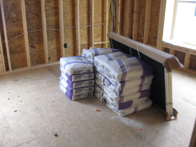

Oct. second and the plasterers have started. Also the well truck is on site and starting the well. We have town water that goes buy the property but they wanted us to spend $12,000.00 on special pipes to bring it up to the circle and out to the three lots. The well cost me $5000.00 he had 15 gal. per min. at 150' but when I got home the truck was still there.

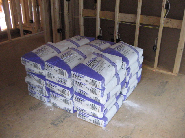

We did not have water on the site for the plaster so a neighbor let me fill this container from his well. It took three fills to do the job. Jane picked out the front door color so I painted it up for her.
