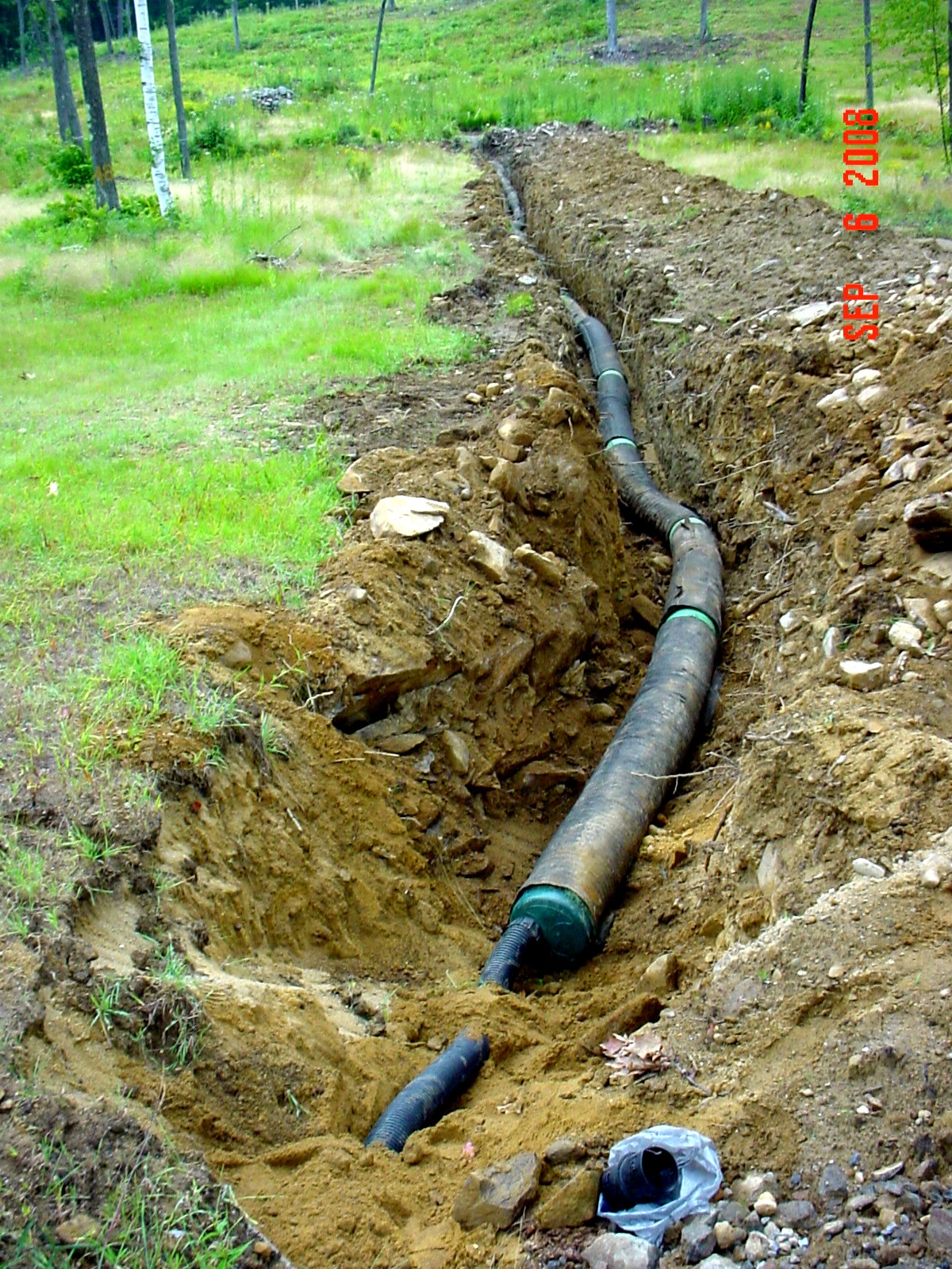

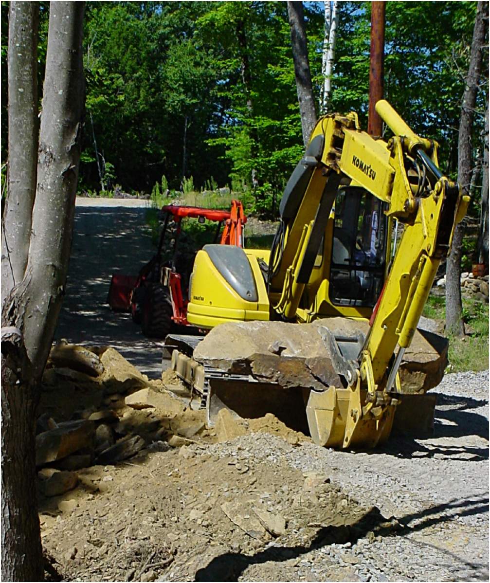

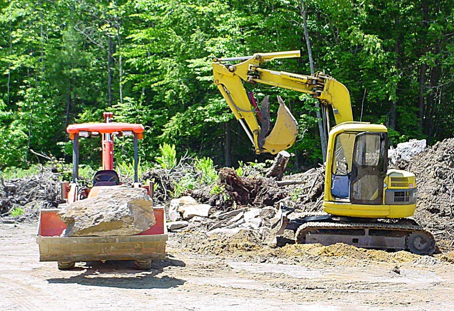

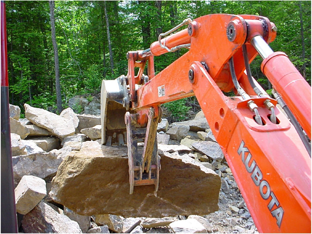

Mike,
Looks like quite a trench. How long is it and how long did it take to dig? I dug a 500 foot trench 4 ft. deep last year for electric. Took me most of a month with the L39 with some time off for rain delay. Always exciting digging in Vermont soils. I've been using the rocks I removed for stone walls.
I have a 24" bucket on the Komatsu and in deference to NH rock, an 18" on the L39.
Trench is 4' deep x 225' or so. A pro could have done it in two hours.
I started at 7:40 PM and finsihed at 11:05 PM working with the boom light, so 3-1/2 hours.
It took over 2 hours to pressure wash an dig out the 1 yard of mud in the undercarrage Sunday afternoon. I looked like a mud baby. She needs a greasing bad.
I fiqure except for the larger rocks which I would have had to dig around with the Kubota, the Kubota could have done it in 10-12 hours. Maybe my estimate is low, because you can spend 2 hours on a larger rock or stump.
The L39 hoe is nicely matched for the machine, but the controls are more fatiguing in the L39.
It may be a blessing you did not buy the 11,000 lb machine, as if I were to do it over again I'd be looking at something in the 11-14 ton range.

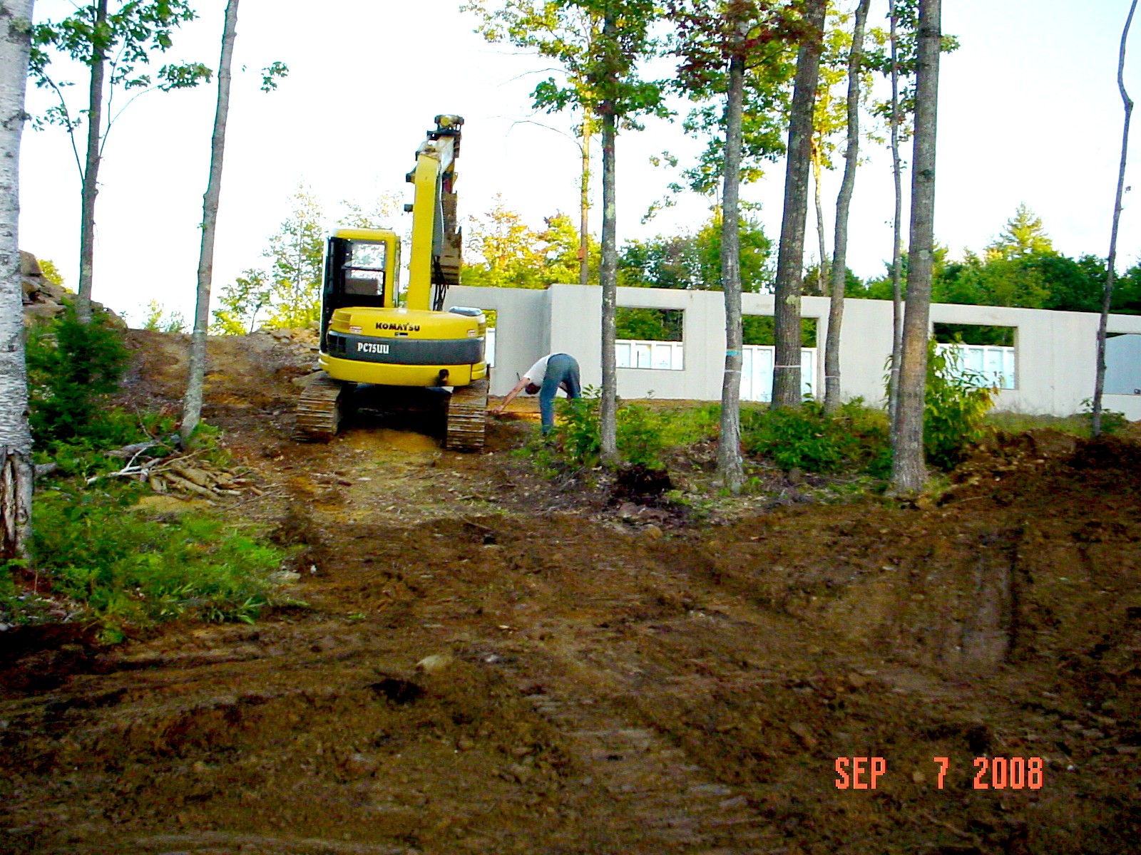

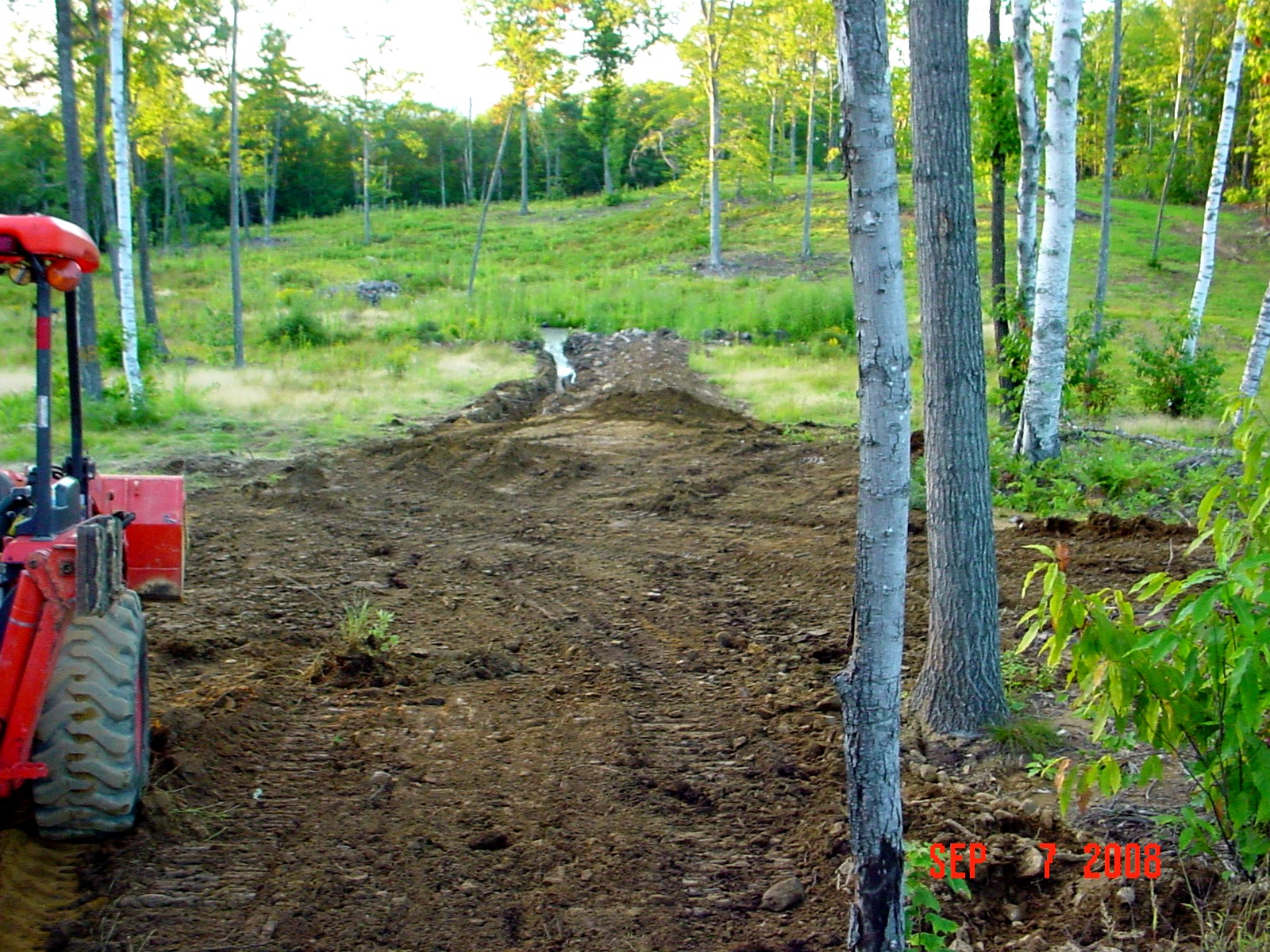

The nice part of having an excavator that has a thumb and bade provided the machine is operational is the machine is quite versatile. I've been flat out with other stuff going on to play in the dirt much, but in a day I laid the pipe and backfilled about 60 . I used the thumb to load the excess rocks into the L39's bucket. I used the L39 to cover the pipe with sand and fill the trench about half way. I then used the dozer blade on the excavator to backfill and grade the rest.
The excavator pushes dirt much better than the L39.
