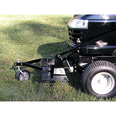

Sorry to resurrect an old thread,
but Sears item# 07124312000 Mfr. model# 24312
can be made to work in the front of the BX2200. You may have to torch a bit of plate stock. Bolt the plate to the BX, and the dethacher to the plate.
I did not use the lifting rod yet, because my brother had my welder, and the rod needs to be extended. Instead, I ran a rope over my front end loader boom cross piece, and attached it to the front wheel mount of the dethacher.
I Pull on the rope to lift. Sometimes I tie off the rope, and raise the boom to lift.
I have used it five or six times already. The hardest time was when I was trying to scratch red clay to cover grass seed. It held up fine.
When considering how to attach, remember...any force comes from pushing it. Your mount can be quite simple. Once your plate is attached, unit goes on/off in seconds.
I bought mine 10/29/07 for $136 delivered.
