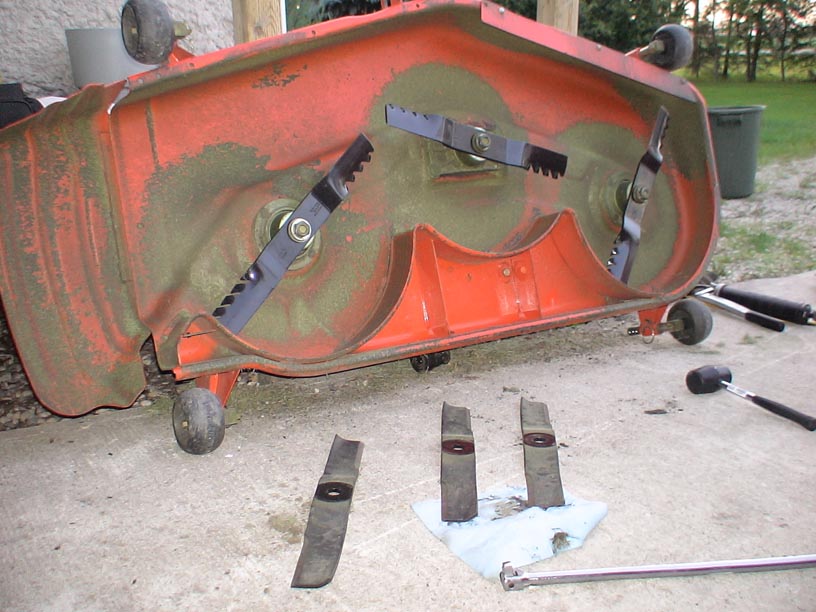

If you have never had Gators, they are the Cat's Pajamas of mower blades. :D As Gator doesn't make them for the BX series, it has been years since I have been able to use them and they are really top notch performers. By request, Vofandt sent me this link to the procedure he used to adapt them for his machine. And many thanks to Volandt for the detailed instructions.It starts at post #72
Here is a pic of mine installed.

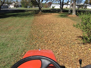

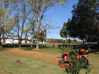

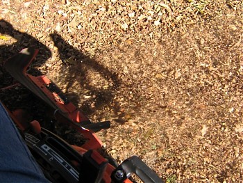

Heres a few pics I took when mulching up the leaves just before I hooked up the cyclone rake to pick them up. The last pic is supposed to be a shot of the fine particals of leaves being discharged but the shutter speed really wasn't fast enough to show it good enough to make them out. But if one looks hard enough you can make out how small the clippings are that are just past the chute as compared to the large uncut leaves in the next uncut row.
I still recommend them for side discharge and bagging, but since I've not tried them with a mulching kit I'll have to leave that assessment up to those that have.
