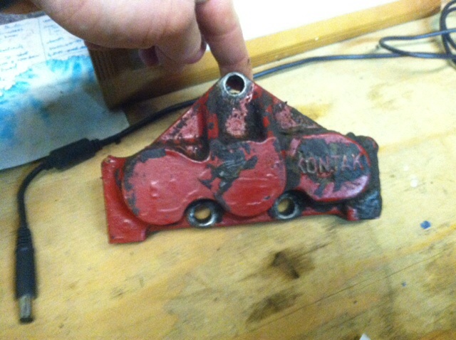

So step 1 was to locate a power beyond end plate for my Kontak valve. Here is the original end plate with no power beyond part.
Luckily Case-IH parts diagrams show the optional power beyond plate. So start web surfing. The only place on the continent that apparently had one of these was a salvage yard in Canada. So I order it, shows up 5 days later, and think things are downhill from here.

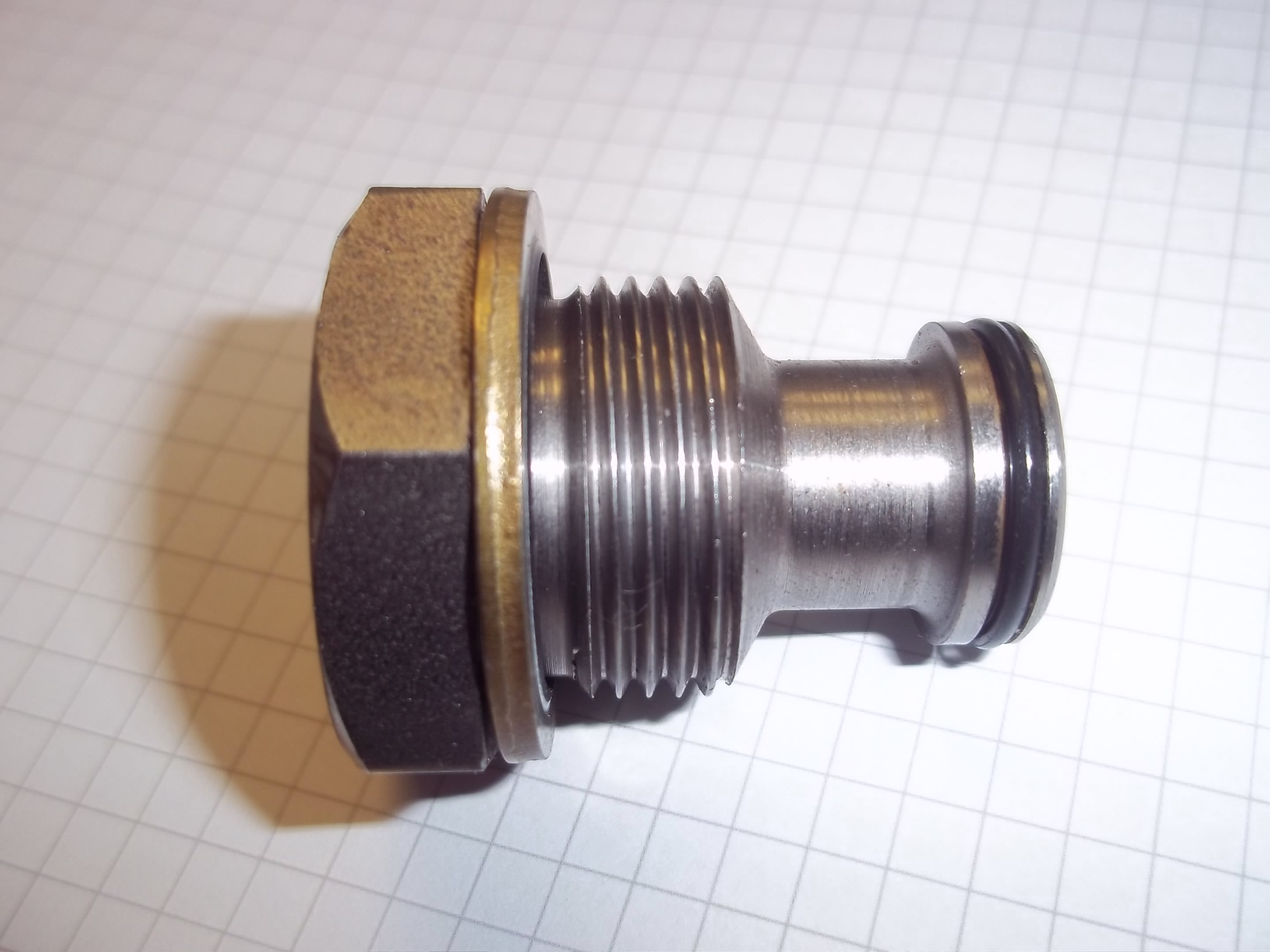

Well I scratch my head while looking at this new end plate and something's missing. This has got to be a power beyond plug (pressure carry over adapter as Kontak calls it) for the end plate. Something has got to block the high pressure fluid front going back down the tank return internal cavities of the end plate. I look on Case-IH parts and nothing. It lists an adapter but it's unclear whether that adapter is the pressure carry over adapter or the 3/4 BSP fitting to fit to the end plate. Googling the "adapter" part number returns nothing. So I post a plea for help on 3 different forums including this one. No one knows what I'm talking about or has a lead. So I start to poke around for Kontak valve parts-these are really tough to find by the way which surprises me. My tractor and Case-IH loader both have Kontak valves. Searching for "pressure carry over adapter" leads me to a place in UK. I ping them and the guy I talked to was really helpful and pointed me towards this (I highly recommend P&R Hydraulics Limited in UK).
For about $30 I order this adapter and it shows up like 3 weekdays later (someone tell me how Royal air delivered items show up in about 1/2 the time that USPS takes for shipping something in this country). This adapter mates to the 3/4BSP in the end plate and reduced down to 1/2BSP. So now I can get to work.
