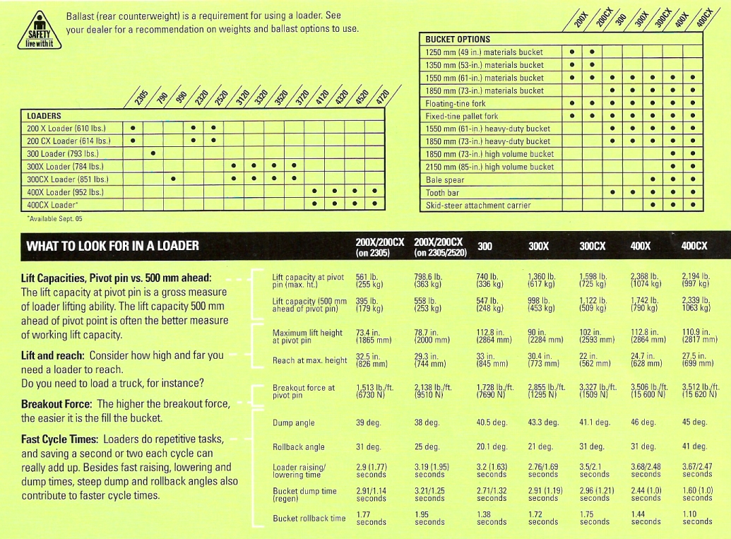

Unless you find aftermarket cylinders, price is going to be the problem here. One 300x lift cylinder is $500. I would guess that a 300 might be worth a similar amount as a 300X if you have the time to find a used one. I'd also recommend going straight to a CX while your at it. But if the 300 works for you then don't worry about it.
300 lift cyl piston diameter 1.568"
300X 1.770"
300CX 1.962"
