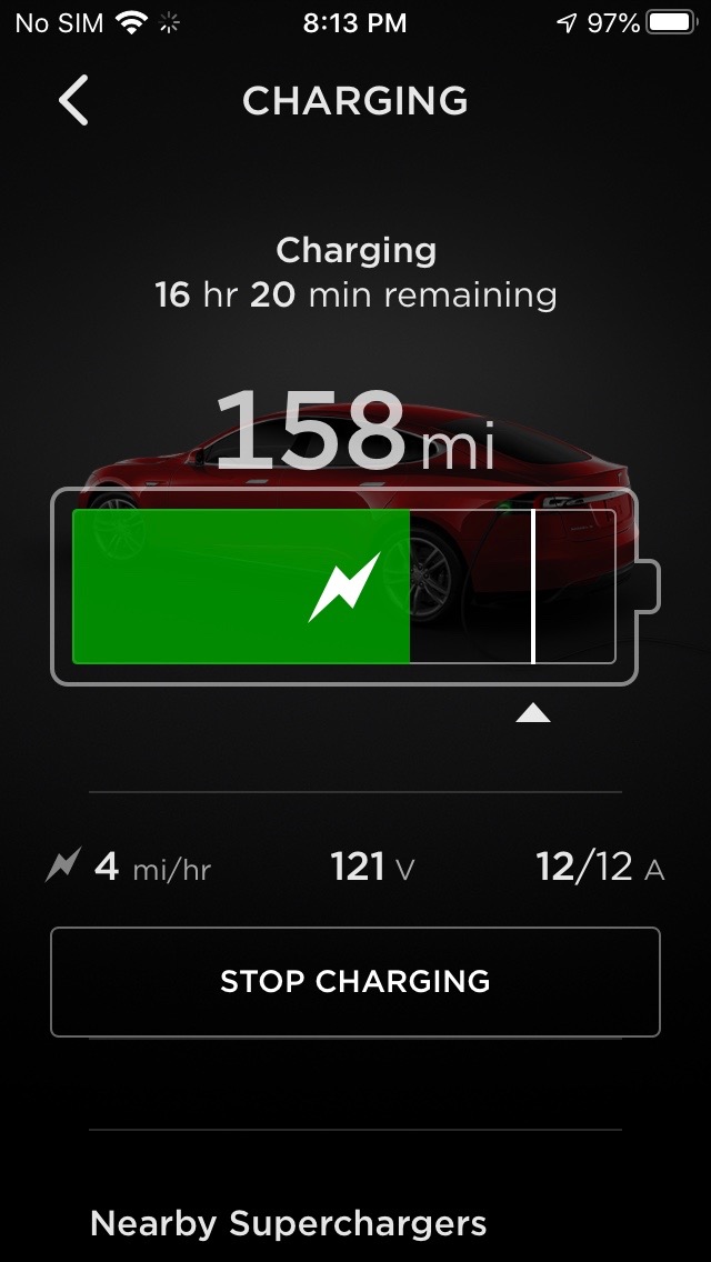

Can you charge with just a regular extension cord from a 110 volt outlet. I always assumed you can’t but don’t know.
   / TESLA Electric Truck? #488
Yes but it charges slowly. See attached. In the picture the charge limit is set to about 215 miles, currently 158, yet estimates another 16 hours remain to reach 215. On 240VAC @ 40A it would be charging 29 MPH, not the 4 MPH shown. Screenshot of the Tesla app while my car charges.
