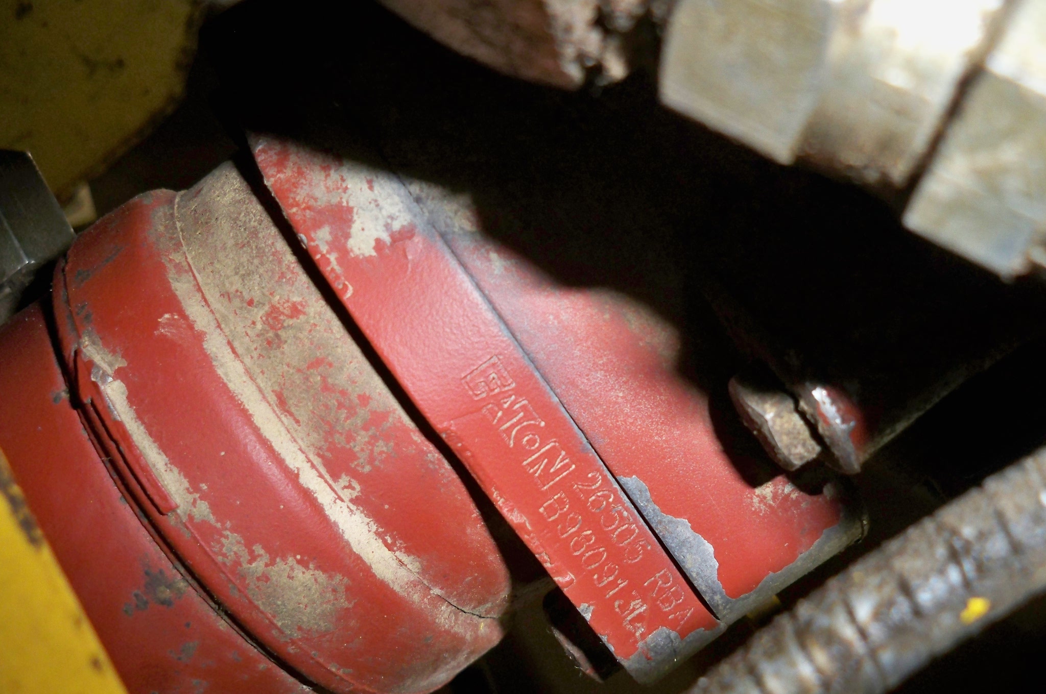

Tested the pump. Its bad. Its the Eaton pump. Anyone know of a good/cheap place to rebuild it. Has anyone ever figured out which pump that is actually is?
/ Terramite T5B won't move. #9
Look for numbers stamped on the flange. Then google those numbers and you should be able to find a manual for it on the Eaton website. Mine is a T6 with 4 wheel drive so it's a little different than yours. Here's a pic of the stamping on mine.

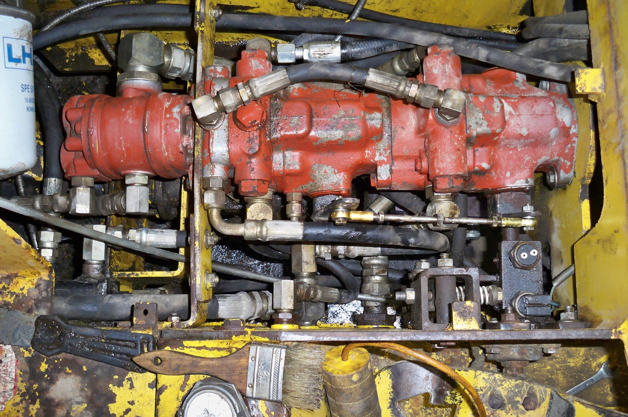

Here's what a 4 wheel drive setup looks like. The short hose right on top is supplying charge pressure from the rear pump to the front. The charge pump supplies relatively low pressure oil to the piston pump so it doesn't have to suck it up. If your charge pump is not supplying enough oil to the piston pump it can't work right and probably will make a lot of noise.

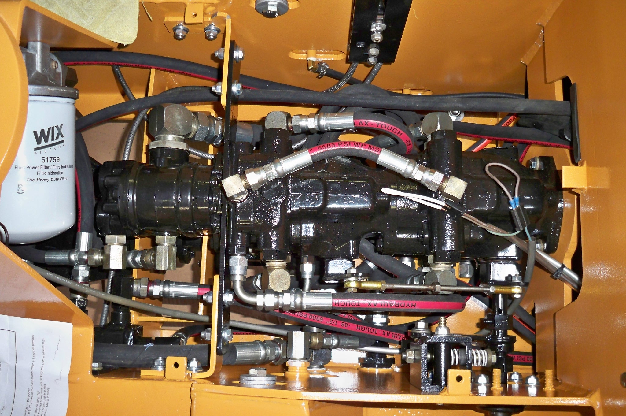

Here's one of things cleaned up a bit and new hoses. 10 pounds of S*** in a 5 pound box.

SO I found the #'s and the best route Ive found is a repair at Legacy Hydraulics. Anyone ever used them? They said $100-1100 to repair depending on what it needs.
The cheapest replacement I've found is $1600 and is local to me in Memphis.
Terry wanted $1900.
Eaton 70142-LBF
