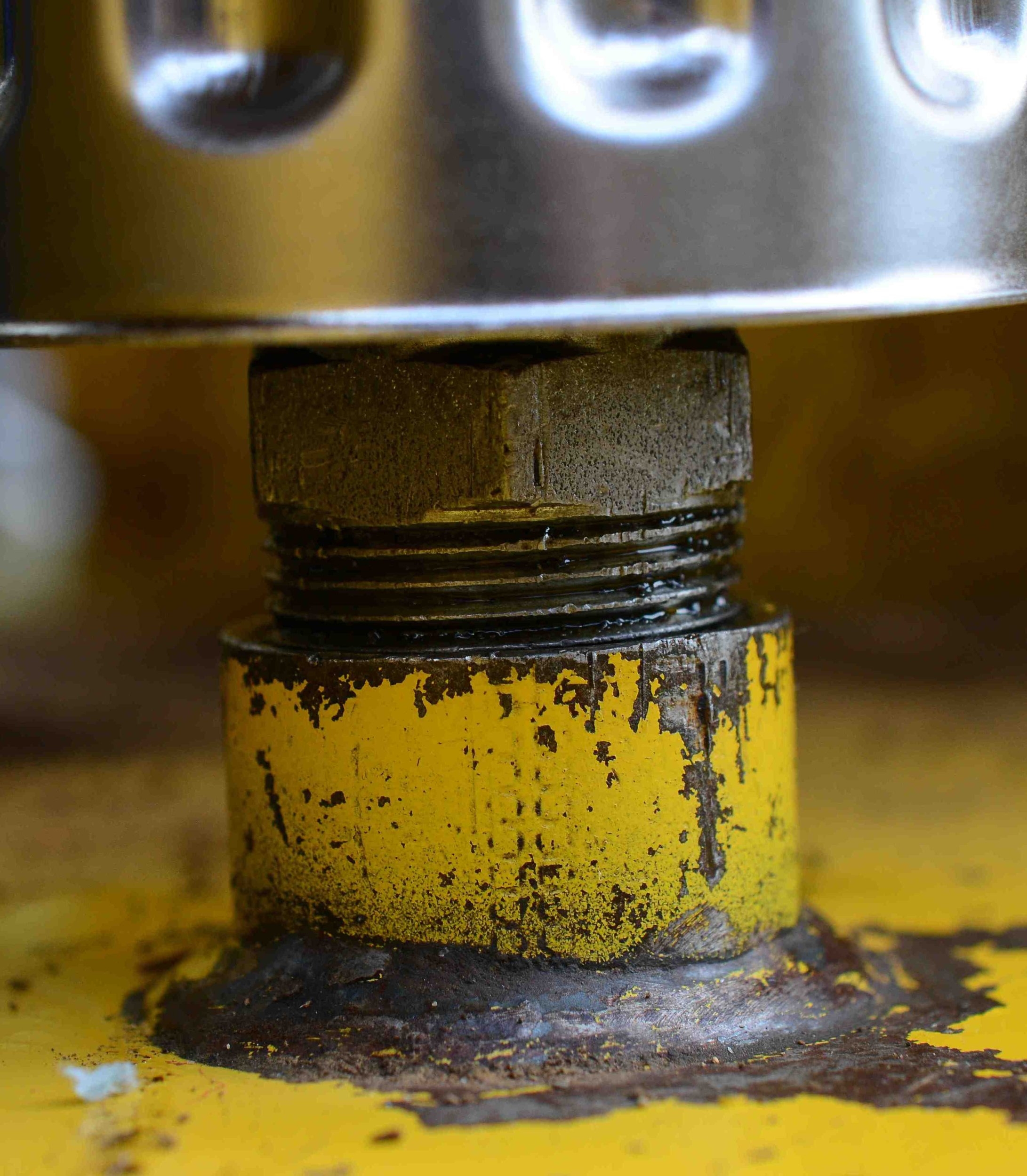

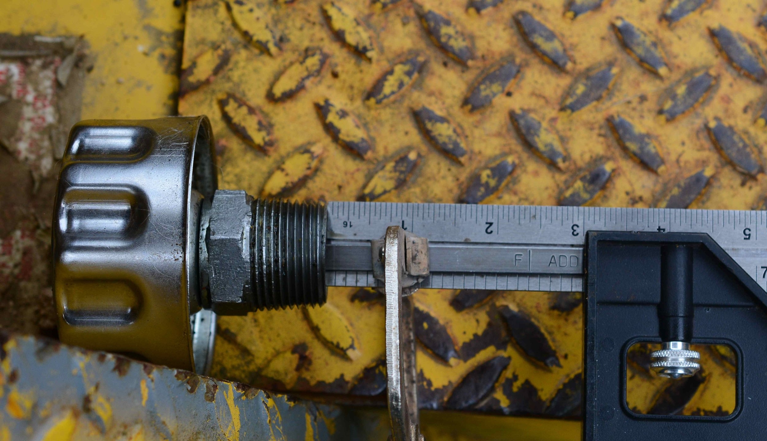

Terramite t5c
I have a Terramite T5c and the hydraulic tank cap does not have a dipstick on it (it was broken off at some time) . Does anybody know how many inches of hydraulic oil should be in the tank at full or have a measurement from the bottom of the threads on the filler cap to any of the markings on the stick so that I can check for the correct amount of oil in tank

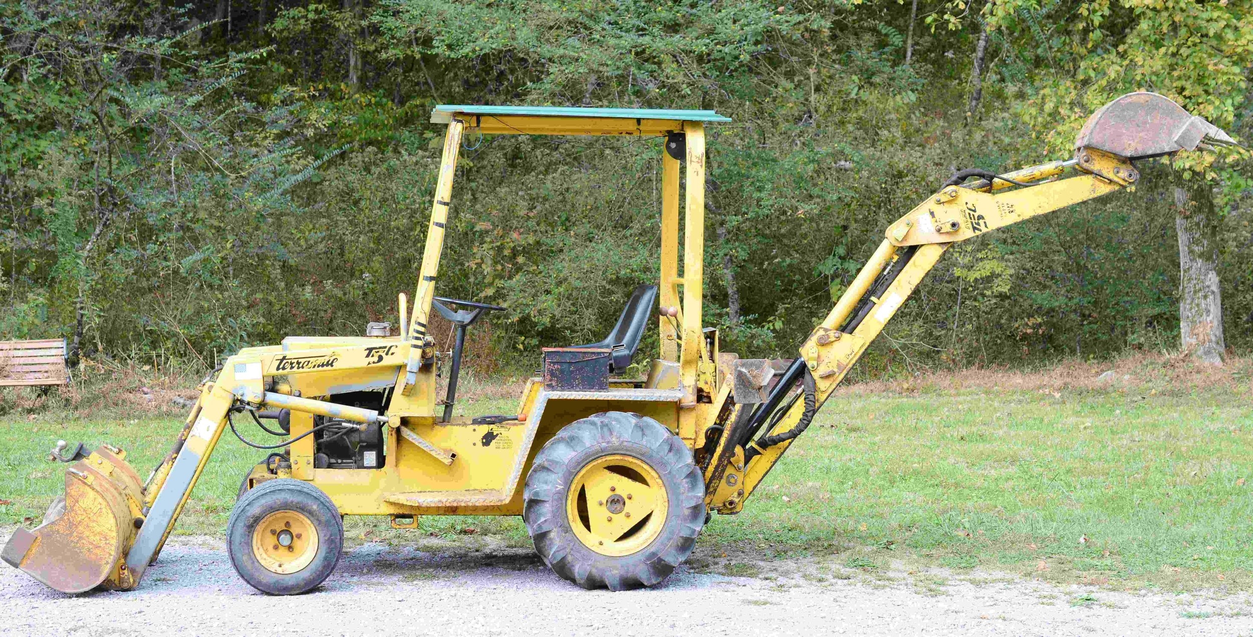

/ Terramite hydraulic fluid level #4
This is the tank cap from my T5C. The dipstick extends about 3 inches from the bottom of the thread (pic 1). Positioning the square beginning with the thread when screwed into the tank gives you picture 2. Picture 3 shows the number of exposed threads when the dipstick is fully screwed into the tank.
I'm sure you already know that the system uses 15w-40 engine oil, not hydraulic fluid, and that the tractor hydraulics need to be in the positions shown in picture 4 when measuring the proper oil level.
Perhaps you can still buy these tank caps at a couple of places that specialize in Terramite parts?
