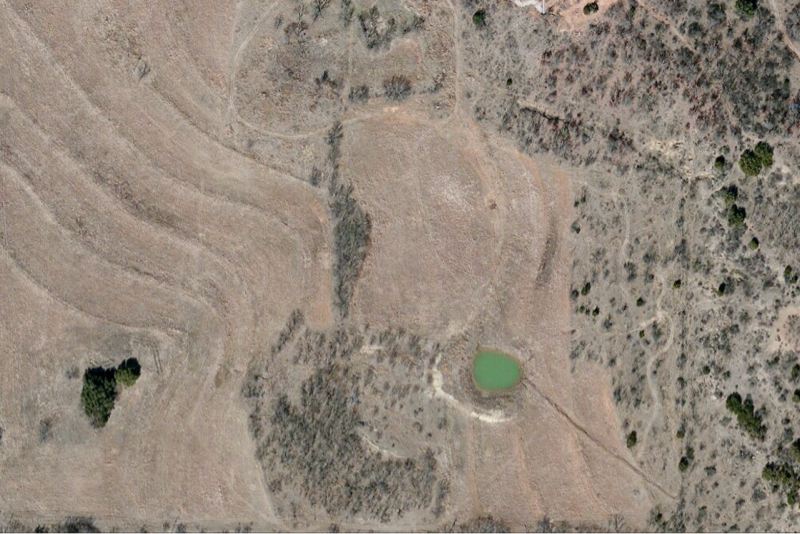

Got terraces too. Can someone explain what purpose they serve(d) and benefits?

Helps keep your topsoil from washing away.

Terrrace's were designed to control the soil on cultivated land for crops where as grass roots tend to keep soil from washing.

I grew up with terraces. Terraces can actually give you more land area. As mentioned they were designed to cut down on soil erosion. Management wise, you usually you have to work with them following the curves. I can imagine that big equipment would have problems. We did the math on our pretty steep slopes after terracing and it can be up to a third more area than the orginal slope. We graze them, and the grass grows well on leveled areas, and also on the steep slopes of the berms that form the terraces. We could never bale them.

Terraces are specifically designed to capture rain water so it penetrates the soil, reduces or eliminates soil erosion, and increases your crop yield...... Do not level them.... The farmers of yesterday knew what they were doing.....
Terraces were designed to control soil erosion in cultivated crops not capture water. Correctly constructed terraces funnel water to a designed grass sodded water way so excess water can leave the field.
/ Terraced Hay Pasture #14
Stupid ME !!!! :mur:
