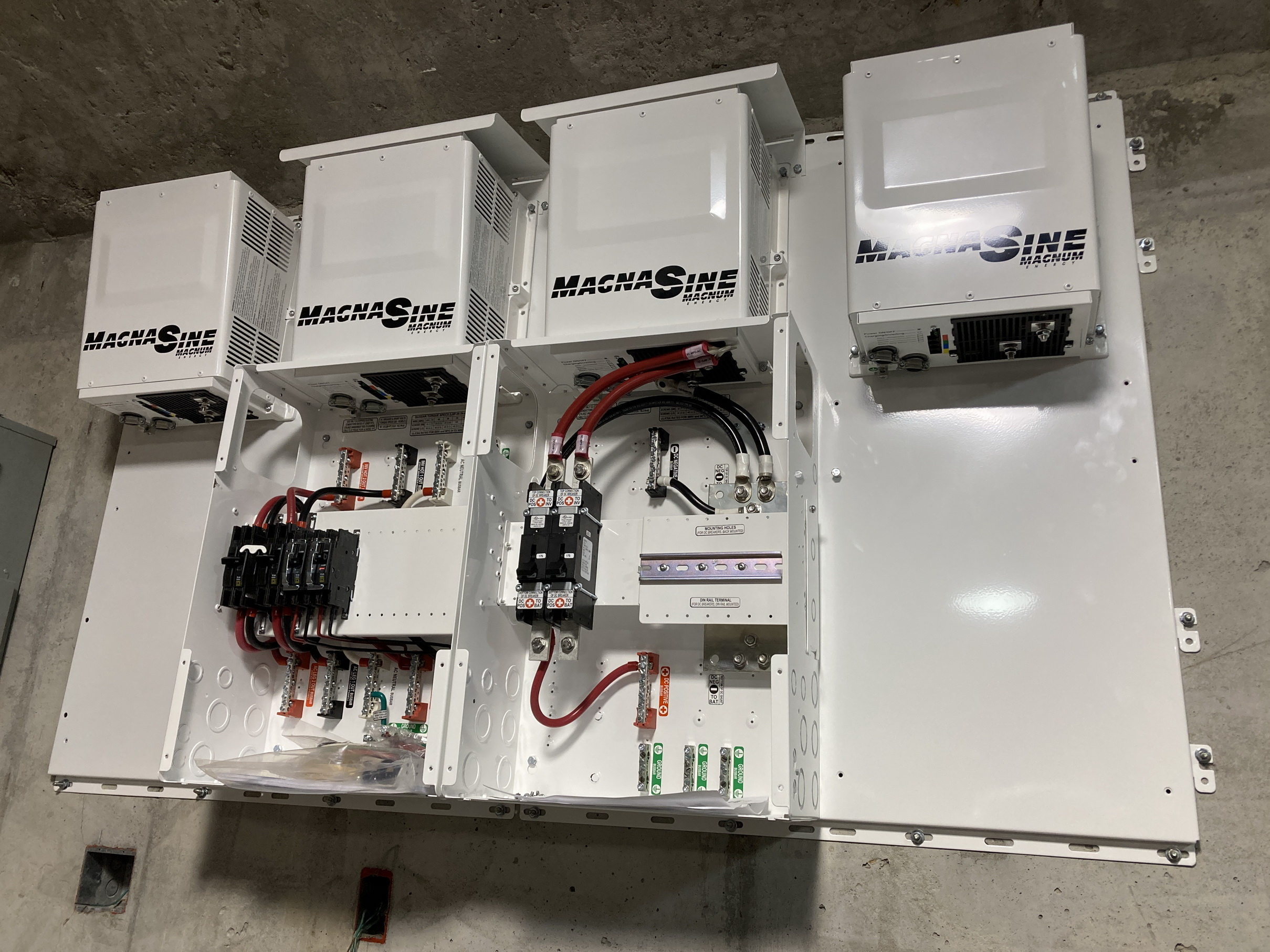

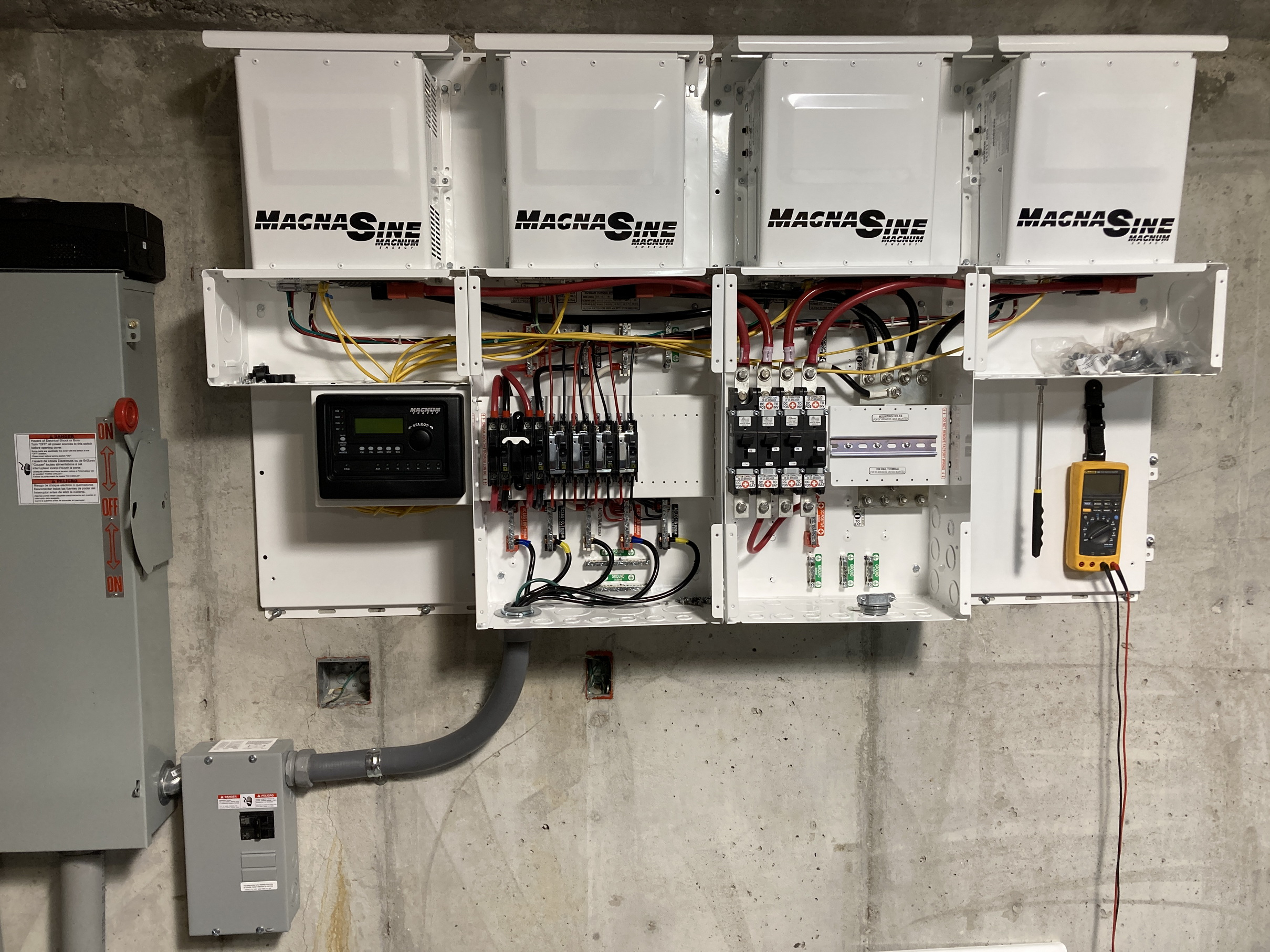

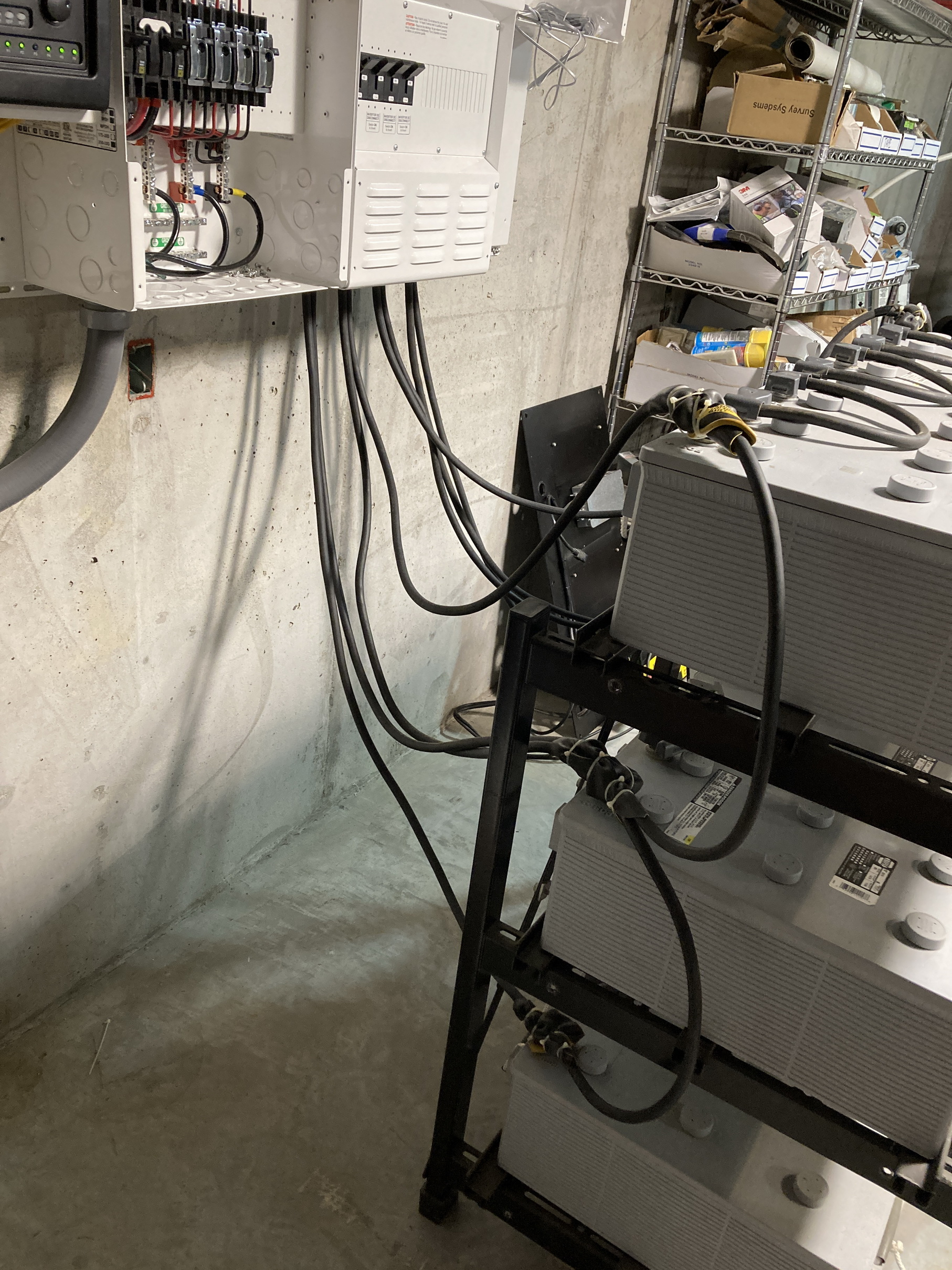

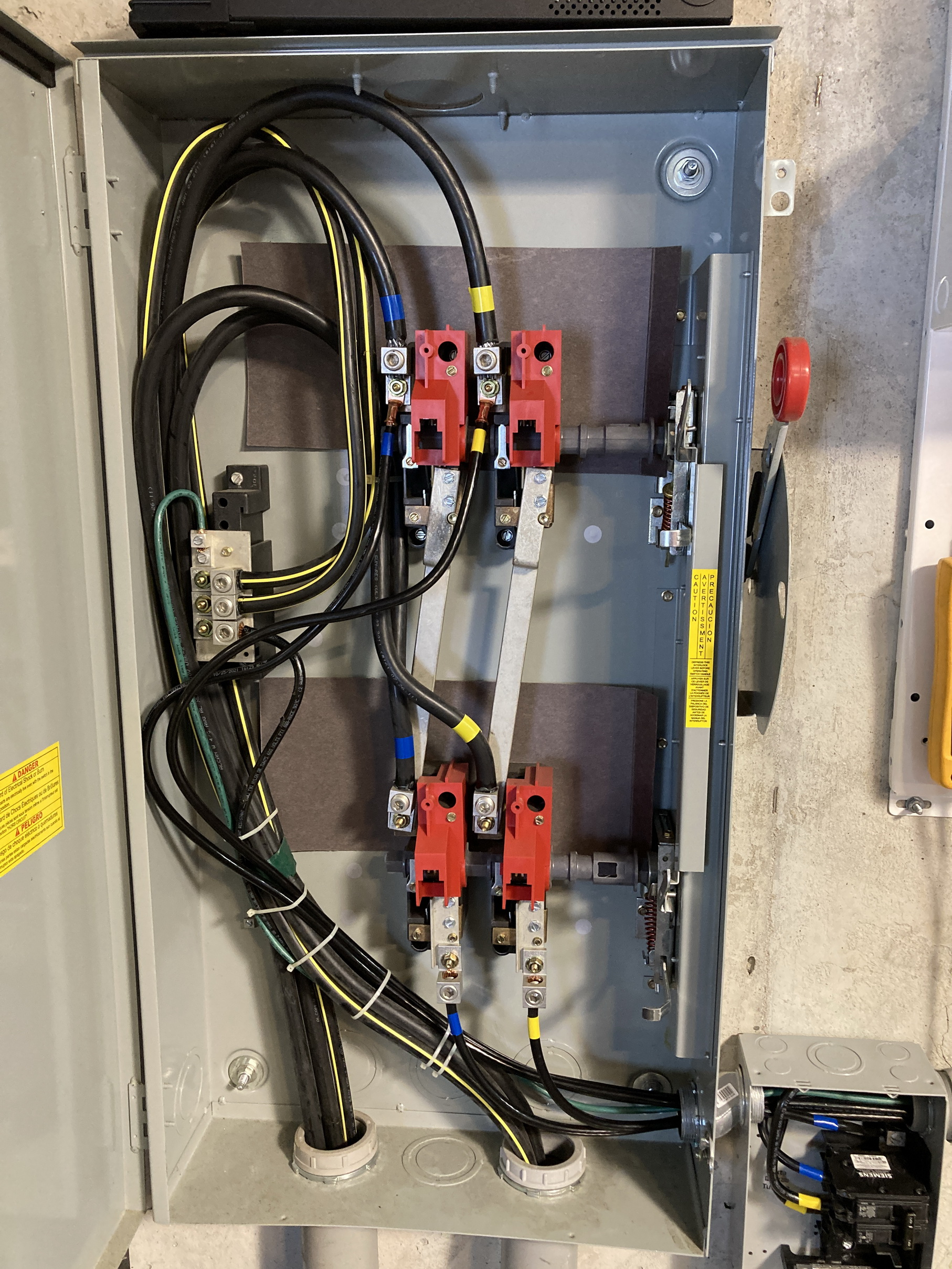

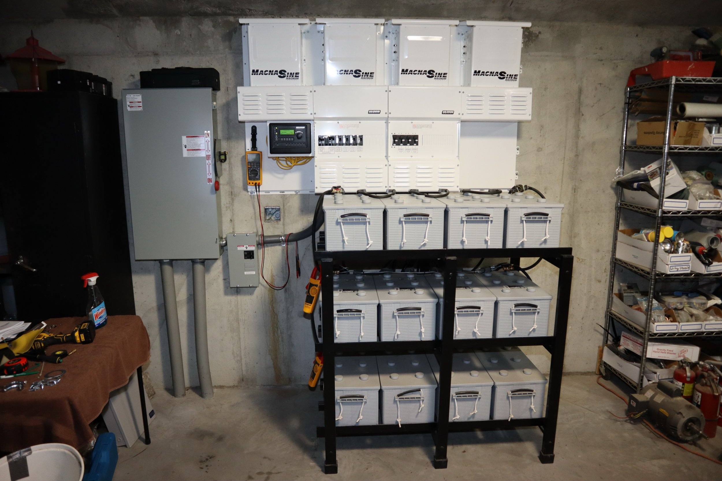

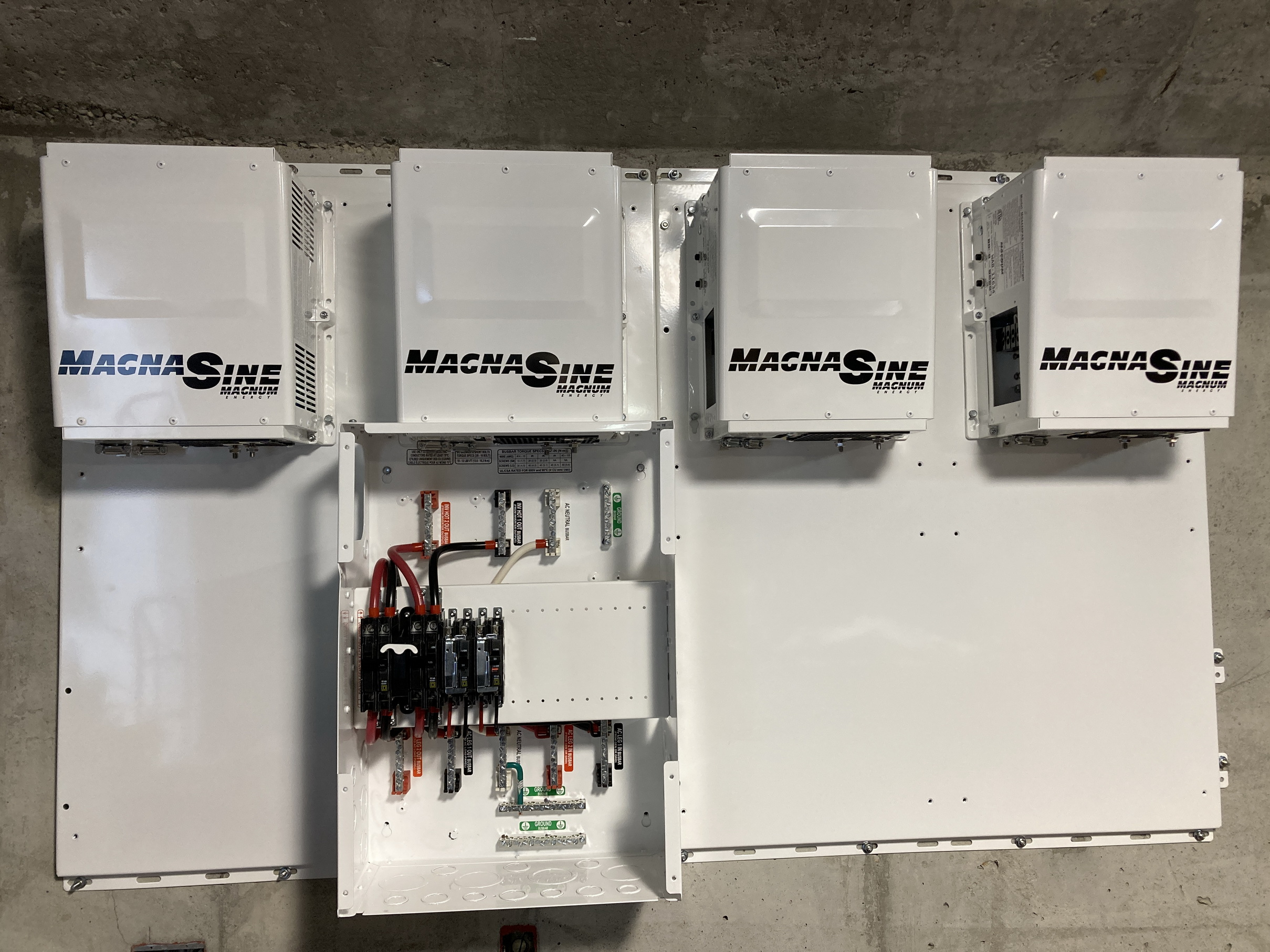

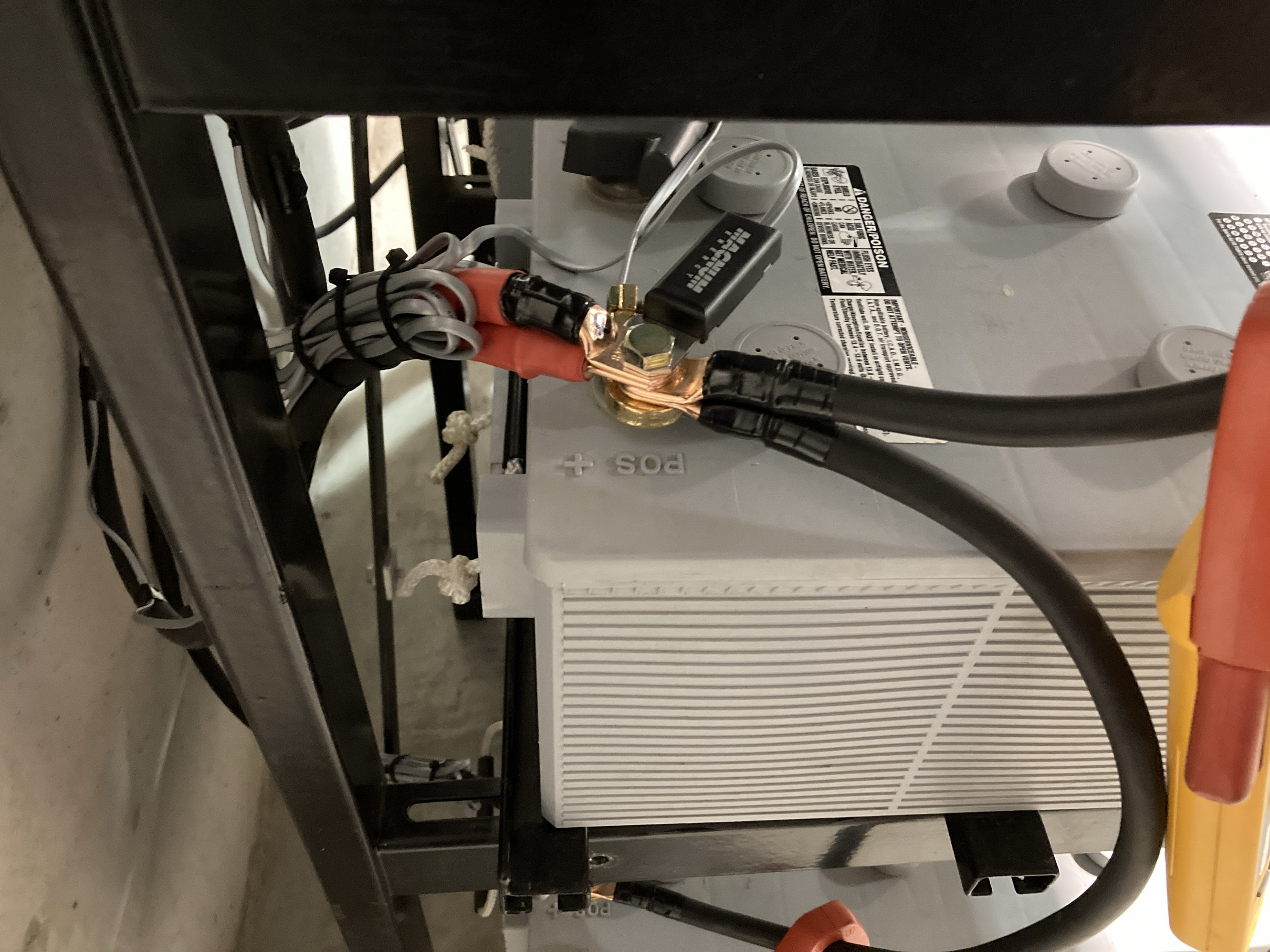

So we made the move to be off grid for electric. We purchased much of the system a few years back, but we are much closer now. Our system can produce 17600 watts continuous power at 240 volts or 120 volts. Find parts can be a challenge so get it while you can.
Thats awsome!! how do you like dome living? Hope all is well!!!
   / Terra-Dome Earth Shelter Build #976
Love those inverters and batteries. Congratulations! I'm sure this has been and will be alot of work. But work that is worthwhile and brings happiness!
