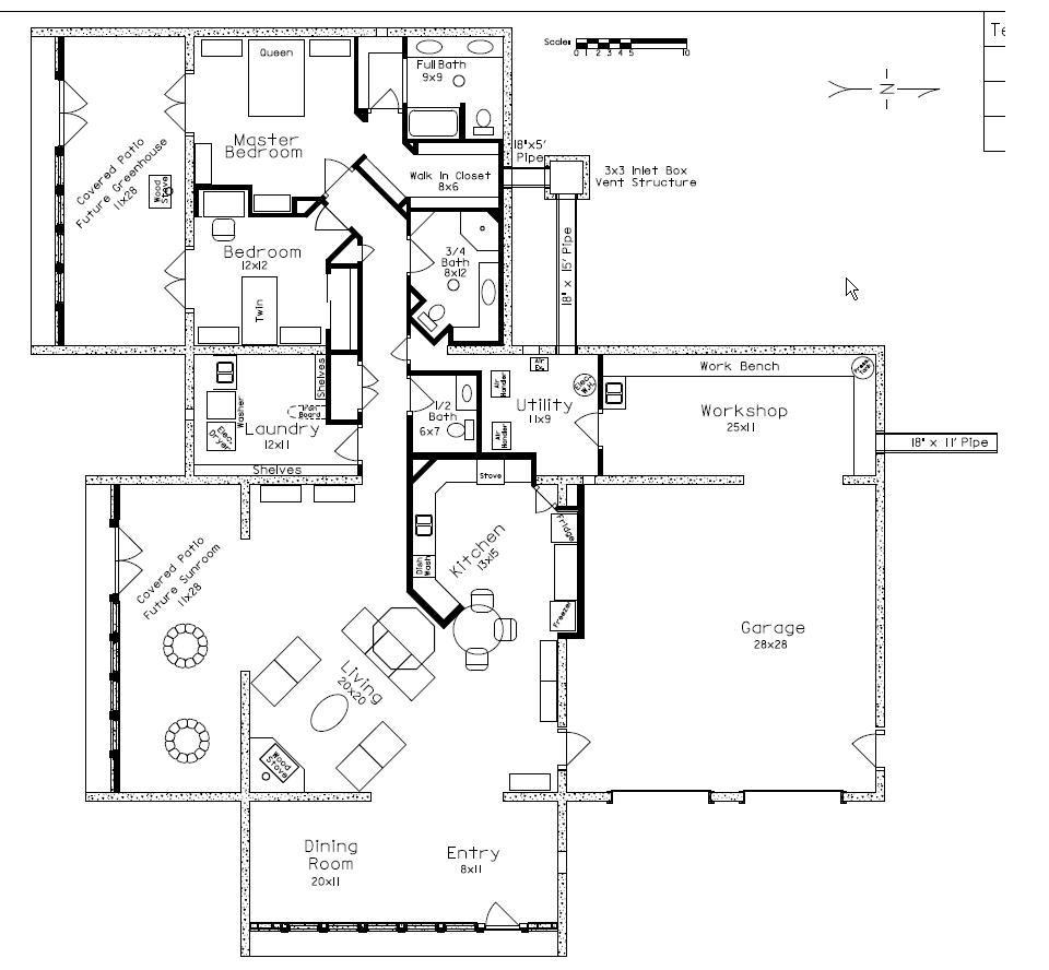

I'm just scratching the surface. Over the last month I've had a 1,000' driveway slashed into my property in
the Missouri Ozarks. Site pad clearing and grading is the next step.
Attached is a pic of the general layout of my floor plan. Three 28x28 modules. Three half-modules, and a
11'x60-ish "box". A future separate module may be added later on to provide an additional two-car garage
and storage for a tractor, skid steer loader, and other assorted farm-related goodies. But I'll have to see how
our money stockpile holds out before I sink another $30K into the build.

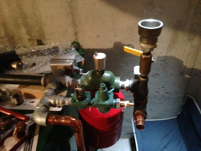

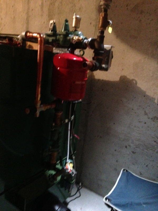

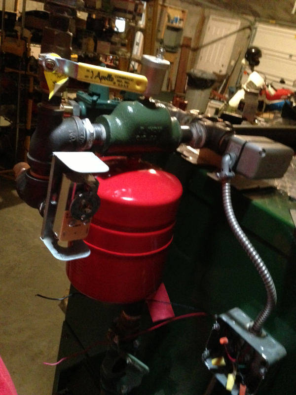

I was planning on installing a Goodman heat pump but because they didn't provide the discount I have started installing the Green Wood boiler
