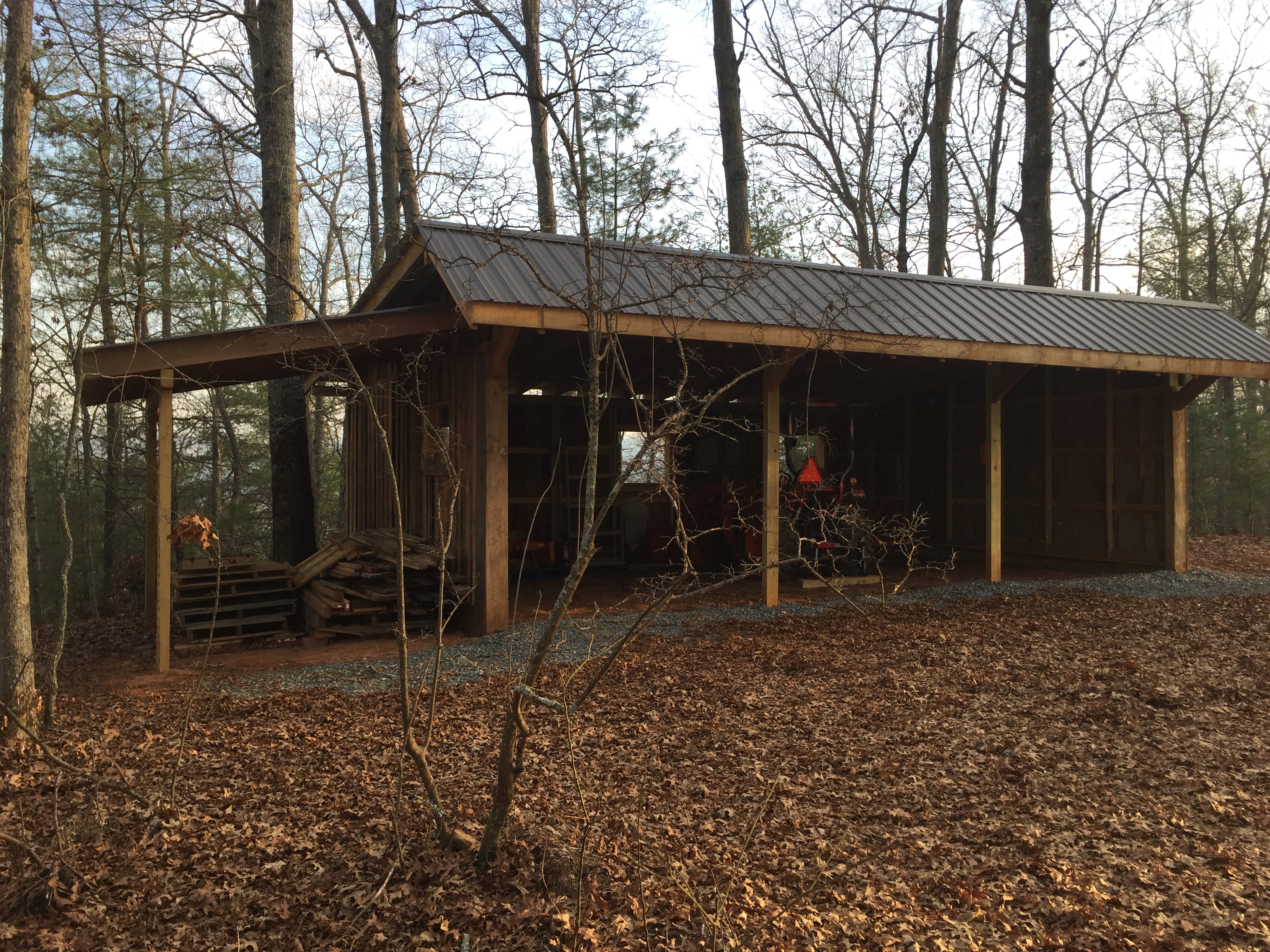

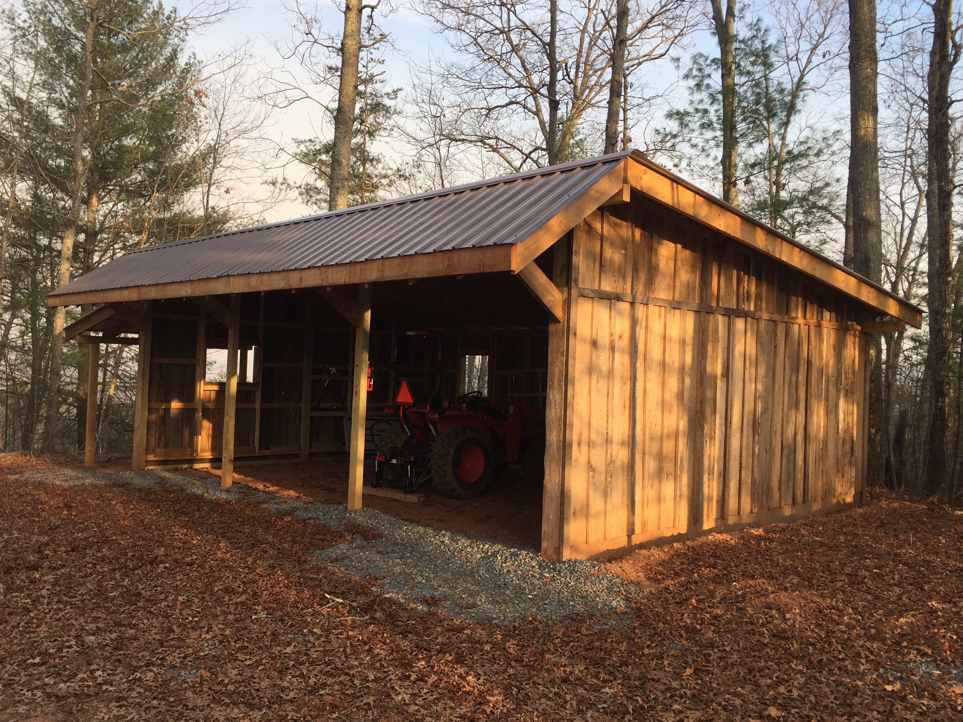

we built this in a couple of days for a couple thousand in materials
Very nice. Looks to be the perfect size. Lumber prices in Alaska are so outrageous that you can't afford to build anything. Our local sawmill closed its doors a few years ago so the nearest mill is 130 miles away.

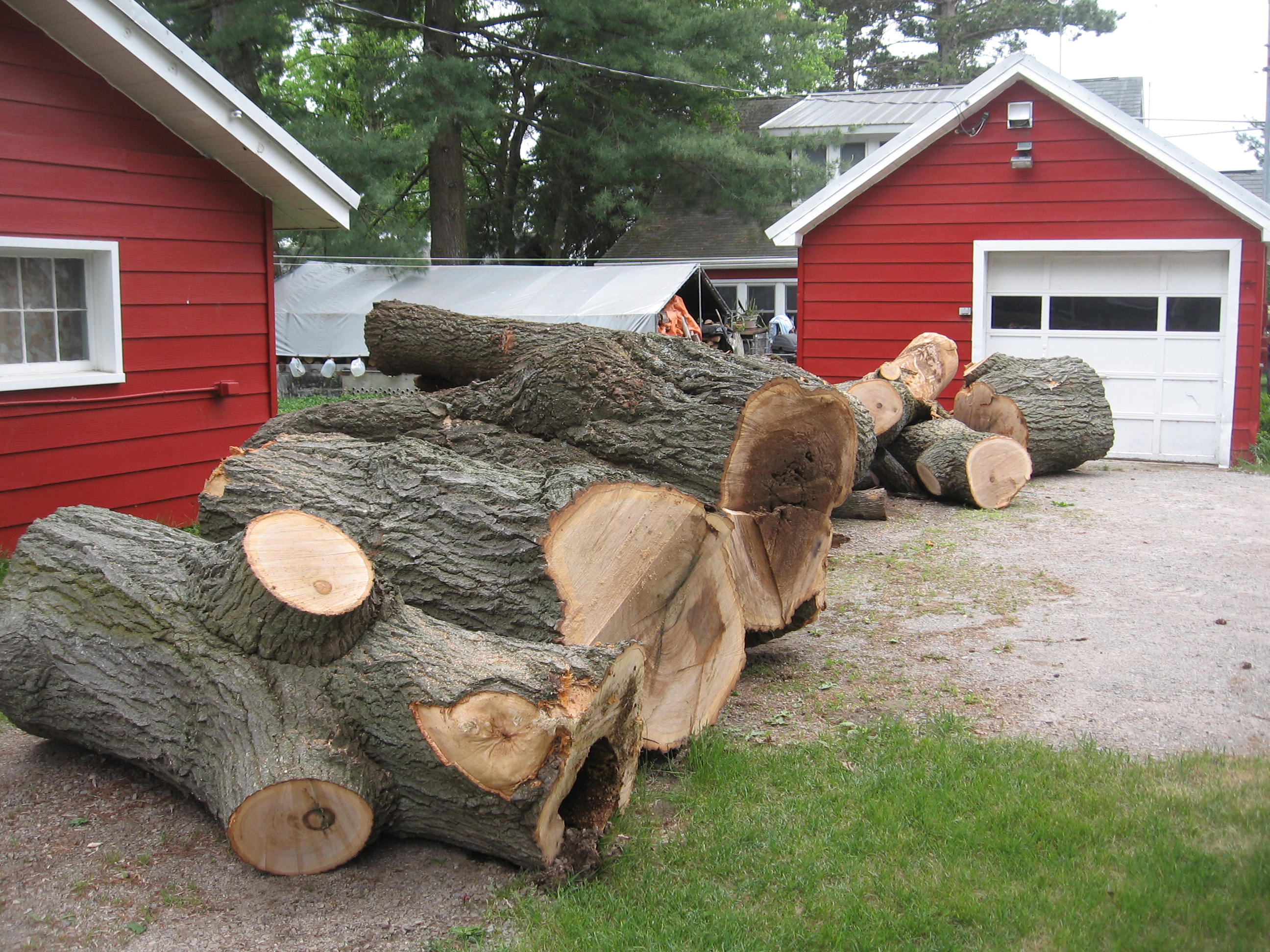

I have something similar to the ShelterLogic type, but the pitch is much flatter, like 1ft in 12 ft. 10ft span between posts and rafters.(all 1" galvanized conduit.) I added 3/4" pvc pipe between top plates and bowed them up to the ridge pipe. This puffs the tarp up. Helps with rain and some light snow in northern Michigan. BUT I do clean the snow off on a regular basis in the winter. This covers my wood pile. Jon
Not the best picture, though this picture shows the canopy I was describing above. It is 20 ft long, approx 14 ft wide. I used a 20 ft x 20ft tarp. You can make out the extra pvc pipe puffing out the tarp between the posts. Side posts were only 5 ft tall and the center post maybe 8ft.
