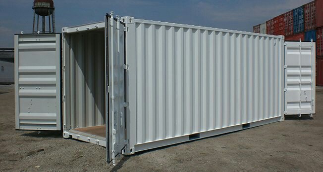

   / Tent Storage Structure for Attachments #10
