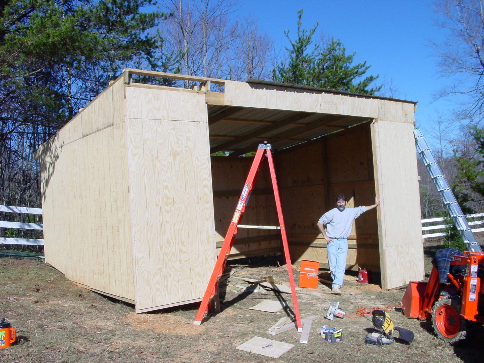

For your temp shelter, I will not comment on use, or what is best....
Go to your local lumber company.
Buy some 4x4 pressure treated posts, T-111, and lots of 2X4's. Build everything to the dimension of the T-111 4X8 sheet. Go twelve feet high in the back and sixteen high in the front. For a roof, here is where the money is. Get a good metal material.
I have built six or seven, I lost count of these type of run-in's over the years. Simple, inexpensice and easy to deconstruct. I actually moved one, the rest, last I checked were still standing.
Anywhere near the ground, I used pressure treated wood. A post-hole digger, hammer, nails, tape-measure, saw and level was all I used. Built them right out in the field. Mostly, me, myself and I. For the run-in, I went 16' deep and 24' wide.
16' high!!! You must have some HUGE horses... I've never seen a run in shed higher than maybe 9' in the front and 8' in the back (I think).
I would VERY MUCH appreciate pictures.
Thank you!
David
Who says only the horses use them? :) When I get tired, the CUTS don't make it back home. :)
Serious - Horse do rear up.

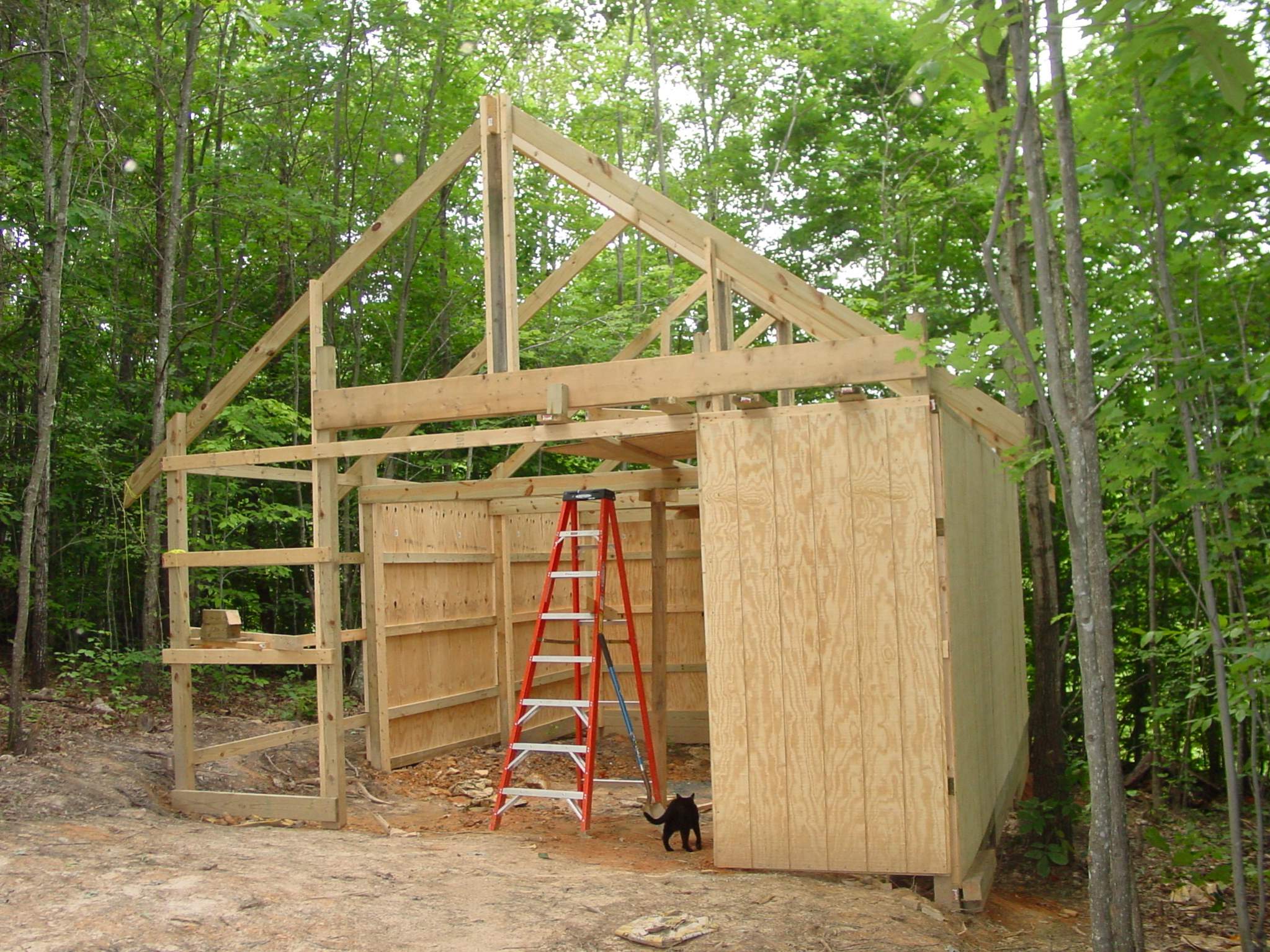

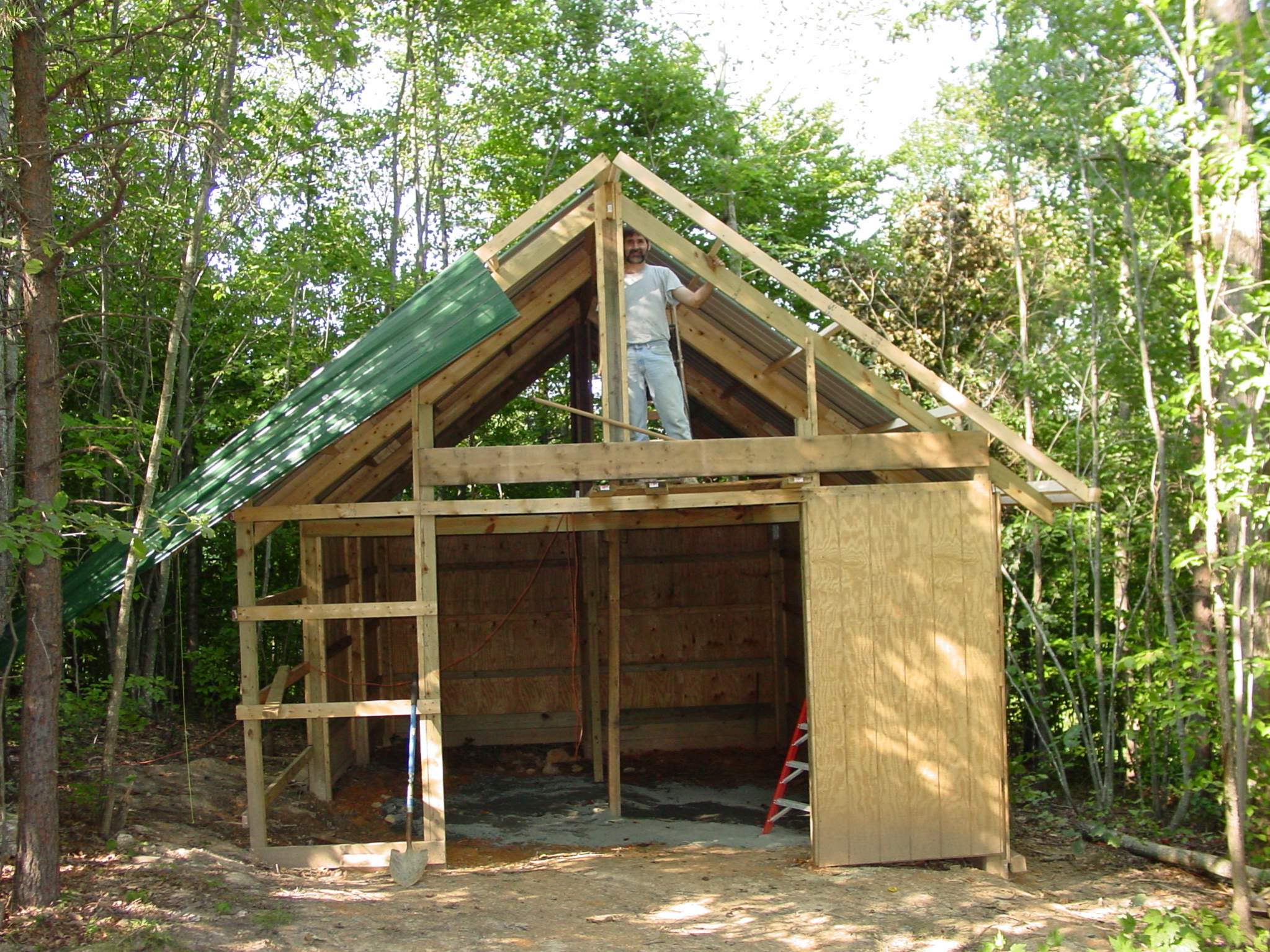

   / "Temporary" Run-in shed for my horses #29
Equipment shed.
Horse run in.
Construction is the same.

Yes they do...
Another reason for a higher roof is you might need to get your tractor inside.
Higher roofs are also cooler down at horse and human level.
