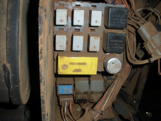

My owner manual does not ID the relays. From the schematic, I am pretty sure the gray relays are not the timer; they appear to be Neutral start, PTO safety start, ect. The yellow one appears to be for the turn signals.
I'm guessing it is one of those at the bottom of the picture. One is partially obscured by the wire harness.

It's the blue topped one in the lower left of your picture that says "NGK Lamp Timer." Look closely and you'll see it has a special New Holland part number. Don't even bother trying to find a replacement. It probably exists, but is hidden in secrecy so you are stuck paying "full fare.":(

Online the timer is $67. I'll have my local guy order it(probably same price, but has been real good to deal with on the old Farmall I used to have, and my old Kubota).

Robert, I looked at the circuit and there is a simple jumper you can do to get the tractor started if you want. The glow plug TIMER just supplies a ground to the coil of the glow plug POWER relay. With the plug removed from the TIMER, jumper pin 3 to pin 6 in the plug and you'll get glow plugs ON. Hold this for 5 or 6 seconds, remove jumper, and then quickly hit the ignition switch and I'll bet it will fire right off. This is a low current circuit, so a tiny little jumper wire will work fine.
Edit: If you look into the back of the plug, pins 3 and 6 are the pins where the black and brown wires attach. The orange and white wires are power to the timer.
