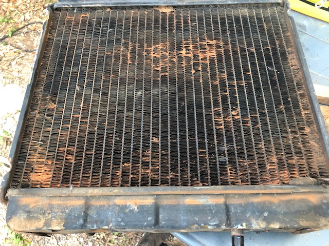

So I finally had time to get the radiator removed, it was a pain but it's out and yeah it was DIRTY. Here are a couple of pics. Blew it out from the back first with air then the other way then noticed there was still stuff in it so I took the hose with a nozzle that did not put too much pressure on the fins and rinsed from both sides again starting on the engine side lots od\f nasty stuff came out then blew it out again with air. Then finally took the nozzle off and ran the hose in the top and it would flow as much as the hose could put out. So tomorrow maybe I will try to put it back in, that should be fun....
I collected a bit of dirt on my arm that held the air nozzle

Forgot to put up the picture after the cleaning was done... Start on putting it back together and that appears to be tougher than the disassembly was.

Is that rust I'm seeing in your first pics of the radiator?
Have you noticed any coolant loss?
I suspect it might be an issue of a lack of pressure. Either the radiator is leaking and or perhaps the radiator cap is bad.
A partially stuck (not fully opening) thermostat can also be your issue. You cannot know unless you actually test it (if everything else rules out). ALWAYS test any new thermostat before installing to ensure you're not installing a defective new one.
Coolant passages in the radiator can also be partially blocked. Others have commented on this.

Is that rust I'm seeing in your first pics of the radiator? Nope just the Clay/Sandy soil we have here in Nawth Fla
Have you noticed any coolant loss? No loss of coolant
I suspect it might be an issue of a lack of pressure. Either the radiator is leaking and or perhaps the radiator cap is bad. Nope plenty of pressure in the radiator
A partially stuck (not fully opening) thermostat can also be your issue. You cannot know unless you actually test it (if everything else rules out). ALWAYS test any new thermostat before installing to ensure you're not installing a defective new one. Not fully opening thermostat could be part of the problem
Coolant passages in the radiator can also be partially blocked. Others have commented on this. As I stated in my post with the dirty radiator picture after cleaning it I ran water through it at full pressure from the hose and it did not back up, it flowed out of all three exit points at the bottom
There was a LOT of fine debris that came out from blowing and spraying with water from both sides, I can see through it MUCH better than before. So after I wrangle it back in I will post the temp numbers and hopefully they will be much lower than before.

You definitely found the problem!!!! With all that dirt caked into the fins, there was no way that it was going to cool anything!!!!

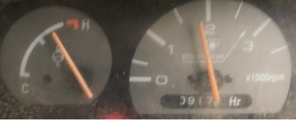

So finally got everything back together it was a PIA to get everything to fit back. I did not have my IR thermometer with me but think the gauge says it all.
Temp gauge after cleaning radiator.jpg this after almost an hour of mowing grass that was taller than normal.
Thanks to all who made suggestions on how to resolve this issue, external cleaning did the trick.
