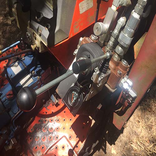

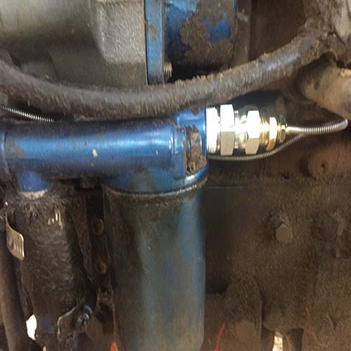

I upgraded the pump on my LK2554 to a 10 GPM pump from a 7 GPM pump. With the increase in flow, I became concerned that the hydraulic oil might overheat. The only way I had to keep a eye on it was touching one of the fittings. It would get hot enough that I could not hold my finger on the fitting. So, is that too hot? Who knows.
So, today I decided to figure out a way to put a gauge on it that I can watch for overheating. My first plan was to tee into the tank return line off of the valve. No hydraulic tee available in my small town. Then I found a plug in the side of the filter block and was able to get the fittings to install the probe.
Now I will have something to reference.

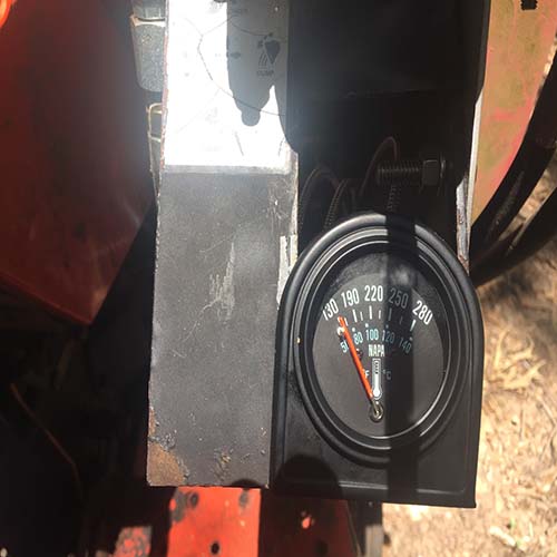

Well, either I have nothing to worry about or this is not a good place to have the probe. I ran the mower for about 1.5 hours this morning, working the grapple often the whole time, and the gauge never left the resting position of 130 degrees. I am not sure what to think. I wish I could have found a gauge that started around 80 degrees so I would at least know it is working.
Does anyone have an opinion or suggestion on how to this better? Or I am worried for nothing?

When I saw your photos yesterday I thought the adapters would keep the bulb out of the oil flow and make the gauge read cold. I still do.
/ Temp Gauge for Hydraulic Fluid
That swivel was the only way I could get to 1/2 NPT with what I could get local. I will see if I can find something tomorrow that will shorten things up.

Infrared hand held thermometer for 30 to 40 dollars are lowes. Can check any point you want to with one tool.

They are getting more popular these days HF has them on for 20 bucks from time to time. I have 2 and both work just fine. I was going to suggest the same as I use mine on everything. Really amazed at how cool things really run when you expect them to be sizzling hot.
As I recall at about 70C if you put your finger/hand on an object you have to immediately take it off. No burn involved, just uncomfortable enough to make you want to do it. That's 158F if I did my arithmetic correctly. For a benchmark, US domestic hot water heaters (of which I know) in the N position produce 140F water.
Fluid can get well over 230F before you have to start worrying about temp.

Thanks Rick for clearing that up. I thought for a second that I was loosing it.
Thanks everyone for your help. I will get a infrared thermometer to check things out. I still would like to get the gauge working if I can so I can monitor temps on a ongoing basis. My hope is to keep the temp below 180F if possible.

Should be a good location for your gauge once you get the probe in the fluid flow.
