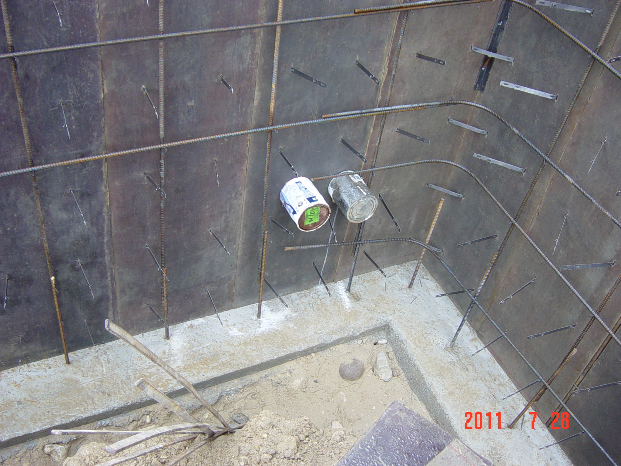

Interesting read on the reinforcing. Not quite sure I agree. The building inspector for my driveshed was a real stickler for rebar. A lot of it, and in the right places. Particularly as the buidling was set into a hillside. I find it hard to believe that all this rebar does nothing, if the concrete has not cracked.
Corner of building into hillside. Paint cans are for various utility lines.

This is a wall not slab on grade. Two totally different structures

When it comes to concrete, tension is tension and compression is compression, regardless of orientation.
