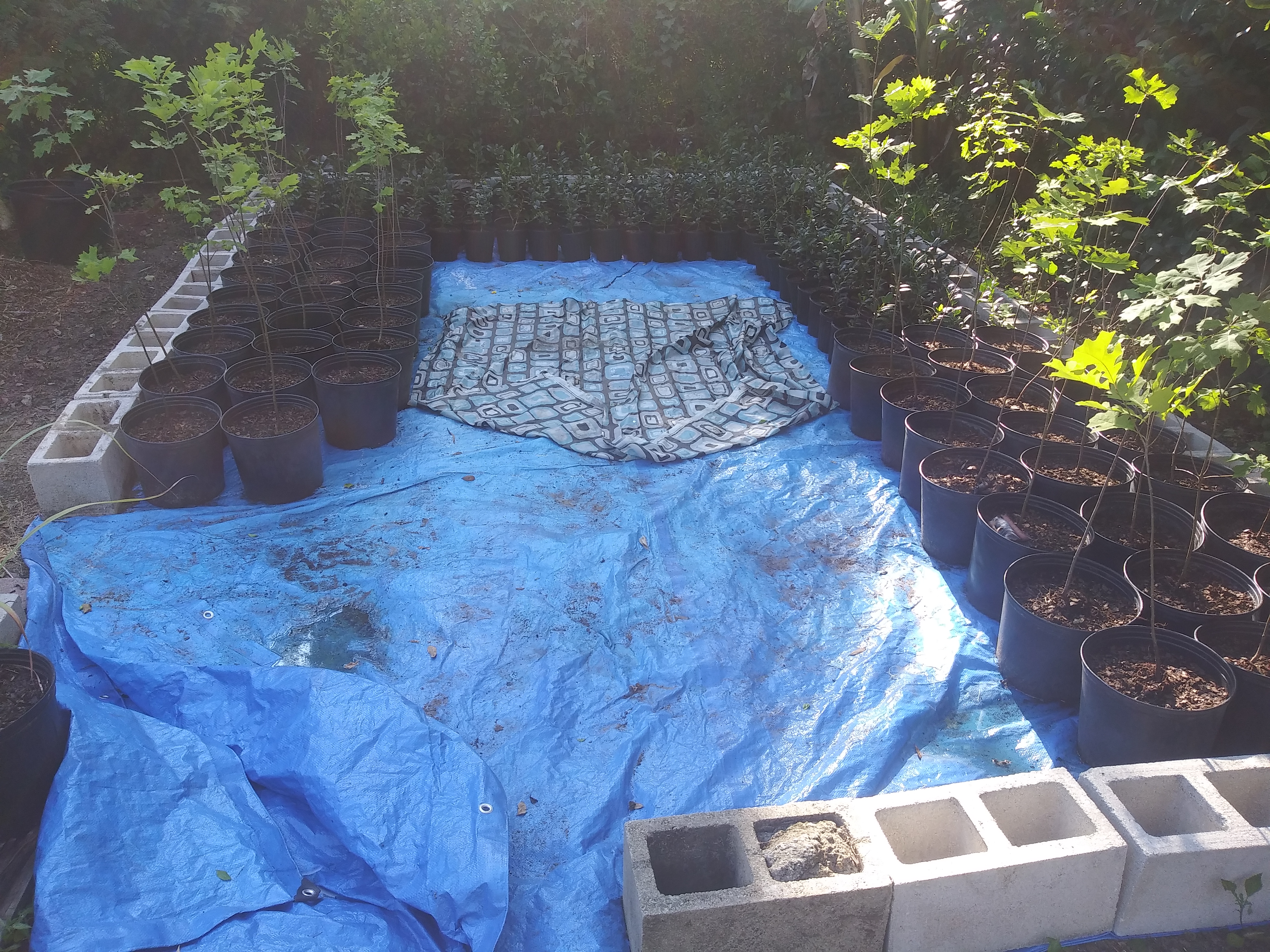

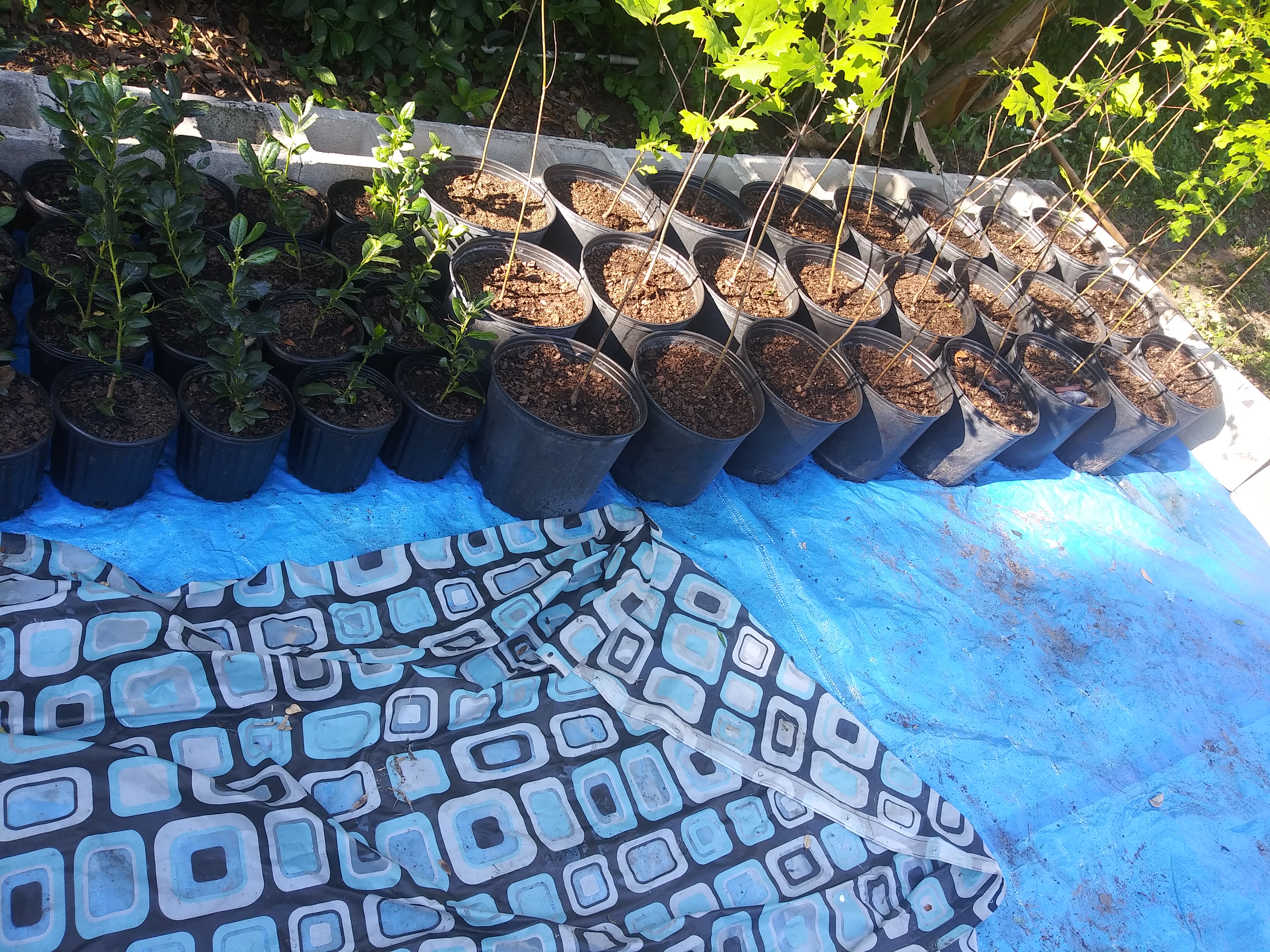

I know alot of you guys have spent your lives growing things.
I have 211 Holly trees that Ive planted in the ground on my property in Dunnellon. They will supposedly reach 25-30 feet height someday. At this point the tallest tree is approx 1 foot tall. Supposedly under the right conditions they can grow 2-3 feet per year, if they were 6-8 feet tall when I start building in a few years ( feb 2023 ) Id be very happy.
I have another 200 + here at the house ( in pots ) that I plan on nurturing more closely and then transplanting this fall.
I also have 50 Shumard Oak trees at the house, ( in pots ) supposedly they can have the same growth rate as the Holly trees under ideal/correct conditions. They average maybe 3-4 feet tall at this point and have pencil like trunks.
What can I do as far as fertilizer to give these plants a boost? I need a specific item to look for and purchase. Ive been told 20-20-20 but Ive also been told that this will burn the roots, Ive been told dont put anything directly at the base of the trunk, Ive also been told it matters not, Ive been told to only use water soluble for fastest results....told many different things.
Not looking to experiment if possible. Surely some of you guys can tell me what would work best ?
The 211 trees on my property I am able to water once a week when I visit the property. I have a 275 gallon IBC tote full of water on my trailer, pulled by my truck and a portable gen to operate the pump.
The other trees at my current home I have no limits.
Thanks

10-10-10 is a good standby and one of the easiest to get, around here at least.
   / Tell me what fertilizer I need #3
Do not fertilize. Plant back with the soil you took out of the hole you're putting them in.
Then just put a couple inches of mulch or just leaves around the tree, but not up against the tree itself. The mulch will provide slow fertilization as the worms work on it.
Chemical fertilizers will just kill the soil. You'll be stuck with using them because otherwise the soil is DEAD. Why kill it to begin with?

First of all, you need to get a soil test done. The University of Florida will tell you how to take the soil sample, how to send it, where to send it, and will tell you what (if any) fertilizer you need and how much. This is really the only way you should be determining what to apply since you have many trees that you don't want to experiment on. Florida soils are different from the soils in the rest of the country so a soil test is better than us telling you what we think you should use. Once you get the test results, we can help from there.
Link to Florida soil test: Soil Testing - UF/IFAS Extension

I did do this with the 211 plants, Ill have to post a pict. All of them have rings of mulch around them but Ive been told that my mulch ( because its mostly pine and a few oak trees ) is useless for providing any real benefits.

Pretty sure it will come back saying you need everything but more sand.
I would mix some cow manure in with the soil you have then water it in good. When I use to plant trees and plants in Florida, I always did this before putting the plant in the hole. Then side dress it with this mixture once or twice a year.
If you do decide to use fertilizer, pick one with all the trace elements. But then PH becomes more important in order for the plants to absorb the nutrients.
