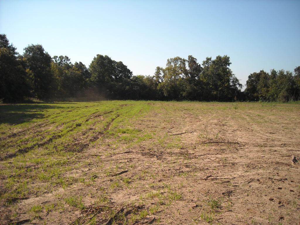

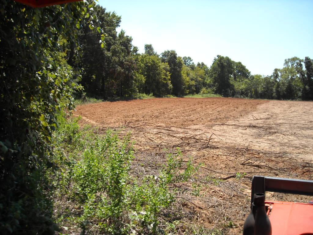

Here is a goot example of cover and no cover...
First pic the oats were planted 9/1, on 9/7 I covered them with the disk. You can see on 9/7 nothing has popped up at all. I think we also got a light raing after 9/1. Then on 9/27 the part I covers is doing very well, while the part only dragged has little sprouting. I bet if I covered the ramaining side with the disk the results would be dramatic.
The second pic is 9/27.
