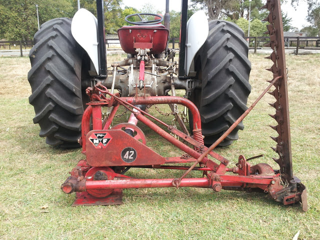

Have you had any luck locating part for your mower? I was taking a closer look at the parts breakdown on the Agco website and comparing it to your pictures and you may need the clevis that screws to the stud position lock and a bail spring that is noticable in your picture. The clevis part number is 833252m1 and the bail spring is 580490m1. From the looks of the bent stud and the rust, you may need all these parts to make the repair easier. Good Luck.

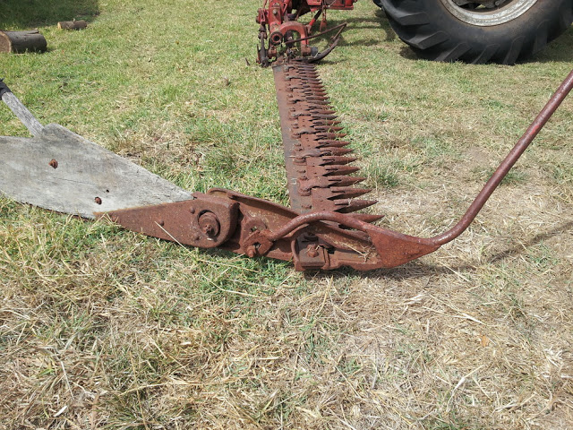

Hello, just saw this and thought I'd give you some info. The part you show in the circle is indeed the "Gag linkage" The Gag linkage controls the floatation of nthe inner shoe on the sickle bar when the bar is on the ground, in cutting position. Also, it appears that you are missing the outer shoe, that controls the height of the outer end of the bar. The outer shoe can easily be made up out of plate steel. Also, the mower is designed to operate with an operating heightr of 19-21 inches above the ground. This measurement is made from the center of the each lower hitch pin and the ground. hope this helps you.

Thanks for the info. Hay cutting season is fast approaching so I am getting back onto this mower. I have all new knife sections ready to go in and am part way through fabricating a new outer shoe. I'm also making new grass/swathe board as the old one was severely rotted. I am hoping it performs ok after the repairs as I've got about 10acres of my own property to cut and bale and possibly 8acres on a neighbours property if all goes well!

I picked up some old MF haying gear, and part of it is this MF42 sickle bar mower(or finger mower as they call them down here in Australia).
I cant find much info on this model - I managed to get a manual for an MF32 which is similar but not quite the same. These style of mowers appear to be more popular in the U.S. than down here these days, so am hoping someone can answer a couple of questions for me?
Firstly I need to replace an adjustable link(far right link in the circled section below), which is bent and metal fatigued, but I cant quite work out what the purpose of the mechanism it attaches to is for? Going from my MF32 manual I think its attached to something called a "gag link" assembly? Best guess I can come up with is that it lifts the end of the bar when the 3pt is raised? Is this correct?
Next, is there a height adjustable shoe missing from this end of the bar? I can see some cutting height adjustment from the inside shoe but cant see any on this end?

I did manage to track down a manual. I ended up fabricating the other parts that I needed, and fitted all new knife sections. I've used it to cut about 10acres of hay so far this season and it has worked reasonably well, but it is a little fussy about the grass it cuts. Anything a little damp, dense or matted and it has a tendency to plug the blade. Unfortunately I live in area where its common to have all the previously mentioned conditions! When the blade plugs it tends to leave behind large clumps of wet grass that will not break up or dry regardless of how much I rake it. A tedder woud probably fix this but I decided to go out and buy an old 4 disc mower instead, so if the new mower provides a better result I will be selling the MF42 on - as much as I hate to see it go.
