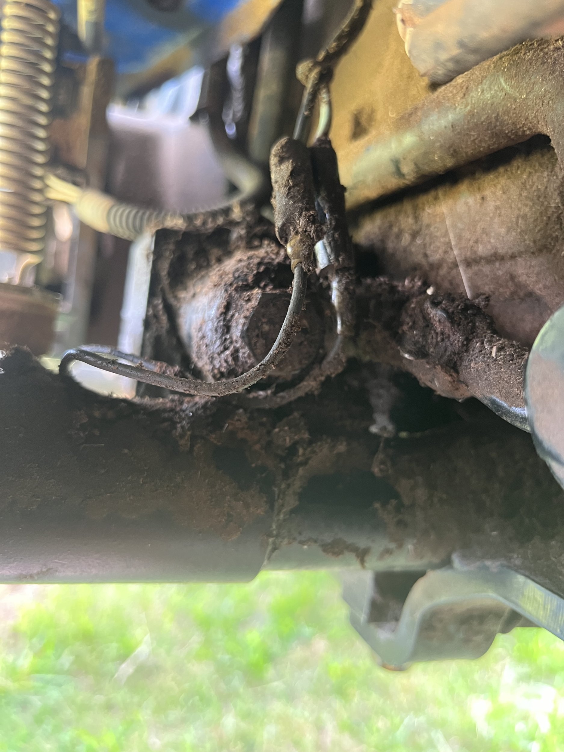

Well the two bullet connectors we’re not undone, but one looked loose so I unplugged both and reconnected them.
I tried it out but the two speed didn’t shift.
I may try running 12 volts straight to it and see if it shifts that way. Then I’d know if it was just an electrical issue.

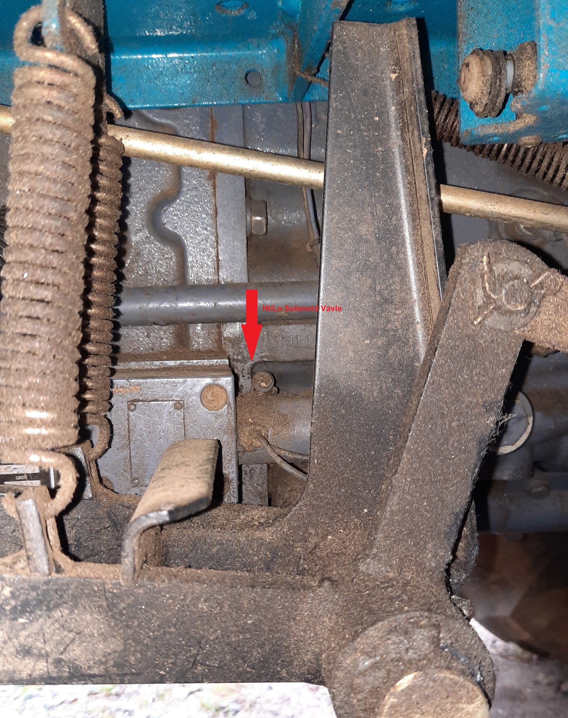

@dieselscout80 - Sorry I did not look at the pic you posted last night... That is the Neutral Safety Switch in your pic... Not the HI/LO Solenoid Valve...
You need to look further back on the transmission... It is behind & to the rear of the 2 heavy brake pedal return springs... those are the wires you want to check...
Not a great pic but might help...

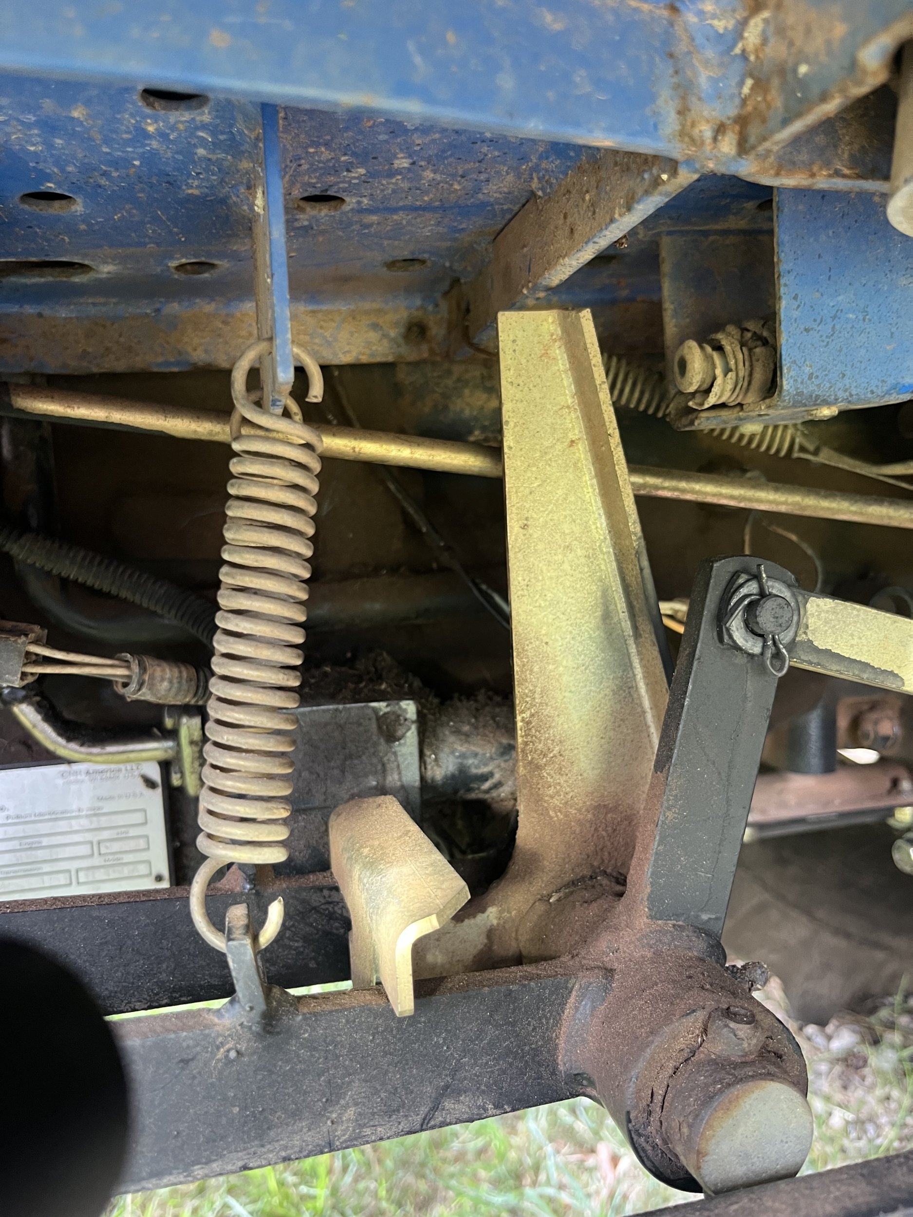

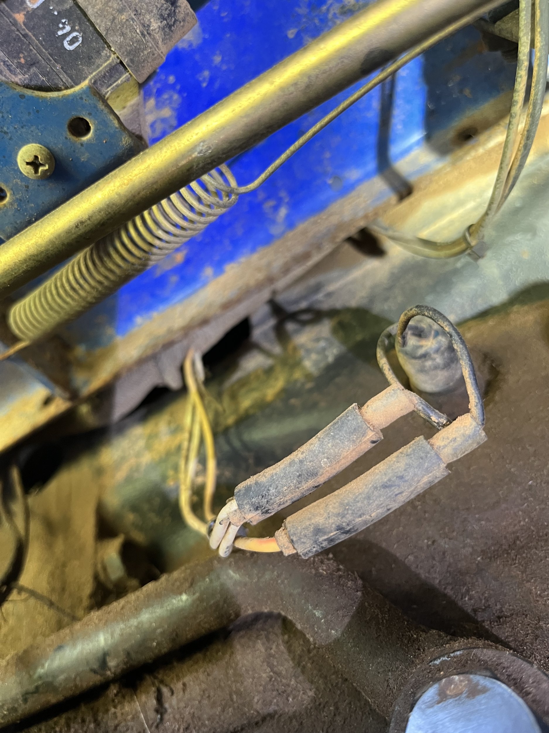

Do these two pictures show it?
This set of connectors is almost straight below the one in my first picture.

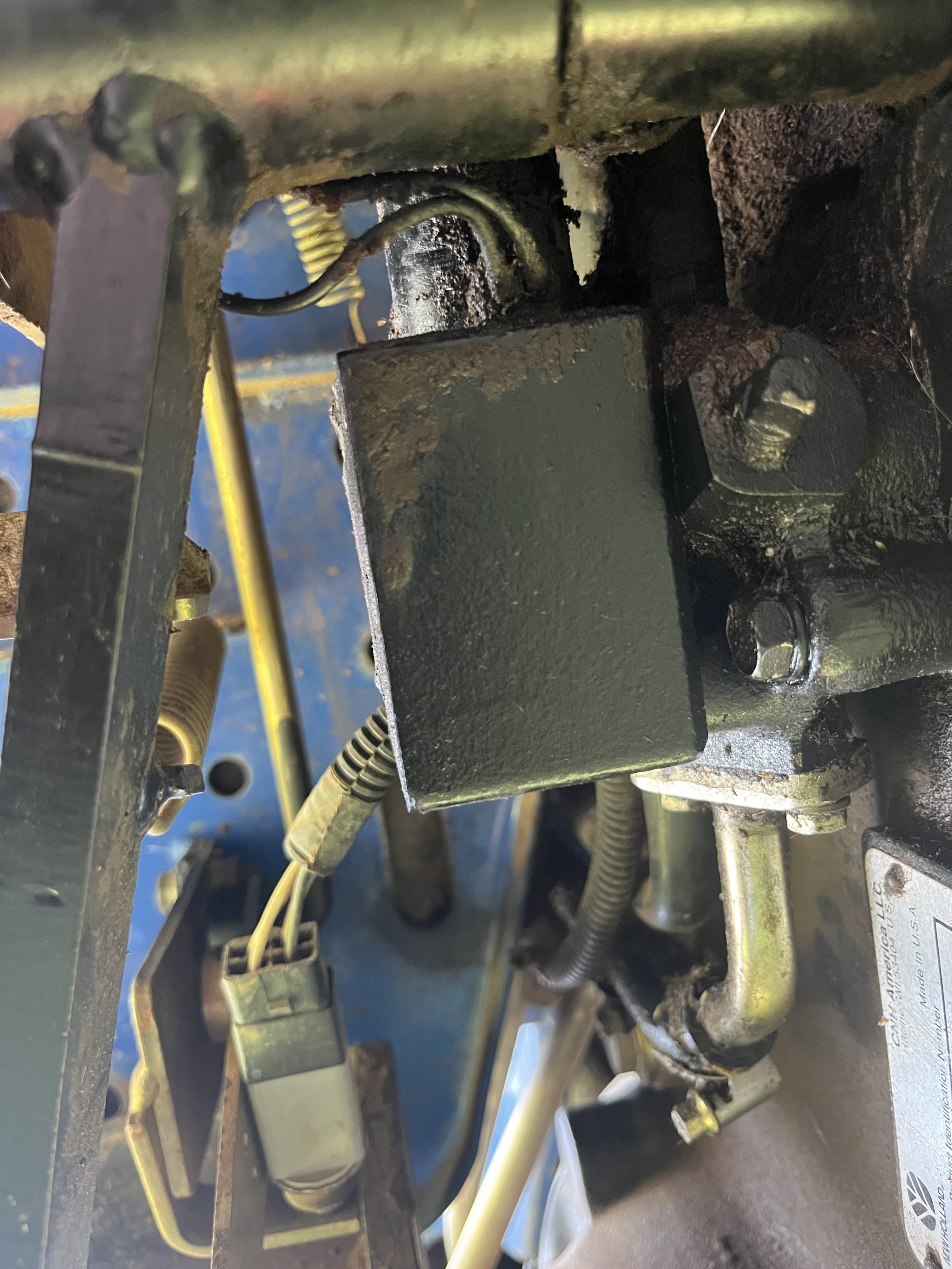

Here’s another picture with a flashlight shining on the device/controller/connection.
Also, it appears and feels li it is connected.
Another thing the controller/device appears to be oriented reverse compared to your picture.

@dieselscout80 - Yes that is the unit & it is oriented the same way as ours; just different pic angles I think...
I would pull those bullet connectors & see if you have 12 volts there when the tractor is in HI mode... if it does not have 12 volts check the fuse & then the HI relay...
Quick note on the relays - the Hi & Lo relays are the same so you can just swap them for testing purposes....

What I am pointing at is this part #SBA340015990.
Yes that is the HI/LO Solenoid Valve... should be 2 wires coming off the round Solenoid that have bullet connectors on them connecting them to the harness... The square part is the valve block & has the hydraulic piping going to it.
