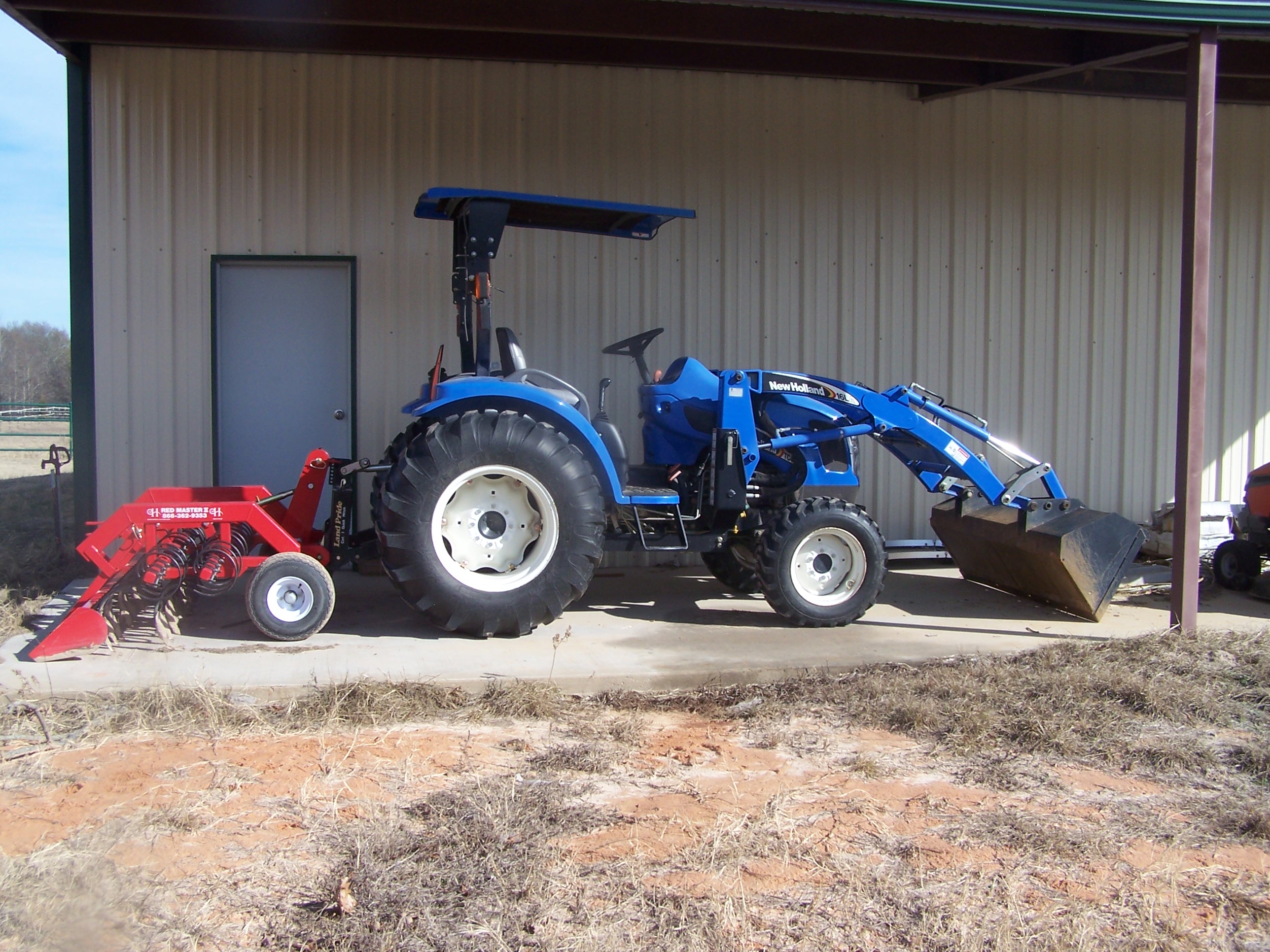

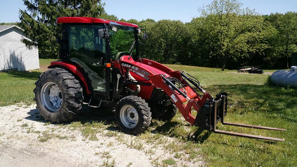

Full disclosure, I'm new to the tractor owning world, but I have been trying to learn everything I can. My DX45 currently has R4 tires that are spaced 78" outside to outside. It seems a little wide to me, and I would like to get them spaced so that a 72" implement will cover the tracks. It seems like a lot folks that own these tractors have just that set up. Also, I do have 2 wheel weights mounted on the inside of each rear tire. So, my question is, is there a way to adjust the spacing of the tires to reduce them to a point that a 72" implement will cover the tracks. I appreciate the help everyone has provided so far!
/ TC45DA/DX45 Reducing Wheel Spacing #2
The answer to your question is "maybe" or perhaps "probably".
We're gonna need to know what kind of rims and tires you have. A picture would be worth a thousand words in this case.

Looking at your top picture, I can see your rear wheels are set to the widest position. If you take the wheel off and turn it around you will have a much shorter spacing, You will need to do both sides and you may have to move each wheel to the other side to keep the tread turning in the same direction as it is. I am not sure what you need to do about the wheel weights but I think they can be on the outside instead of inside the rim. If that change makes the wheels too close you will need to change the hub to rim position. Don't do anything until you get a diagram to show spacing. Wait for more posts from other members, but you get the idea of what can be done. Those wheels with the weights will weigh quite heavy and will be hard to handle. You nay want to get help from a tractor dealer.

I have a friend who owns a repair shop where the tractor currently is. I won't try it on my own. I do have the manual and noticed a section for the tires so I will have to read through that. I think I'm going to have to reposition the rim as I'm scared it will make it too narrow to just flip the wheels. I don't want it too narrow, just narrow enough to cover the tracks. Hopefully the manual will make it a little more clear on the process. I'm still all ears for any tips or tricks. Thanks!

According to the manual page 4-8 the width with R4s dished in is 84.5" and dished out is 68.3". I have mine dished out and 6' implements cover just fine. You should be able to hang the weights either way. The proper way is to swap sides, not turn them around, so the tread is correct.

If you move the wheels so the disc portion is Outside the bolt lugs on the rim, that might be enough for you. Right now the rim is to the outside of the disc. Help and a wheel jack or crane will be needed.
Most TBN members want to widen their track; someone already did that to yours.

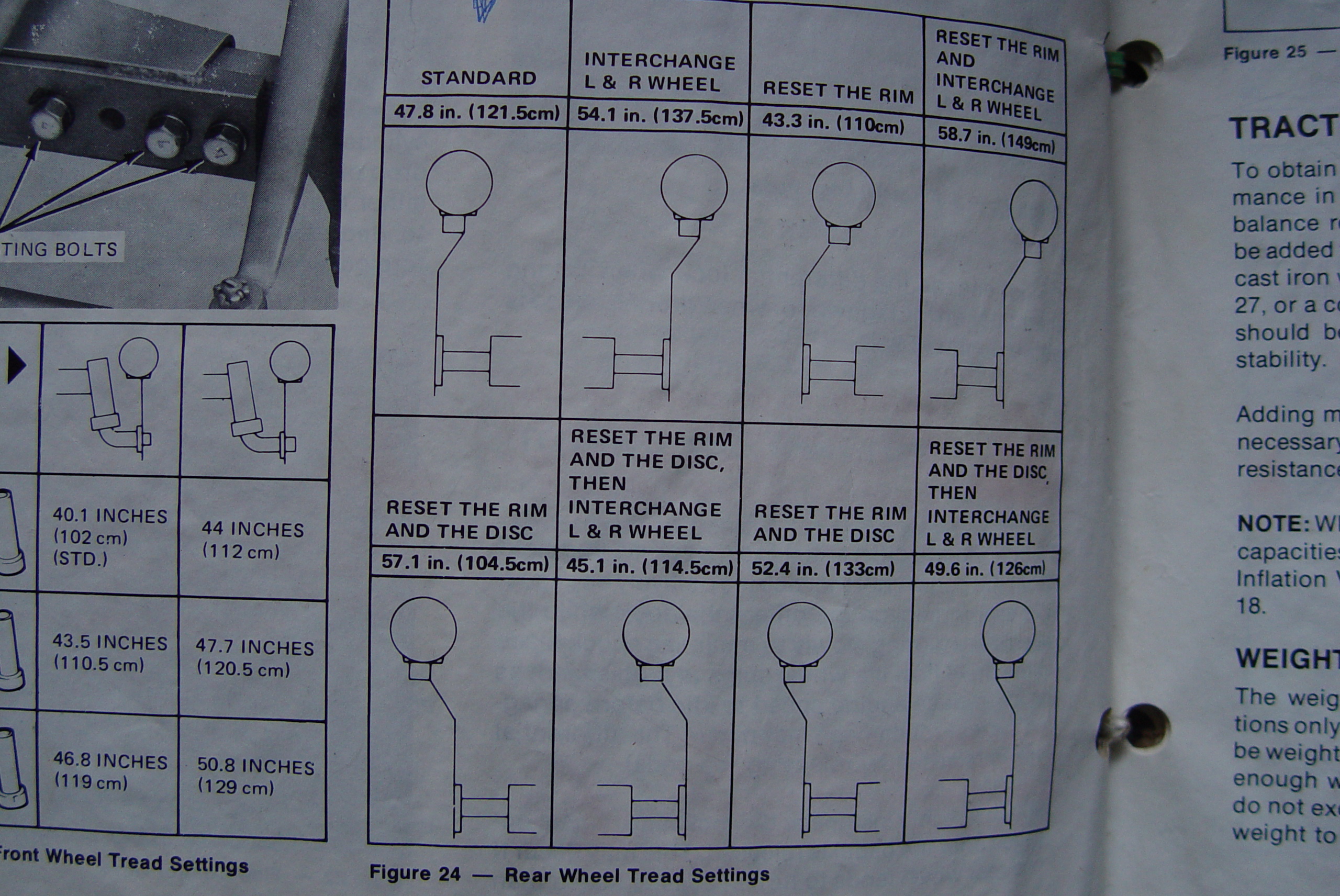

Well my manual doesn't have any diagrams or explanation on how to configure the wheels for different widths. Just the same page that was posted earlier. So there are 4 different settings, I'm just not sure how to obtain them. Can anyone shine some light on it?
/ TC45DA/DX45 Reducing Wheel Spacing #16
/ TC45DA/DX45 Reducing Wheel Spacing #17

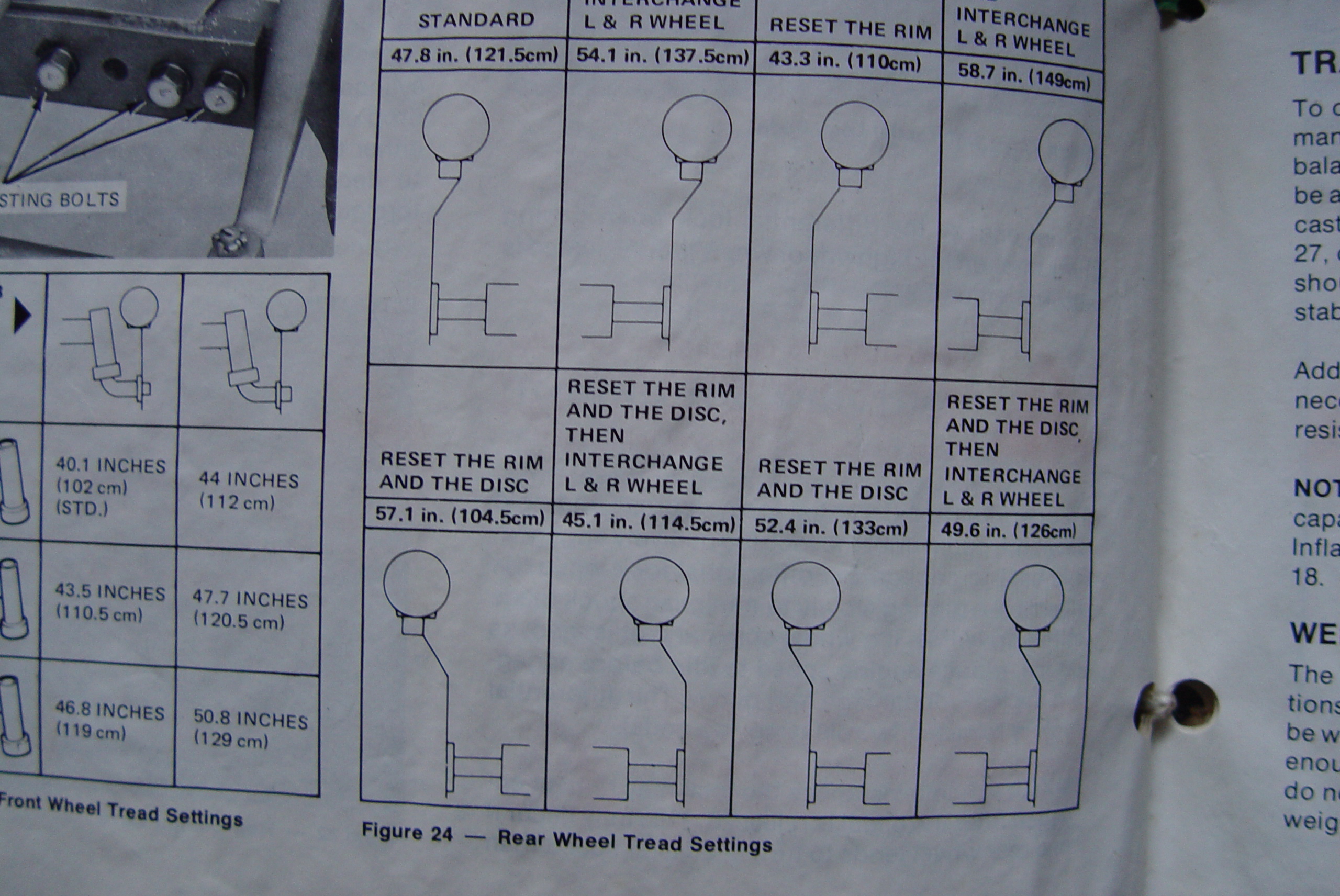

View attachment 512467View attachment 512468 Click on picture to enlarge. This is from a Ford 1700 but it is the same for all Fords only the end measurements will change for each different model. There are 2 pictures but they are the same from my 1700 manual. There are 8 different width here.
From your picture it looks like your current setting is the one on the Bottom Left or top right, depending on which side of the offset to the rim that your wheels are currently bolted to.
Notice where the hub is bolted to the rim, it is offset, not in the exact center of the rim. So depending on which side of that offset offset you bolt to makes a difference. You need to gain at least 6 inches or more to get under 72 inch width.
