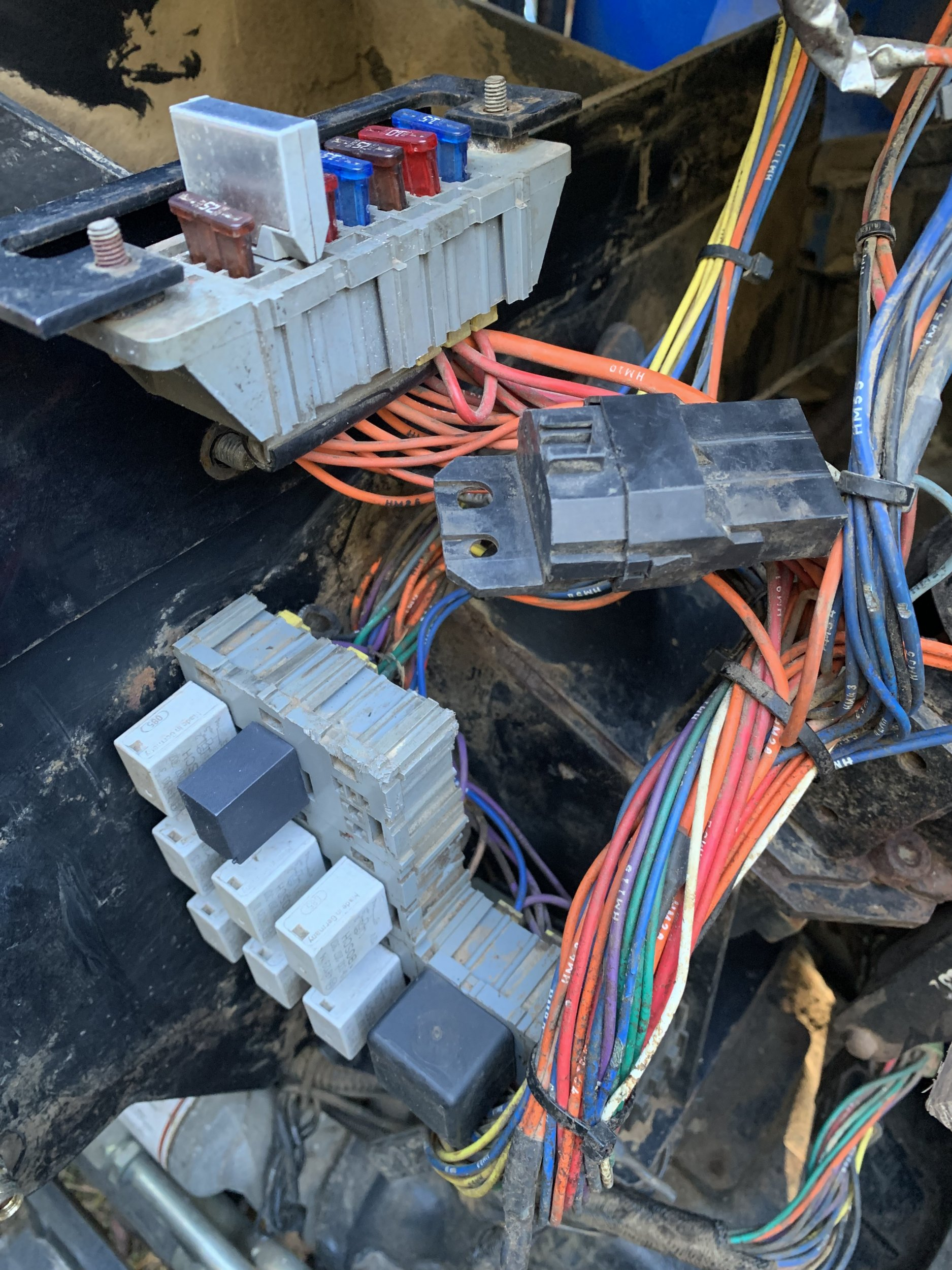

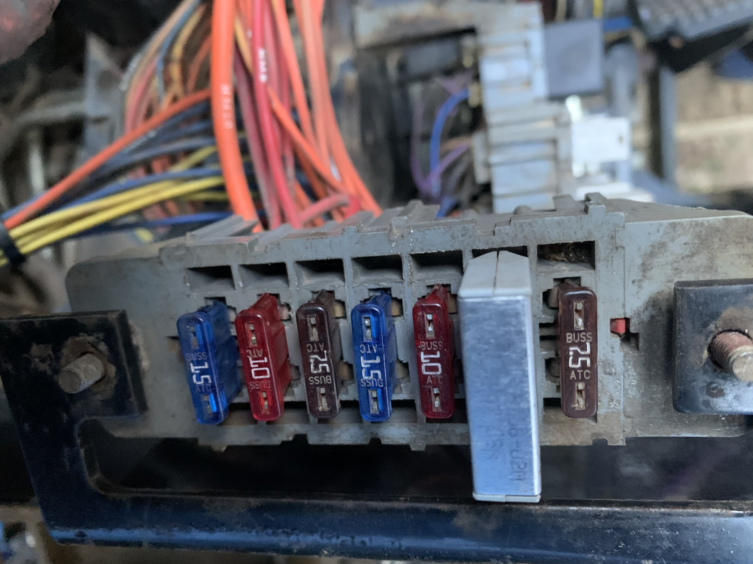

I want to thank everyone who has offered help and information. I regret that it has taken me this long to get back here and Update but there have been so many things going on lately that I don’t know whether I’m coming or going.
When I originally checked all the fuses, I accidentally missed a blown 25 amp fuse, and guess what? When I replaced it, I got grapple function and hi-Lo functions back. It all worked as it had before … for about four working days. The fuse blew again. that time it only lasted a few hours working. The next fuse lasted only minutes.
The tachometer hasn’t worked “right” for quite a long time. (Maybe since the Lane Shark was installed?) and it now stays “pegged out” while everything else is working correctly. I’m wondering if this is pointing to a cause for all these symptoms.
Does anyone have the info on the fuse box for a TC40DA (2004)? It would REALLY help if I knew what each fuse (and relay) are for. I’m including pictures of the fuse box and the relays with the hope that someone may know, or have documentation for their circuits/ purposes.
Again, thanks in advance for any help that can be offered.

LS: If you're blowing the 25amp fuse, my guess is that is the circuit they tapped into to power your controller & the circuit is being over loaded. Undo the tap and find another power source, or add a fused switch/relay/solenoid set-up if you cant find another key on power source.

Kirkawilson, THANK YOU so much! I have needed this from the start. But now I’m very confused, I have never changed any fuses in this tractor before this, and my number one and number five fuses are both 25 amp fuses. I assumed that’s what it needed since it’s been running for years those fuses in there.

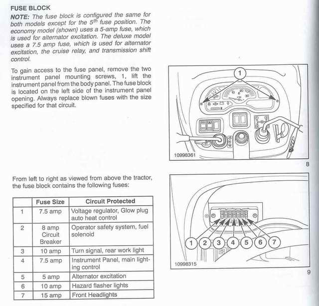

@tc40da-rg - That sounds like a situation of someone putting in what they had, not necessary the correct size fuse. Neither of those circuits should need a 25 amp fuse unless someone modified those circuits or something is wrong.
I would think 25 amp fuses are way to big for those circuits & you are fortunate enough that nothing ever happened, as I would think the wiring is not even rated for it & could wind up being the weakest link in the circuit prior to the fuse blowing.
Our TC40D has the same layout & it also only calls for the 7.5 & 5 amp fuses as shown.

The block lettering number on a 7.5 amp fuse can be confused with a "25"?
