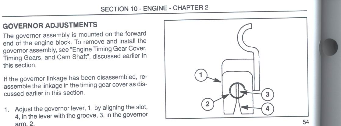

EDIT: Where the governor shaft attaches to the injector pump, there is a bracket like the one in the illustration below. The blue circle is a shaft with a slot in the end. The slot should line up with the slot in the clamp bracket for proper governor phasing. You might check to see if yours has slipped or come loose.

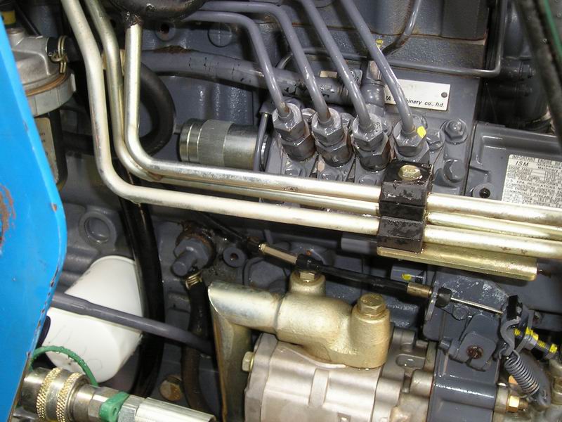

What about the fuel cut off solenoid not fully opening the injector inlet? I'm not sure I understand what or how that is? or how to check it.
Of all the possible problems, that is probably the least likely, but the easiest to check. The only reason I mentioned it a all is that your problems seem so strange that it might be something remote. I've attached a picture of the solenoid. It's that shiny round cylinder right behind the injector pump. It has one spade connector to remove and then you can unscrew it. The knurled surface means only hand tight, but you might have to grip it with pliers to get it started. Be very careful because you don't want to squeeze it too hard. Once you have it out, just hook up the wire and turn on the key with the range lever in neutral and the parking brake set, the plunger should fully retract. Note: the body has to be in contact with ground to operate.
Also in this picture down near the lower right corner, you can see the bracket I illustrated in my last post with the governor shaft phased properly.
I'm attaching a photo of the solenoid completely removed too.

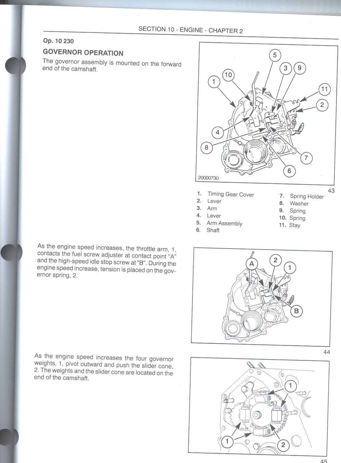

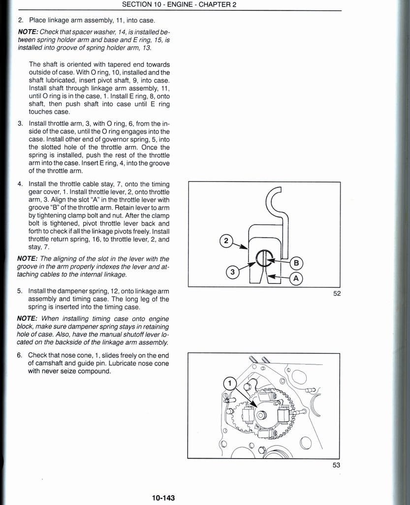

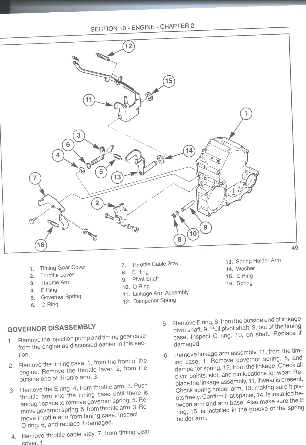

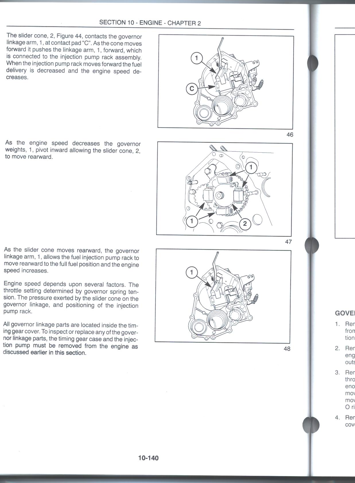

Sonnyc, here are the Repair Manual pages about the governor. I doubt this is your problem, but I will leave it to you to decide for sure.:)
