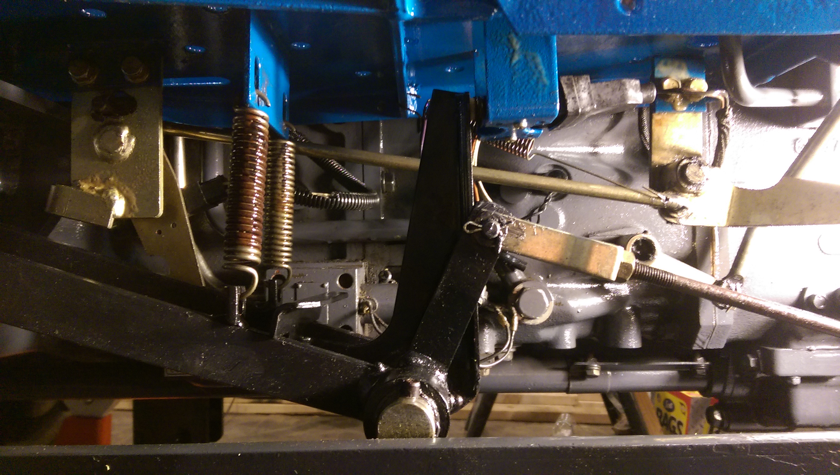

I have a Case DX40 that is hydrostatic. I believe same as NH TC40DA?
If anyone has some photos of the parking brake assembly under neath they can share that would be awesome. I’ve looked online and cannot see what I need to see from the parts diagrams.

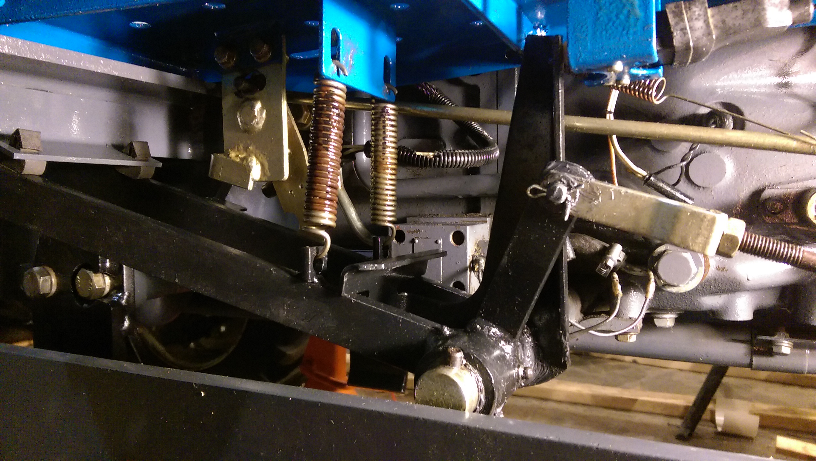

Not sure what you are looking for... need more info... but these are pics of our TC40D....

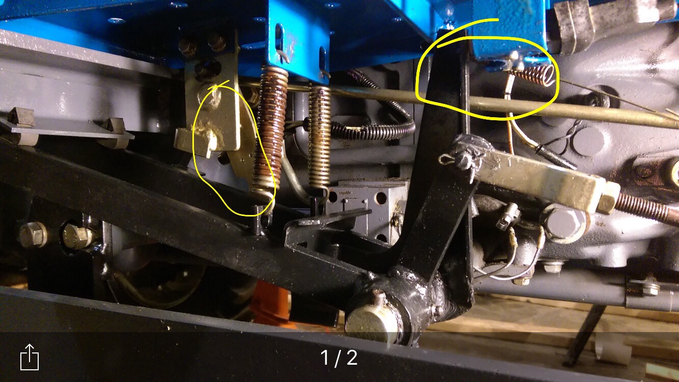

Where does spring on right attach? Can you snap a photo?
Bracket with teeth on left that engages onto pedals. Is there a spring on that anywhere?
Thank you.
   / TC40D Parking brake #4
You can see where the spring attaches in the first photo.

Also, I think the spring I circled applies spring tension to the rod which in turn keeps tension on the toothed bracket. It's that tension you feel when you pull up on the brake lever from above. Hold the lever and it engages when you hold the brakes down. Step on the brakes and that releases the lever and that same spring pulls the rod and bracket out of engagement.
   / TC40D Parking brake #7
Ford850... You are correct... besides the pedal tension springs that is the only spring for the Parking Brake assembly.... :thumbsup:
Glad this helped...
