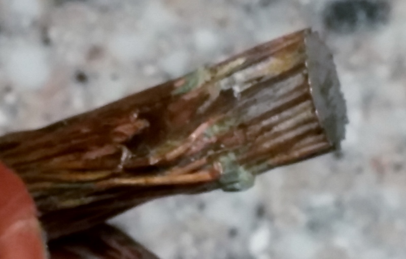

I got the cable off last night after busting some knuckles on some small spaces, and yes the cable is not spliced but 2 more wires crimped into the end for the starter that lead back toward the battery for the alt and one that has a watertight plug. I have pictures that i'll get up here in a bit. I took it to our local auto parts store, not NAPA, and they said they didn't even carry the 2awg wire let alone have the tools to make a cable setup like this. The guys did say that most of the problems occur on these up at the battery clamp, and that cutting the lead clamp off the wire and cleaning it up and putting a new clamp on would probably fix my continuity problem.
so I cut off my old clamp to expose the copper wire and I can see some acid powder and some corrosion in the wire down about 1" from the insulation I stripped off.
I'm going to put it in some baking soda solution later and see if that will clean it up enough before I clamp down the wire in my new clamp.
gary
/ TC35DA won't turn over
here's a picture of the end after I cut off the clamp
you can see some of the corrosion on the wires
this end is soaking in a baking soda solution right now

1117141545 (1024x571).jpgThanks guys... well I wanted to check if this cable was my problem, so I cleaned the end copper and last cleaned with vinegar and salt for making the copper wires nice clean. Then I put the new clamp on that end and checked the continuity from both end and it was nice 0.0
So just for kicks, I went out and put the lug on the starting bolt and then put the clamp on the + pos and sure enough the tractor Started fine. I cut it off as soon as I got the FEL up. So that must been the problem at the end cable to the battery clamp.

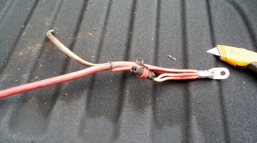

here's a pic from the other end for the starter and alt

ok, here's one more picture and some specs on how I got this cable out.
12mm nut on the Starter bolt, 8mm for the Alt nut.
With the Battery Clamp still on I had to remove one zip tie and pull the cable up through the bottom of the radiator mount.
The 3/4" plastic cable loom/conduit was mostly cracked or too brittle to save, so I'm replacing all of that too.
this pic is off the entire cable, includes a 2awg main red wire and 2 smaller wires(10-12awg) that are crimped into the starter lug end.
There was just a spot or two of rust on that starter lug, and nothing on the Alt crimp ring.
In the end, all of my continuity issues I believe had to do with the battery clamp and the 2awg wire connection to that piece of lead.
I guess after 13yrs and 3 batteries, the corrosion between the lead and the copper wire built up enough that the connection was not good enough to power the starter load. The rest of the ~30in of cable and attached wires look almost new with no burn/hot spots, nicks, or corrosion.
So in the end, I could have easily removed the battery clamp from the cable without removing the whole cable and had a running tractor in no more than 30min of work.
