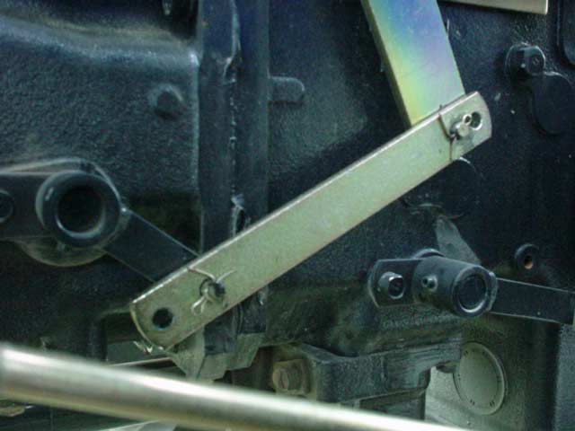

It does fit the contours just fine except for one thing, you can't go into high range. The shift bar hits the box never letting you select high range. Easy fix though. First pic shows narrowing the gap on the lower flat bar for the shift linkage.

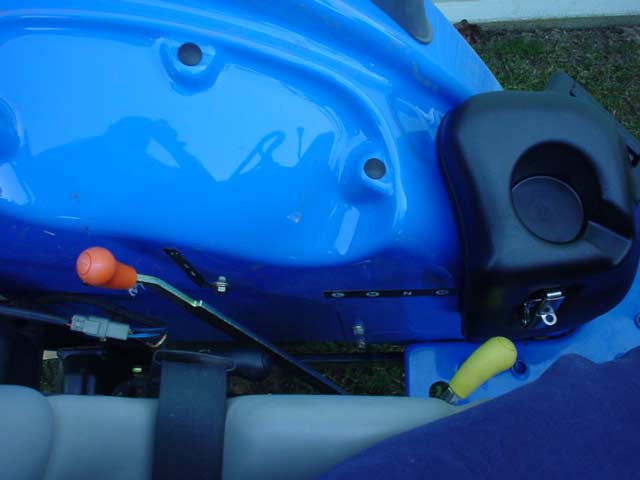

Showing now where the shifter is located in high range.

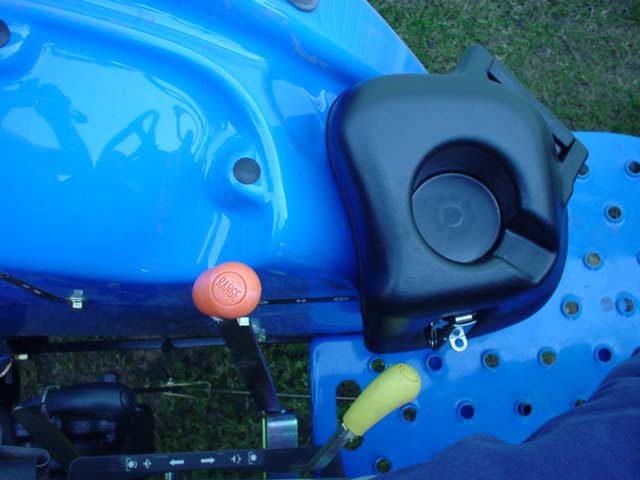

Low range. You can guess where Mid range is. LOL

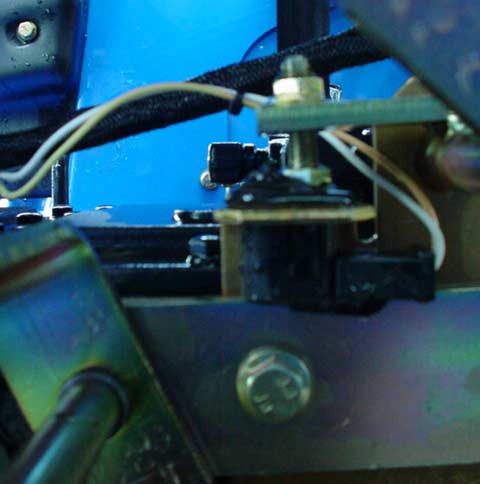

Encontered one other problem. The lower part of the shift bar now was hitting the back of the PTO safety switch. Easy fix. I popped it out and turn it around and. Wires are now on the opposite side by the shift bar.
Randy

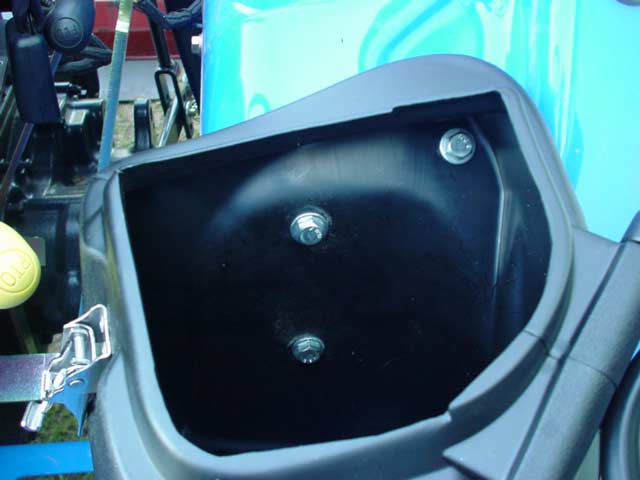

Also added an extra nut and bolt to the box so it wouldn't rock around so much.
Randy
