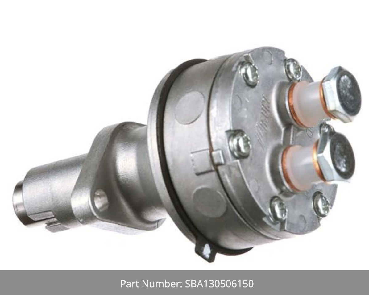

Hi All,
PLEASE GO TO THE BOTTOM OF THIS THREAD if you are looking for a SOLUTION to fuel levels dropping inside the fuel filter assembly during tractor use. You are, of course, welcome to read the entire thread.
I have been having a persistent problem on my 2004 TC35. When I run the tractor at a persistently higher RPM (such as when using a rotary cutter), the diesel in the filter bowl keeps dropping. If I neglect to check it periodically, I run the risk of the lines being sucked dry and the tractor stalling out (and the later aggravation of having to reprime the injectors). If I loosen the bowl, diesel easily refills.
I've done all of the obvious. Change the filter, blow out the fuel line and return line, drain the tank and ensure there are no blockages or sediment. Also have checked to ensure that the fuel tank cover is venting. Thanks to TBN, I've tracked down a number of threads that describe this same issue. I've drawn the conclusion that my lift pump is probably on it's way out and it's time to replace it. I order a new one from Messick's and it's on the way.
Question: Does anyone out there either have written instructions on how to properly remove the old pump and install the new one? Looking at it on the tractor leaves me with the impression it's probably a pretty simple job, but impressions can deceive and I'd greatly prefer to have the confidence of knowing exactly how to do it correctly. Also, are there any other parts I am going to need beyond the new pump? The hoses all look to be in good shape. The "collective expertise" of TBN members has never let me down. Thanks!

It’s possible that u may have to “clock it” differently than received..
As u can see in the picture, there is a hash mark..
& u should ask if it came/comes w a mounting oring/gasket..

It DOES sound as tho you’ve tried everything else..
Btw.. u don’t have to “time” the lift/supply pump.. it simply bolts on..
It’s operated by a cam lobe and if u feel like there’s to much pressure when you go to put the new one on.. just bump the engine to move the lobe..

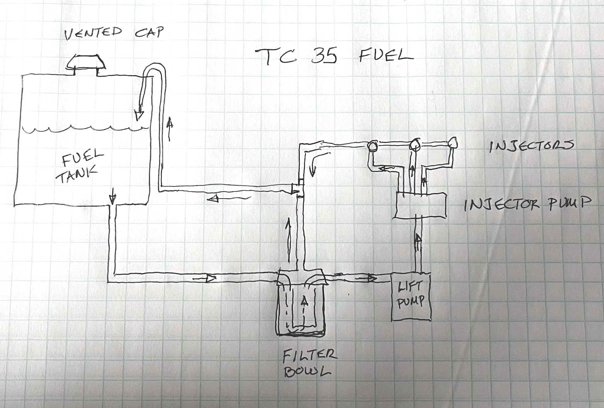

Thanks to you all, this has been a productive thread. But I am still struggling with understanding why the bowl slowly fills with air (and not fuel). Where is the air coming from? Why, when I crack the seal on the filter bowl, does the bowl immediately refill? To try to better understand this (since NH does seem to supply such diagrams), I drew a diagram of the system as I understand it. Can you all look at the diagram and correct any inaccuracies?
Just for the record, I've check the venting cap (works fine) check for sediment/restrictions in the tank (nothing there), removed and thoroughly cleaned the fuel filter assembly (there were no restrictions of any kind) and tripled checked the on/off valve, replaced the two sections of the fuel return line (the one that comes from the back of the injector pipes and the other one that comes up from the filter assembly, replaced the "t connector" that joins those two lines as they connect to the main return line, blew out (several times) both the fuel line and the return line.
For the life of me, I cannot find a single problem with the fuel system at any point before it reached the lift pump. That's why I am considering changing the lift pump out (even though, you are all right, it's not logical).
I am not a fluid engineer. Consequently, I cannot make any sense of why this problem is occurring given what I have already done. How can it have anything to do with a tank blockage when the problem is immediately "corrected" when the seal is broken on the filter assembly (partially unscrewing the bowl)? The only thing that makes sense is that air is replacing where fuel should be in the bowl. But where does the air come from if the system is providing a positive pressure through the entire flow (see diagram).

I would be looking at the passages that involve the return line from the filter base leading up to the tee. I've never understood the need for that port. Most all the tractors I see with that type filter base have no such vent or return line involved. It's just fuel into one port, fuel out of another.

That makes sense to me. It seems that the only place for air to enter the bowl would be from that opening. It doesn't make sense to me either. I see the value of having a place for excess fluid/vapors/even air to go after visiting the injectors. It keeps everything moving in a loop from the combustion end of the tractor to the fuel storage area. Why it needs to connect back to the filter assembly doesn't fit.
I can temporarily shut off that one section of the return line (the section running from the filter assembly to the "T connector" with a hemostat (a medical clamp). And then run the system and see what happens. If I lose power after several minutes of mowing, then I'll know that somehow that one link in the system is essential. If, on the other hand, the bowl stays full and I don't lose power, then I may have my answer. Sometimes I wish that the New Holland engineers who design these systems would visit a site like TBN to explain their thinking.

Okay, so I followed Harry in KY's suggestion and focussed upon the section of the fuel return line that runs from the top of the filter assembly to the "T connector" that joins the hose that runs from the back of the injectors to the main return back to the tank.
I crimped that short line with a pair of hemostats (two of them just to ensure I had no leakage for this experiment).
Result?: Was able to run the tractor at about 2500 rpm (mowing a field edge) for about 45 minutes with no loss of power/performance. In the recent past, that would have caused my filter bowl to nearly empty. This time, I still lost some fuel volume in the bowl, but only a drop of about 1/2 inch.
I guess I must be on the right track. What's still annoying is that for the last 18 years this was never a problem, and this summer it has been. I'm still flummoxed as to where the air is being introduced. It has to be a location in fuel loop that permits air to be pulled in. If it was a place that had positive fuel pressure, I would have a fuel leak, not the introduction of air. Right?

Ok, so yesterday I had removed the entire filter bowl assembly and cleaned everything thoroughly. There was absolutely nothing obstructing or limiting any one of the three orifices. I did not think to check whether that return orifice was before or after the filter. I believe it was AFTER the filtering but I can't swear to it.
I went back out about 90 minutes ago and took off the return line from the filter bowl assembly. Ran pressurized air through that line AGAIN. Then, reconnected the line after first ensuring that the bowl was full.
I then went out and did another long mow at about 2500 rpm engine speed. This is the rate that always produced the symptom within 15-20 minutes of mowing.
Guess what?? NO LOSS of height in the bowl!! Ran the tractor at that mowing speed for well over an hour and the bowl stayed full!!
What I did differently this time I am at a loss to define. It worked, but darn if I know WHY IT WORKED... The lift pump will likely show up in the next few days, and I have 30 days to return it without anything more than the shipping cost. So...I'll hold on to it for the next couple of weeks as insurance. I know it's almost certainly not the problem, especially since if it WAS the pump the problem couldn't have resolved WITHOUT replacing it. I just don't want to jinx the repair by sending the pump back prematurely. Call me superstitious.
If anyone out there can offer me a decent explanation as to why it worked this time but did not work the previous 4-5 times I'll buy you a pizza...
My relief that it may be fixed is tempered with the need to give it a few weeks of consistently working without incident. But perhaps (knock on wood), I'm done with this problem. I just wish I could tell all future TC owners with the problem the actual fix.
