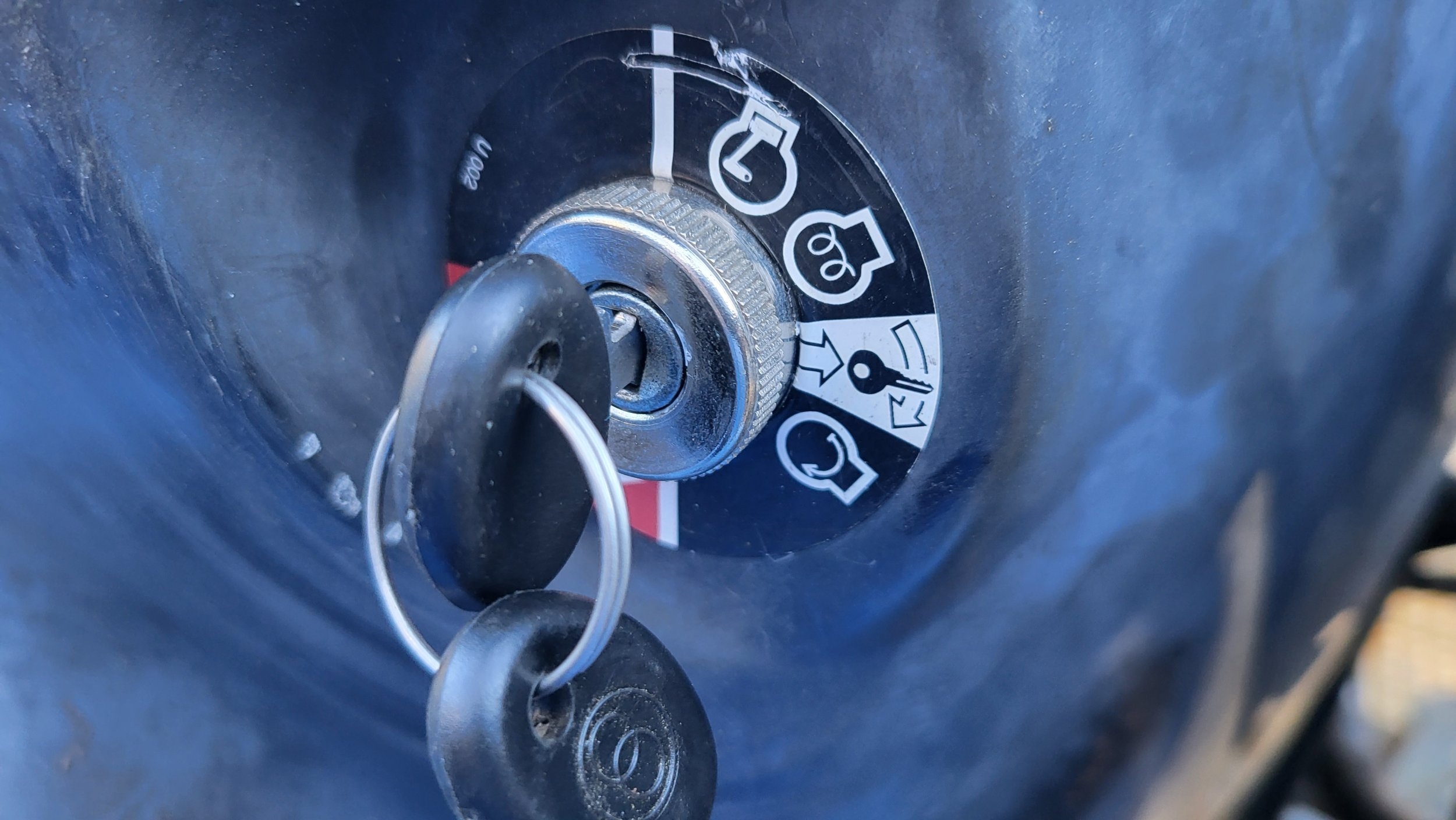

Interesting. I do not have an accessory position in the ignition switch of this tractor. Also,I have to assume that the "Glow Plug Heat" position, 3, is also the run position, for the switch.
Thanks so much for the diagrams. They confirm what I am seeing on the tractor, no glow plug timer, but make me wonder about the actual operational details of the glow plugs (another issue I am working on).
Thanks,
Chris

Four wires to the ignition switch.
Thanks,
Chris

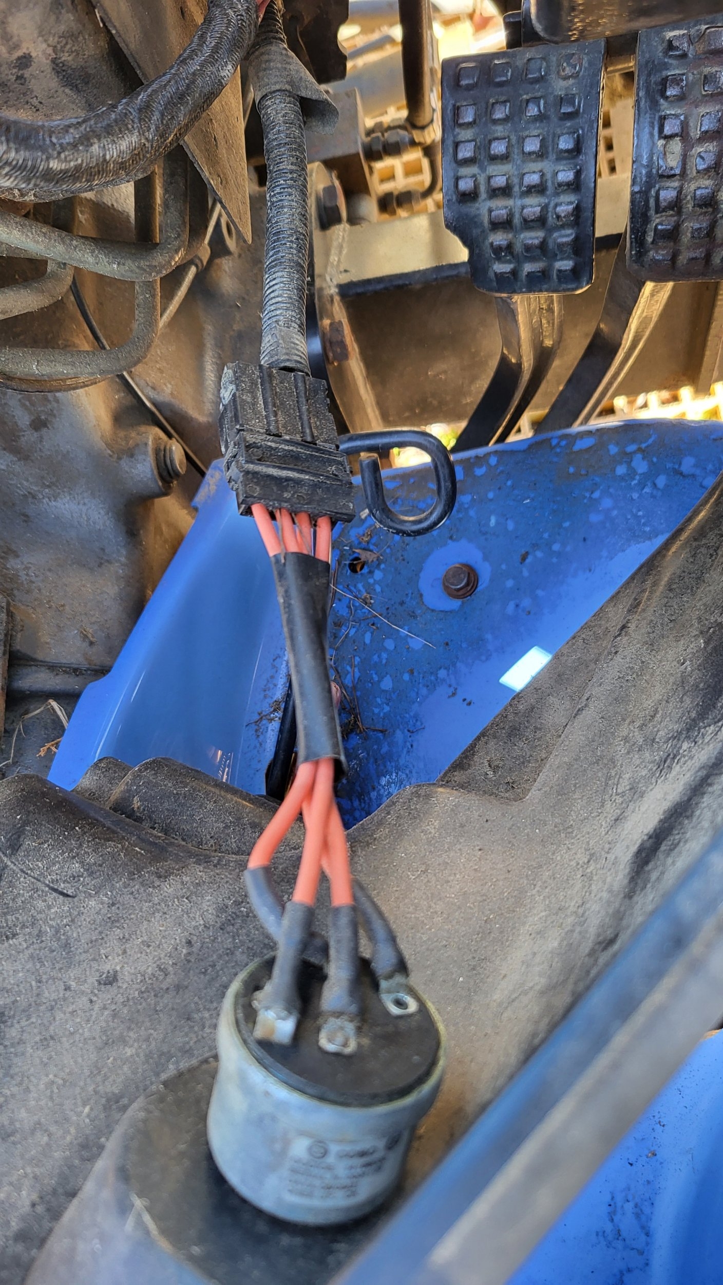

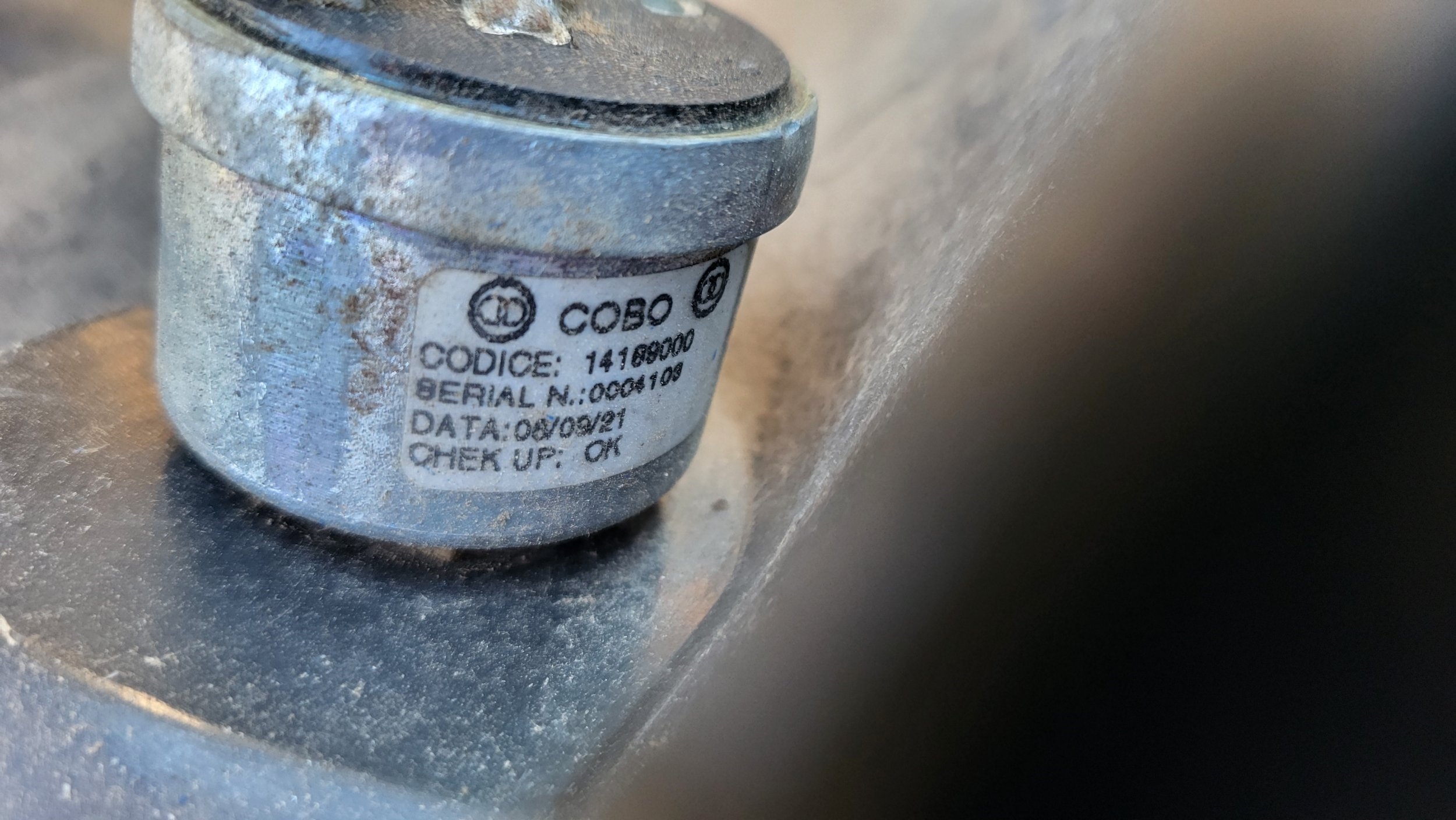

It's looking like the ignition switch is bad. When you go to start positions, one of two terminals that are supposed to be hot, are not. The one that's not is the purple wire going to the start relay. I jumped the dead terminal on the back of the ignition switch and the tractor started right up.
The problem now is the weird series of diodes that appear to feed back into the circuit so as to power the glow plugs, but on this tractor it is exactly opposite, in that the glow plug circuit is getting power directly from the switch but the purple wire may get power when fed back through a diode. It's quite confusing because some of the wire colors don't match either.
It's almost like this tractor was supposed to have a glow plug timer and they did some rigging the eliminate that and drive them directly from the ignition switch.
