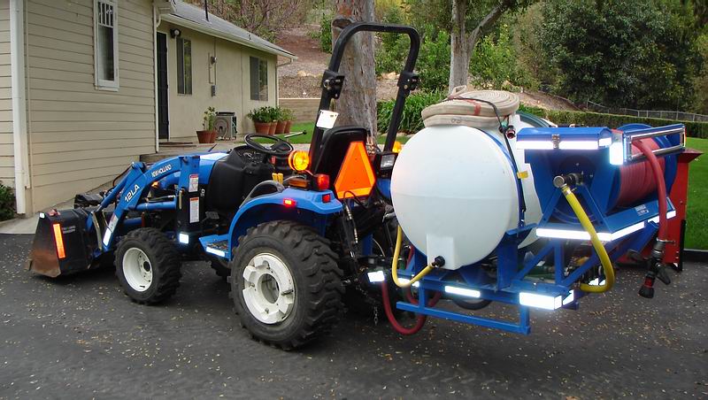

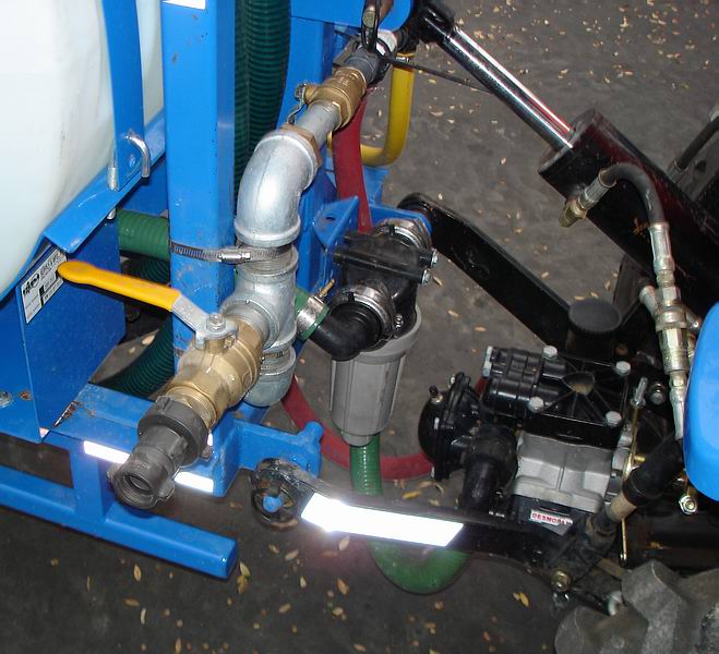

Hello everyone, long time no posting. I have been very busy improving my front driveway and city right-of-way after last year’s heavy rains that resulted in a washed out driveway. But I have also been busy building a Class 7 fire rig for fire protection in and around our property. In addition it also serves as a killer way to water the lawns, irrigate hard to reach locations and wash off the driveway!
Reasons why I needed a fire rig?
- Fire department is volunteer and poorly staffed
- Fire department over 20 minutes away (only 1 station for entire city)
- And mainly because I could build one! And is very empowering! /forums/images/graemlins/grin.gif
Specifications:
NWCG Class 7 Wildfire classification
30 GPM at 290-PSI Diaphragm pump
0-300 PSI pressure regulator (bypass into tank)
110-gallon tank
100 Feet of 1-inch double-jacketed forestry hose with NST aluminum coupling
100 feet of 1-inch booster hose on COX reel
20 feet of 1 ½ inch suction hose
40 feet of 1 ½ inch soft suction (hydrant)
1 ½ inch hydrant fill
1 ½ inch suction
Able to pump to tank from any water source
And most important: A work in progress
The rig has proven very effective to the point that it has warranted additional investment in making improvements. For those not aware of the cost of fire fighting equipment, it is very costly and configurations do vary widely. Trying to get the correct parts and plumbing has proven to be very challenging and expensive.
All in all we are trilled with the performance and much like the tractor has empowered us over government inaction the fire rig attachment has provided us with additional peace of mind and with the hope that we never have to use it for a fire.

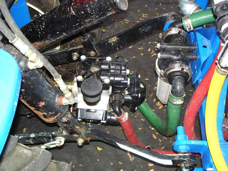

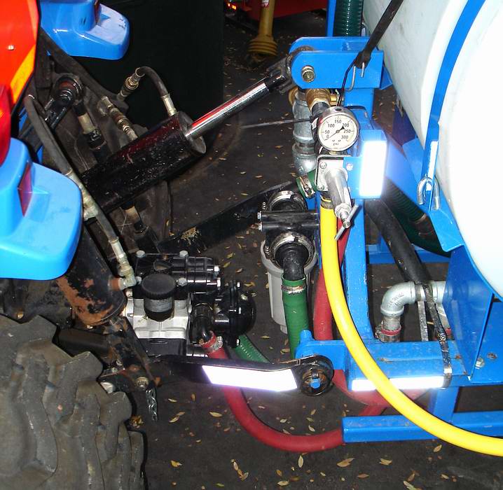

Picture of pressure regulator with Hypro 30.1 GPM 290 PSI PTO pump.

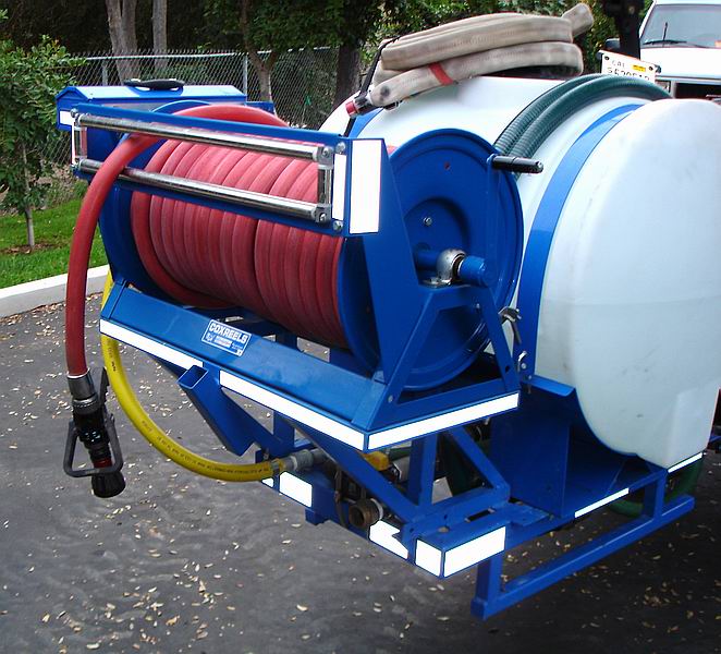

Picture of COX reel with 100 feet of 1 inch booster hose (hardline) ready for action!

   / TC24D Fire Rig (Class 7)

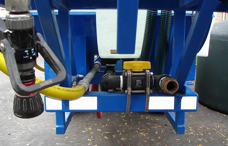

1 ½ inch Hydrant fill valve

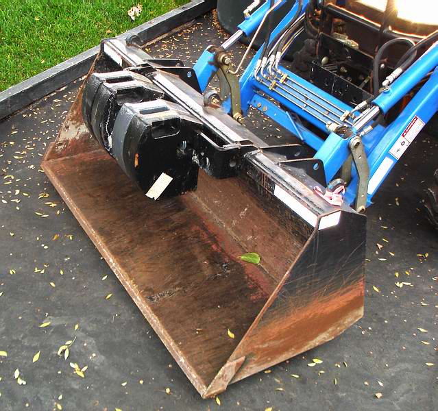

Keeping the front end down is a problem since the weight of the water and the rig are in excess 1000 pounds! And I do mean excess
So I added a bracket to the bucket to hold New Holland suitcase weights. The front end still gets light but I do not need to carry the water up onto the terraces that are very steep. So the configuration works well but I also have my front tires loaded and can add additional weight to the front end if needed.
I did respond to an emergency situation with our fire department and had to dump 110 gallons of water in route since what was needed was my loader and additional rear weight would have not proven very productive. /forums/images/graemlins/crazy.gif
