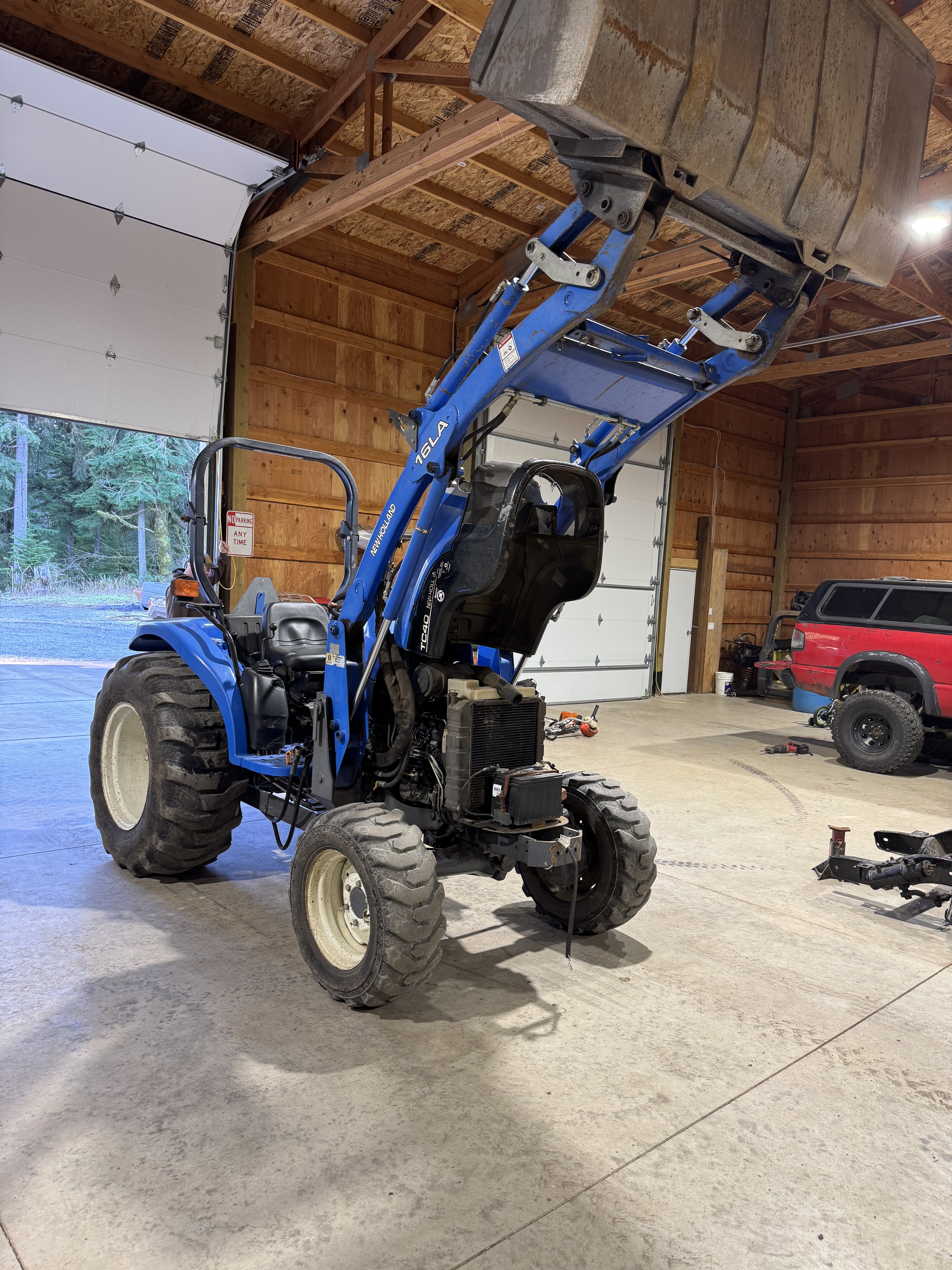

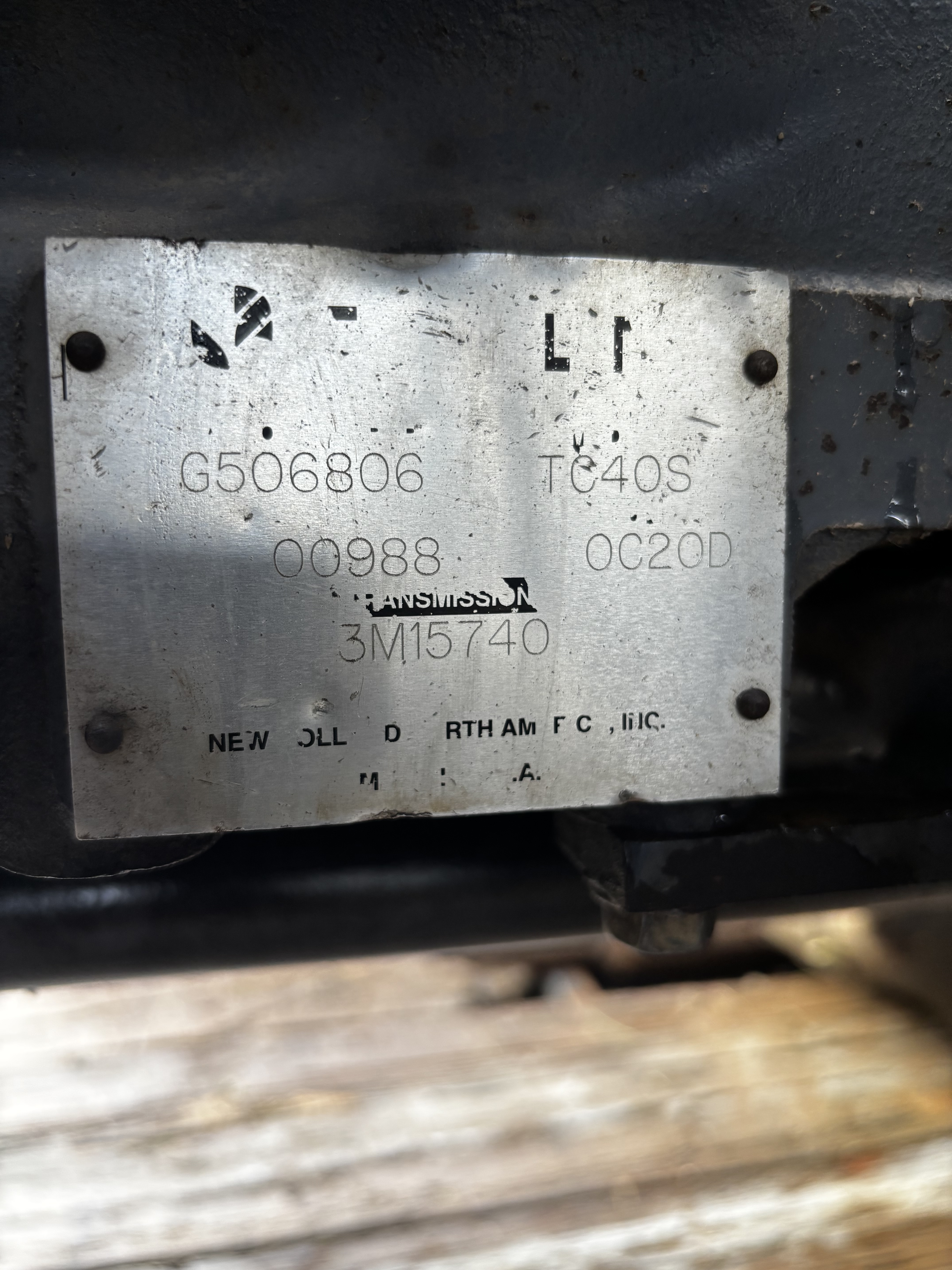

Hello I’m here to learn I have a tc40 in central California

Do you know where I go to ask some questions I have horrible throttle response very delayed and won’t make any power I have never used a forum
Thanks
Welcome! March 20, 2000 model. Have you changed your fuel filter? No kinks in your fuel lines?
/ Tc 40
yes sir I bypassed with electric pump and new inline filter makes 6psi at injection pump
Machine starts ok just very delayed throttle once it does rev you can get it going ok but as soon as it pulls a load it bogs down
/ Tc 40 #10
Sounds like the governor is gummed up or a spring has come off.

If u end up “deep diving” into the fuel system and gain access to the inj. pump control rack.. it must move very freely left and right..
VERY freely..

I got it figured out
Someone used a cotter pin on governor linkage inside pump and it had a long tail getting stuck causing the rack to hang up. Thanks for the replies
